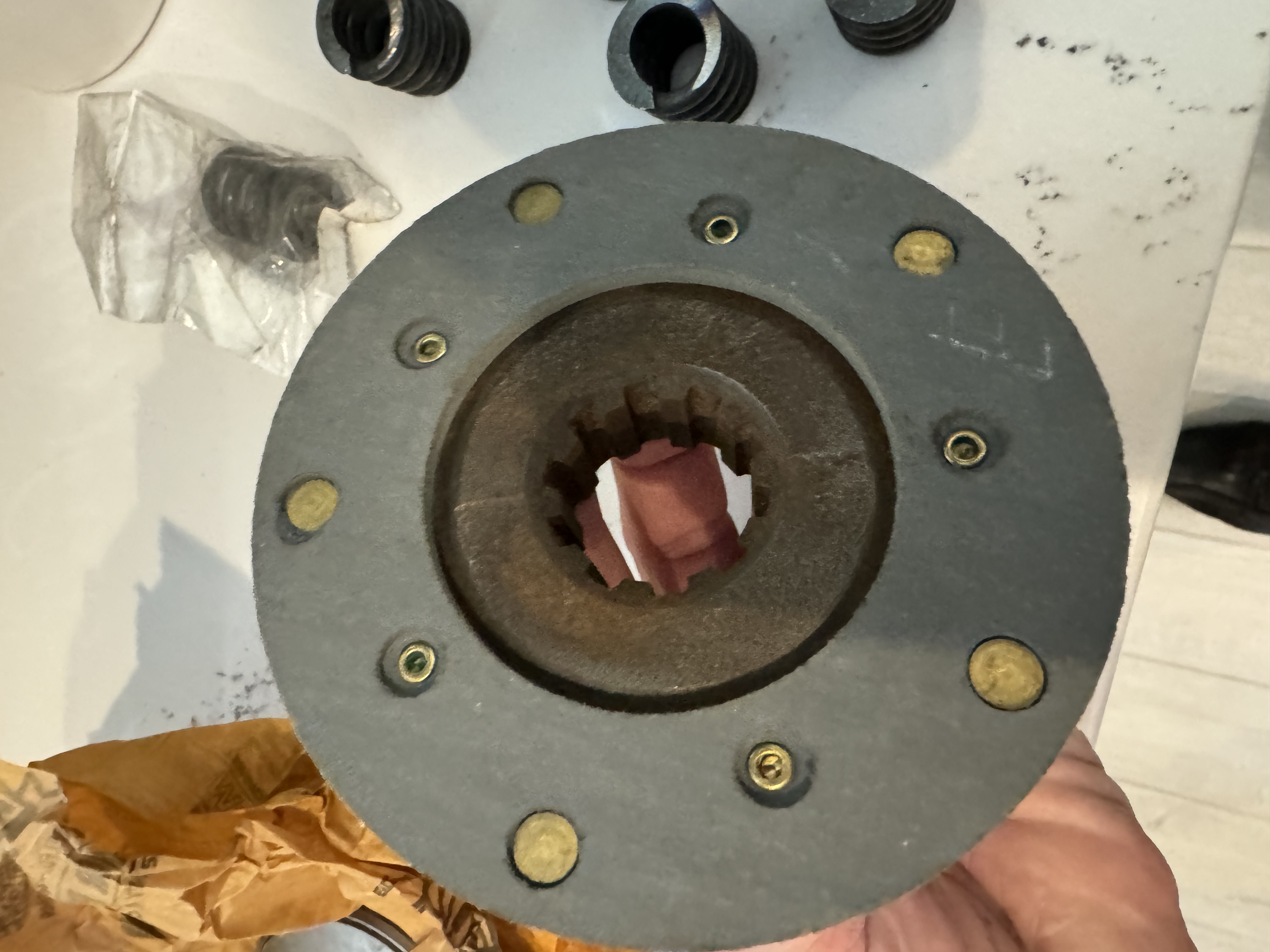

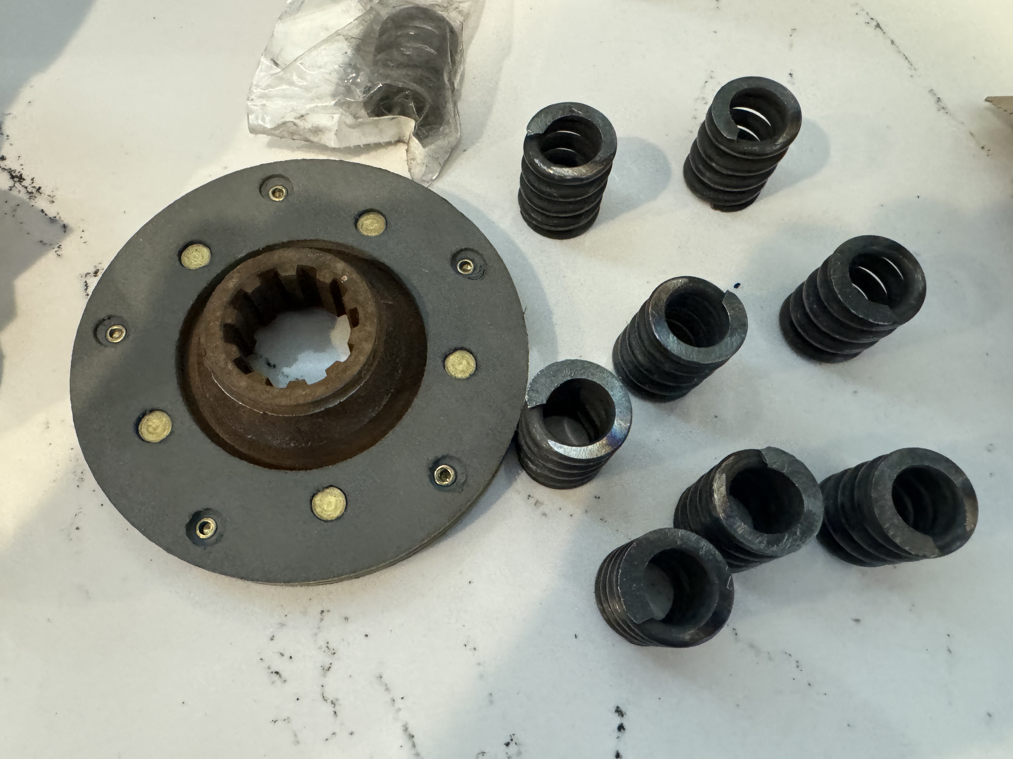

Just received the rebuilt clutch plate, springs and throwout bearing for the final drive from Sandy Lake Implement. They look awesome. Now to find the time/weekend to get the work done.
