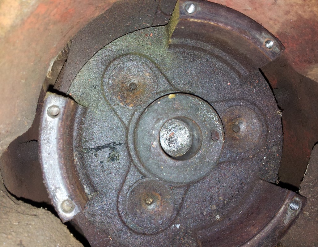

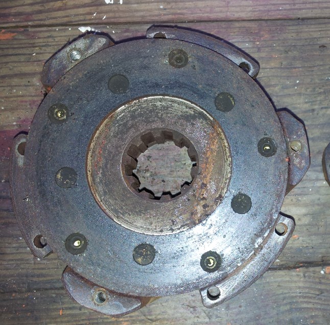

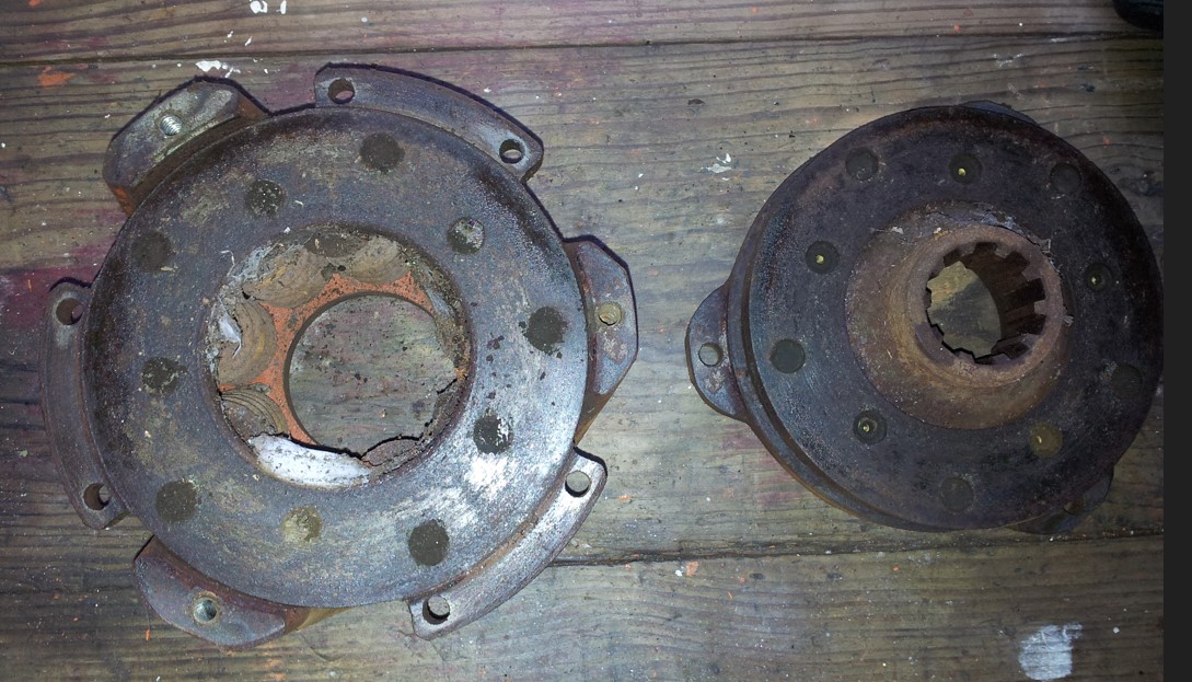

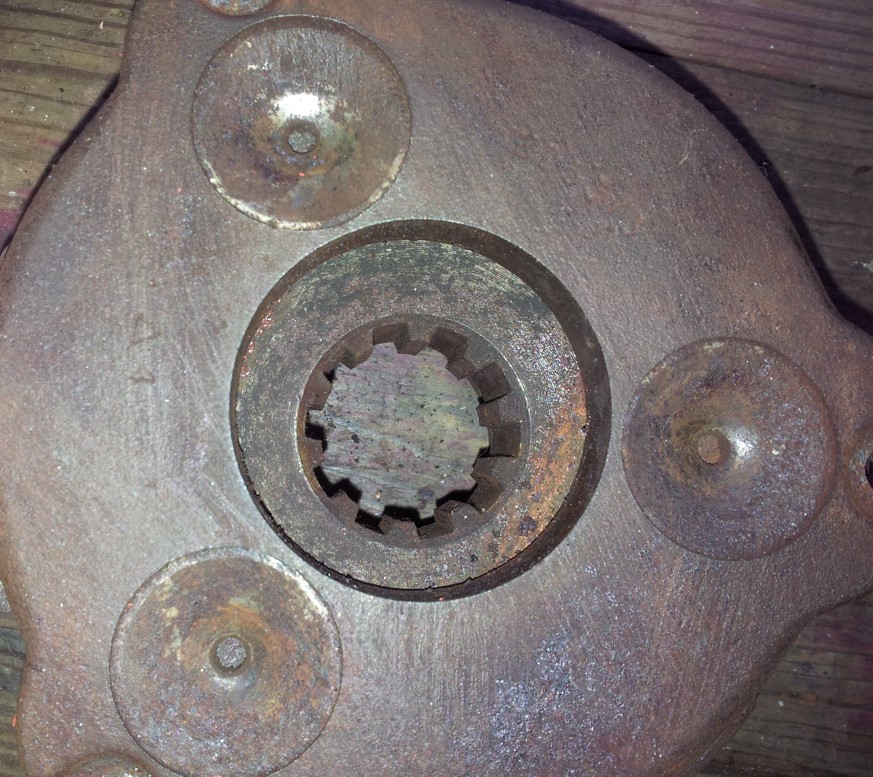

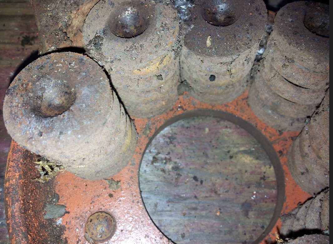

I have a similar problem with my ED40 hand clutch. It slipe from timr to time.
Very rusted. But the disk seem
The disc seems to be reusable after a good cleaning and if possible to remove the shiny aspect, may be by brushing or an other trick , and wearing a mask.
I will replace the springs and the balls, I would also like to replace the balls seats. But impossible to find the ball seats in spare parts. An idea where to find one?
