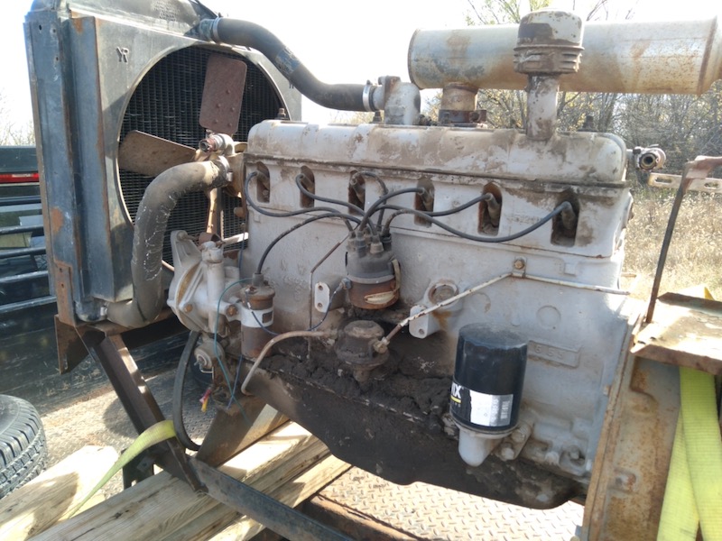

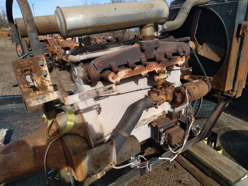

Got the engine home. It seems to turn over by hand fine, and that Wix oil filter isn't too old. I'm guessing this was running 10 years ago, maybe? Manifold is clearly shot but you can still buy those new. I need to bolt the hood and air cleaner back on now that I have it picked out of the combine. Hopefully I won't need it for my CII anytime soon, so maybe it will wind up in one of my D-19s.

Post Options Post Options   Thanks (0) Thanks(0)   Quote DrAllis Quote  Post ReplyReply Direct Link To This Post Posted: 23 Nov 2024 at 10:25am
That's a later one with the 190XT sized Zenith carburetor on it.

Post Options Post Options   Thanks (0) Thanks(0)   Quote wjohn Quote  Post ReplyReply Direct Link To This Post Posted: 23 Nov 2024 at 1:35pm
I know people always talk about how much fuel the D-19 gassers went through, but I'd have to assume it would be even more with this later combine configuration. One of my D-19s needs a complete rebuild and has a patch on the side of the block, so it seems like a good candidate with the necessary tractor parts swapped onto this engine.
