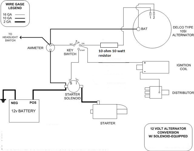

Post Options Post Options   Thanks (0) Thanks(0)   Quote JCC Quote  Post ReplyReply Direct Link To This Post Posted: 11 Apr 2021 at 9:11am
Can someone show me a diagram of the wiring for the solenoid?

Post Options Post Options   Thanks (0) Thanks(0)   Quote Jim.ME Quote  Post ReplyReply Direct Link To This Post Posted: 11 Apr 2021 at 12:55pm
Here is the wiring diagram for the original D14 6 volt positive system from a D14 Operator's manual, which includes the solenoid and wiring.

Post Options Post Options   Thanks (0) Thanks(0)   Quote JCC Quote  Post ReplyReply Direct Link To This Post Posted: 11 Apr 2021 at 4:34pm
It is a D14, and has been converted to an alternator.  It has both a kill switch and a key ignition.

Post Options Post Options   Thanks (0) Thanks(0)   Quote Jim.ME Quote  Post ReplyReply Direct Link To This Post Posted: 11 Apr 2021 at 7:03pm
A D14 originally had a key switch and a push button for the starter.
Kill switches I'm familiar with are generally used with a magneto, they ground the magneto out to stop the engine, D14s didn't have magnetos. A D14 should have just a key switch to shut the power off to the distributor.
I wonder if your kill switch was installed as part of the conversion to the alternator. Depending on the alternator, and how it was wired, it can back feed the ignition which will prevent stopping the engine with the key switch. A switch in the excitation wire can be used to break that circuit and allow the engine to stop. Can you tell where the wires on that switch go? Will it run but not charge if you don't turn that switch on?
Does your key switch normally operate the starter solenoid or does it have the push button for the solenoid?
Given yours has been converted to an alternator there is no official drawing since it is not OEM. Conversions are similar but different due to different alternator and components used, as well as the person doing it, so it may take a bit to sort things out.

Post Options Post Options   Thanks (0) Thanks(0)   Quote JCC Quote  Post ReplyReply Direct Link To This Post Posted: 12 Apr 2021 at 1:41pm
The key switch operates the solenoid.  The tractor won't run or start when the kill switch is off.

Post Options Post Options   Thanks (0) Thanks(0)   Quote JCC Quote  Post ReplyReply Direct Link To This Post Posted: 12 Apr 2021 at 3:18pm
I'll go out and see if I can track where the kill switch wires go, then get back with you.  It will be later.

Post Options Post Options   Thanks (0) Thanks(0)   Quote steve(ill) Quote  Post ReplyReply Direct Link To This Post Posted: 12 Apr 2021 at 3:23pm
kill switch should be on the hot wire going to the coil.

Post Options Post Options   Thanks (0) Thanks(0)   Quote Jim.ME Quote  Post ReplyReply Direct Link To This Post Posted: 12 Apr 2021 at 4:03pm
Unless it is a battery power kill switch.
Points: 88482
Post Options Post Options   Thanks (0) Thanks(0)   Quote steve(ill) Quote  Post ReplyReply Direct Link To This Post Posted: 12 Apr 2021 at 5:28pm
If the alternator is connected to the coil with a hard wire and no resistor or diode in the line, the tractor might continue to run after the key is off.... I assume thats why they added the switch ?
Jim.ME View Drop Down
Joined: 19 Nov 2016
Location: Maine
Points: 963
Post Options Post Options   Thanks (0) Thanks(0)   Quote Jim.ME Quote  Post ReplyReply Direct Link To This Post Posted: 12 Apr 2021 at 7:14pm
That is why I was asking where the wires from it go. It could be wired in several ways for a few different reasons.
