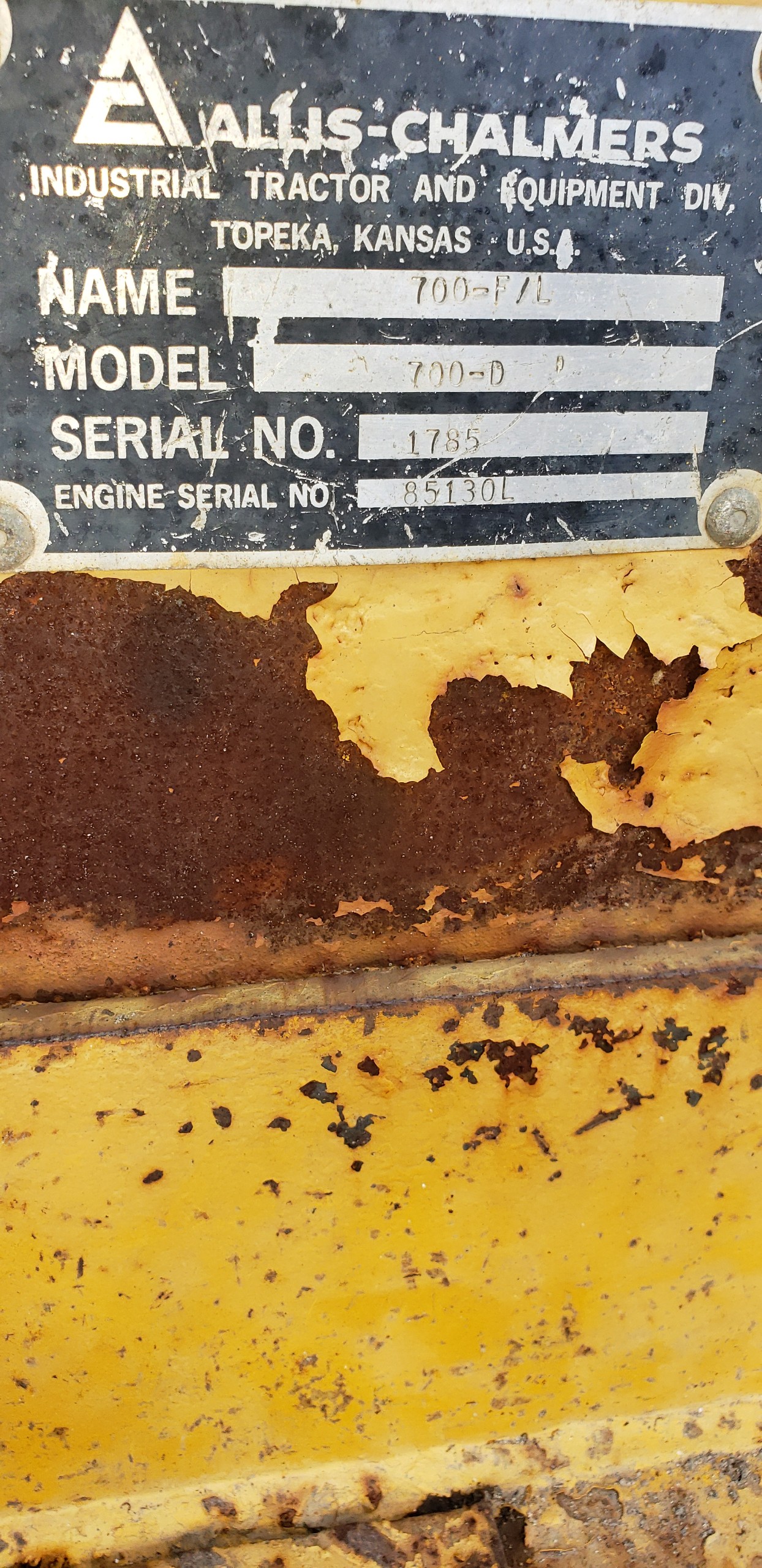

I have a customer who owns an Allis Chalmers 700-D Rough Terrain Forklift. It has the engine serial no of 85130L. I need to know Engine Make, Engine Model, and Horsepower. Any help is greatly appreciated.

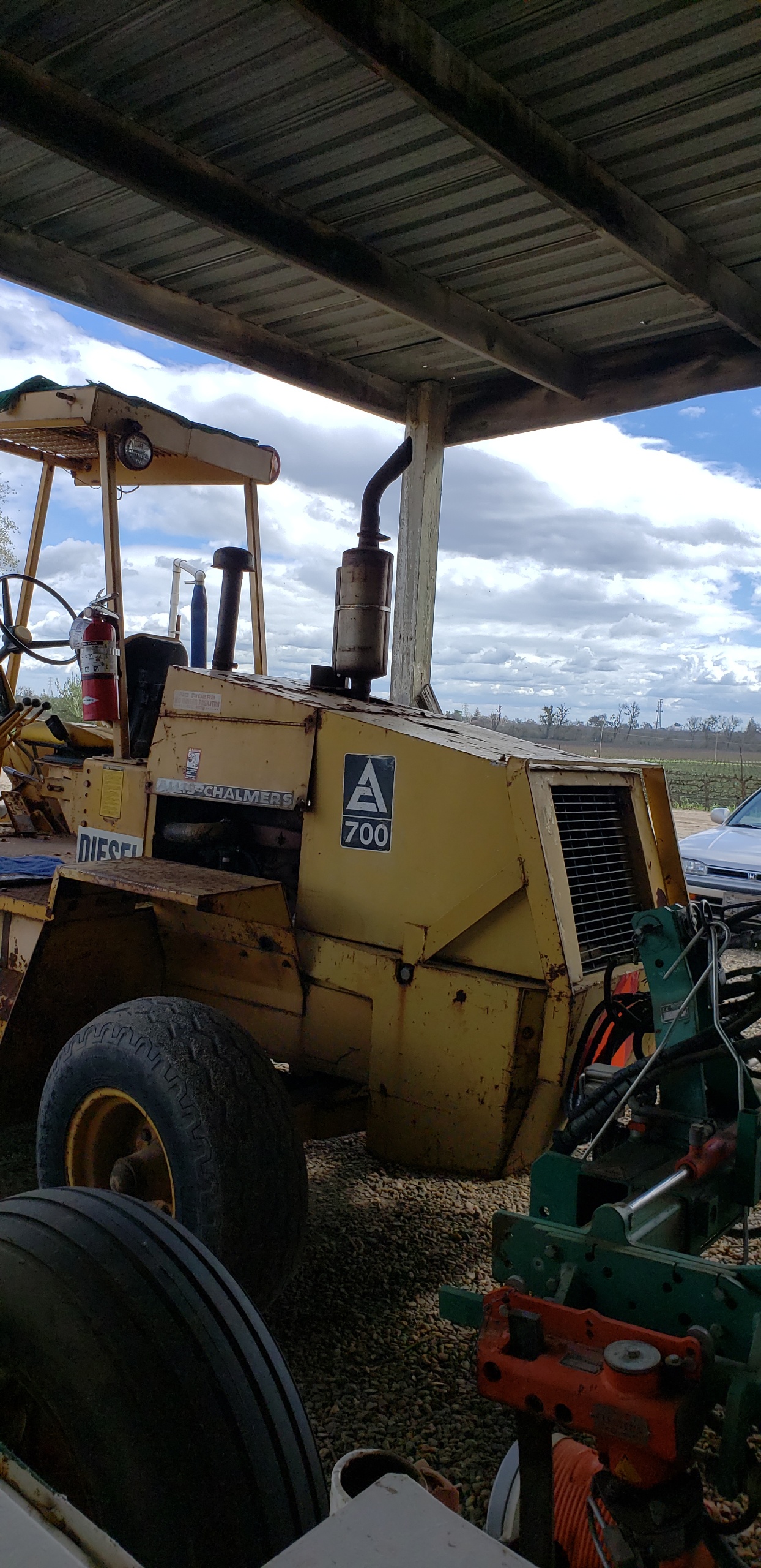

Post Options Post Options   Thanks (0) Thanks(0)   Quote tkelley Quote  Post ReplyReply Direct Link To This Post Posted: 06 Mar 2020 at 11:08am
those are two of the pictures i was sent by the customer. none of the actual engine. I can go get some but it wont be til next week.
Points: 22136
Post Options Post Options   Thanks (0) Thanks(0)   Quote DrAllis Quote  Post ReplyReply Direct Link To This Post Posted: 06 Mar 2020 at 11:13am
That should be a Perkins engine. That isn't the newest (and last) "D"-series that were turbo diesel only. It's an older version and is a "D" designation because it's a diesel not a gas engine.
