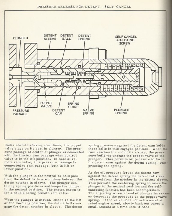

Post Options Post Options   Thanks (0) Thanks(0)   Quote Tom_C Quote  Post ReplyReply Direct Link To This Post Posted: 10 Aug 2017 at 6:48pm
Ok, the anemic lift is sorted. There is a screw on the end of the 3 point spool . I turned it in and now I have tons of lift. Also the position lever for depth seems to be working okay. The only thing I wonder about now is there doesn't seem to be much downforce. I can grab the arms and lift them by hand though with some effort. How solid should the arms be when in working position?

If it sinks in center position, Then there is something wrong...
 and being you had to screw the pressure detent in, something or some one messed with it I would bet.
 Remember that there is the lift position, a hold position, a float/traction booster position and a lower position...  And when you press it down to lower, you have to pull up to the first detent to the hold position.

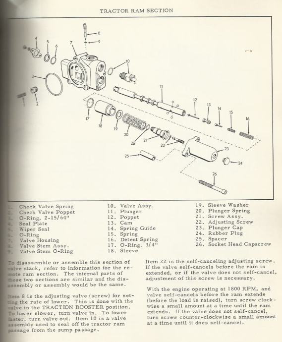

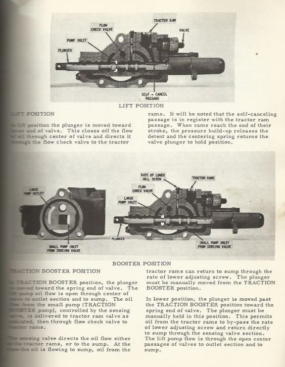

Just some pics to look at...

Thanks for posting the photos. Before I open the control I would like to check the linkages for the traction boost. Does anyone have information on setting and adjusting those?

Post Options Post Options   Thanks (0) Thanks(0)   Quote JC-WI Quote  Post ReplyReply Direct Link To This Post Posted: 11 Aug 2017 at 10:23pm
Think you should First check to see if your 3pt lift lever is detenting in the hold position.
Lift
hold
traction booster
lower
Usually if something is wrong in the TB section, it will be the linkage is stuck/froze/rusted, not the spool.
