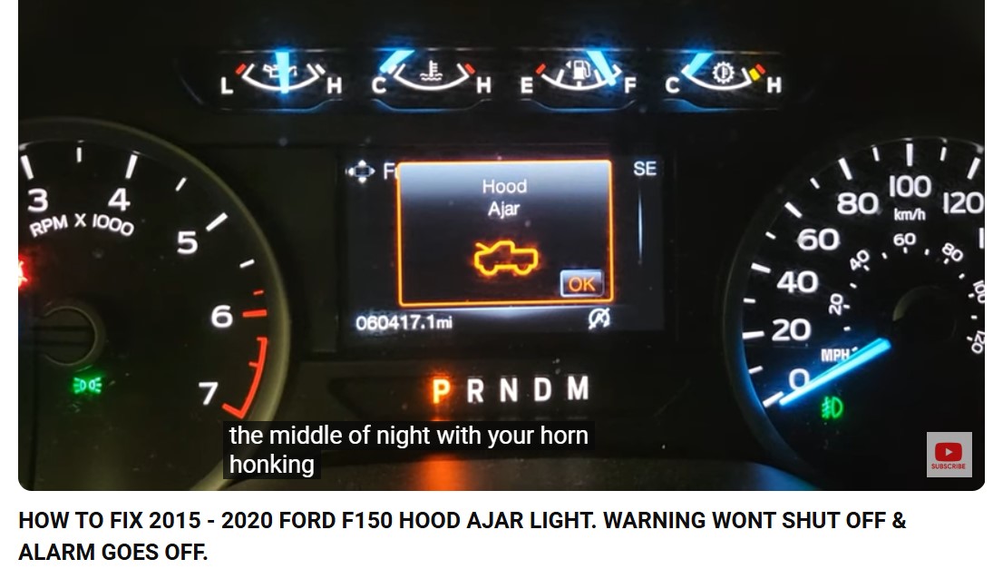

Well guys, I got er fixed!!
The batteries in the fob were good and as per Gary, I tried the 2nd fob and that too was no go.  So,,,,,,,,,,checking the fuses etal,,,,,,,,, I figured that if the lights flashed and the horn honked, that it wasn't the batteries in the fob or the 12v.
Did some checking on Youtube and there was some stuff about the pressure switch under the hood.  I went to look for that and there wasn't one!!  BUT,,,,,,slamming the hood shut,,,,it WORKED!!
Ergo, there has to be a switch there somewhere, but I couldn't find one.  At least there is nothing visible....
So,,,,,,,,THANKS guys!!  That did it.

switch may be under the hood LATCH at the front.. Look for a harness with a couple wires... You should get an LIGHT/ ALARM if it was not working........... but glad it is fixed !

dont need a code reader.. should get an idiot light on the dash if the hood is open or switch not working.. just like leaving the door open , or tail gate, or check engine light..

If the light did not come on... then possibly something else prior to SLAMMING the hood... Yes, leave the hood open and try the remote start.. Also see that you get a LIGHT when you turn the key ON..
Points: 18923
Post Options Post Options   Thanks (0) Thanks(0)   Quote Ted J Quote  Post ReplyReply Direct Link To This Post Posted: 16 Mar 2025 at 12:44am
There was no light on the gauges at all.  I tried just pushing the start button without the brake being pressed, and no lights.  Started and no lights.  Opened the hood and it wouldn't start.  I shut it like I always did and it wouldn't start.  Kind of slammed it shut and it works.  It was dark out, so I'll look later in the light to see if I can find the switch.

Ford is a little freakish as they like to put switches at the latches as well as contact points.
