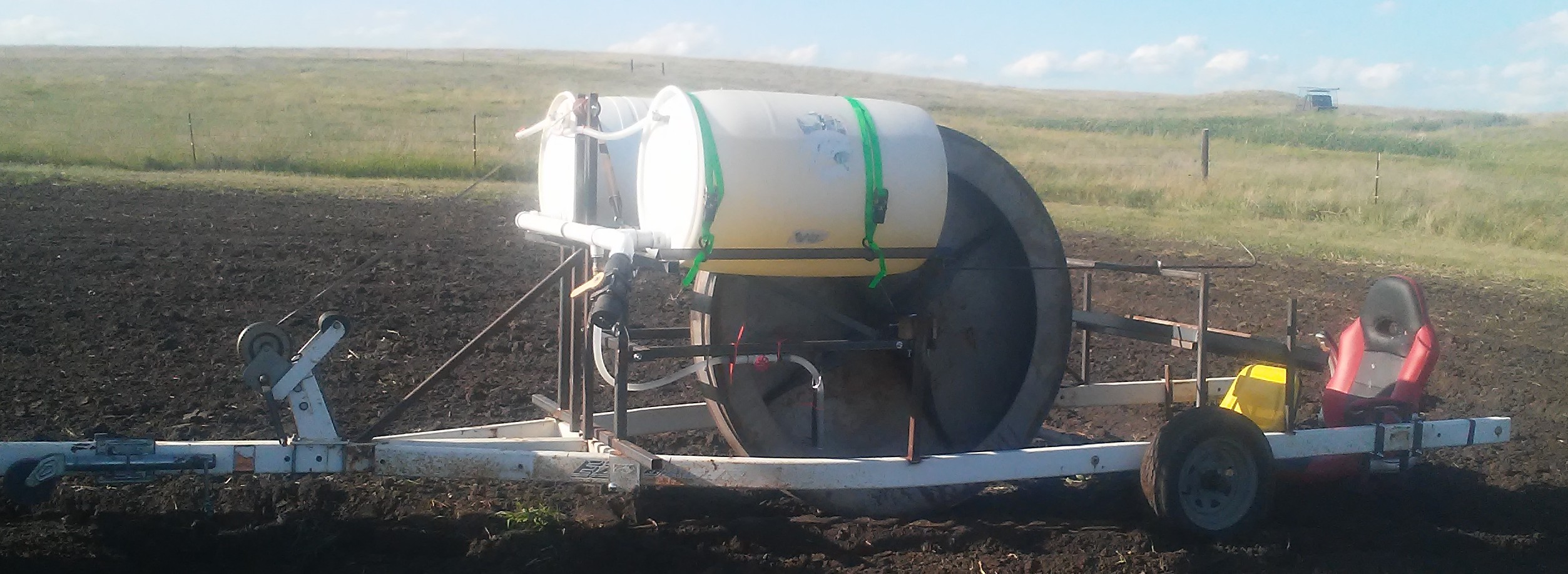

Maybe this will help some of you understand what my goal is. This is my waterwheel transplanter. There is one 6" spike on the big wheel in the middle. That wheel is 5' in diameter. It pokes a hole every 15'. There is no down pressure on the wheel. Water runs out of the wheel, into the spike and fills the hole with water. The rider on the back then places a 3" dia x 4" tall peat pot with a pumpkin plant into the hole. As the water soaks in, dirt settles in and covers the pot.
When weather permits, I plant rye in the fall. I use it for weed control and as a plow down fertilizer. As a plow down, I let it grow to 6-8" then dig it in. Even as a plow down, have had good luck with weed control. Was having an issue with field bindweed. The rye has eliminated about 90% of it without chemicals. I broadcast it at a rate of approximately 5bu/ac, then likely drag it.
I want a chisel plow or field cultivator to run ahead of the disk as a vertical tillage to loosen the soil, so it won't require as many passes with the disk.
And yes, before somebody brings it up. A tiller would achieve my goals with one pass. But, my goal is to hopefully in the future expand to become a commercial grower within the next 10 years. Imagine trying to run a tiller across 40 acres.

Well, I’ll be honest, I’m not sure what you need to do. Actually I think a tiller would be a terrible choice. It would seem great for a year or two, but likely after that compaction would be a problem. But I don’t have knowledge of how your soil responds.
You say vertical tillage, but nothing you mention as on option is vertical tillage in my understanding of the matter. I’m not attacking you or trying to be a jerk, just saying what I think to be the case.
Since you plow this down over and over, perhaps a field cultivator would work, although I have a hunch you’re going to be fighting compaction soon if not already.
Of all the things mentioned, to me I think a chisel plow sounds like the best option. Or a subsoiler every so often used with what you’re doing to fight compaction.
Whatever you choose, good luck I’d be curious to know what works best and why.

Spike wouldn't penetrate deep enough to set the plant. We use 3" dia x 4" tall peat pots. The taller peat pots help prevent the plants from getting root bound. The hole needs to be around 6" deep, so that when the water soaks in the soil silts back in and covers the pot. Otherwise if any of the pot is exposed it will wick the moisture away from the plant and dry it out.
There is no down pressure on the wheel. Full of water, the wheel only weighs 150-200#. So imagine strapping a 4" x 4" x 6" tall spike to the bottom of your foot and walking across your lawn, and try to get it to go deep enough.
