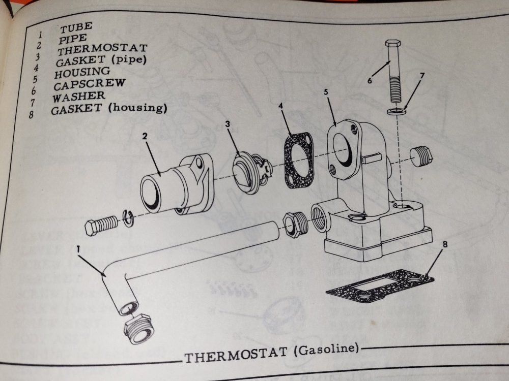

Post Options Post Options   Thanks (0) Thanks(0)   Quote PoppaBear Quote  Post ReplyReply Direct Link To This Post Posted: 4 hours 18 minutes ago at 10:41am
UPDATE: Need to source a Water Tube, bypass for thermostat.
Doe's anyone have a source for this part?  1963 D-19 Gasoline Engine.
This tube is hard metal, with compression fittings on both ends.
Is it shown on page 67, of the D-19 Operators Manual, as Item #1 (shown in photo below).
Have a new Radiator, and rebuilt Water Pump ready to install.
