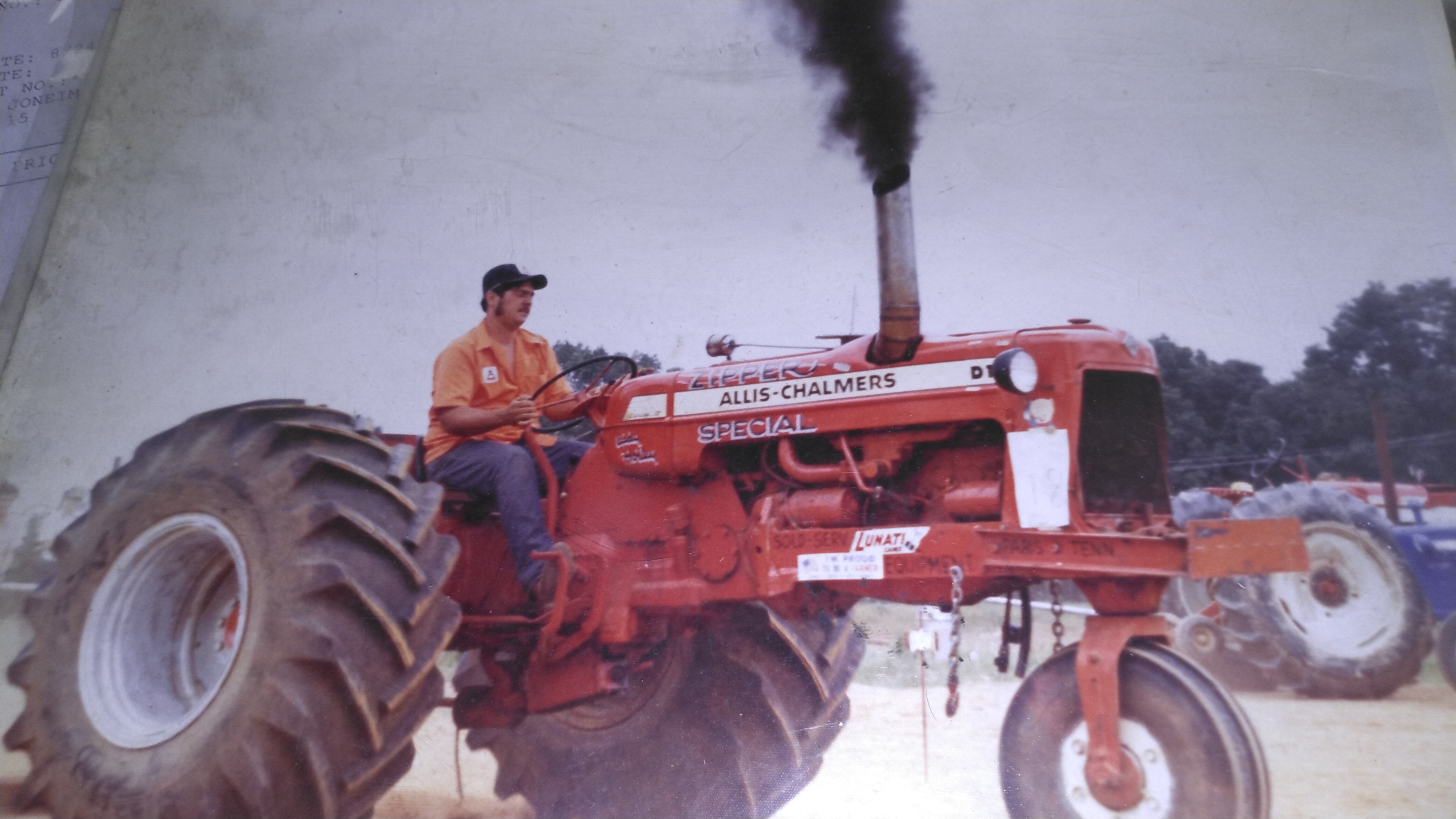

Circa 1972.........  D262 copper head gasket  - oring 'd sleeves   35 mm 4 roller pump
Switzer then staged  turbos -  lots of smoke  7th gear in 5000# 6th gear in 7000
HP ? maybe 200 ? 250 ?  Never burnt piston - indirect injection.   More fuel never increased hp  when we went from 4 roller 31 mm  (220 Pump size)  ...  Zipper Special was named so with reason....  Oh, and used D19  PD clutch to start...  in 5 years replaced final drive, trans, torque hsg gears, crank cam... and on and on  but it was fun...

Now we're talkin !!!   Look at the lug depth on those tires !!!   That is one of the reasons todays pullers don't have much (if any) rear end issues. The sleds start easier and the tires have a much shorter lug so you can spin them faster, making the driveline last longer. I like the " more fuel never increased the HP" line...………   They say todays very best Super Stock 3 or 4 turbo diesels make between 3500 and 4000 HP at 270 to 300 psi of boost.

   Was the hand clutch power director stock???

Yes. Used the slotted plates for low and the solid  center for high. We bent the metal on the tie bars that dip in the oil so as to sling oil into the plates.. must have helped. Keep in mind, we had nowhere near the hp tractors are making today .  Once Eddie was driving at Union City Tn when the manifold turned red, the exhaust we had enlarged to take a bigger turbo let the bolts pop and the turbo blew the hood off   and the sled ran over it all. The hood was as flat as a pancake, and well meaning people were handing him hot parts as they pulled him off the track.. He was covered with black oil.
