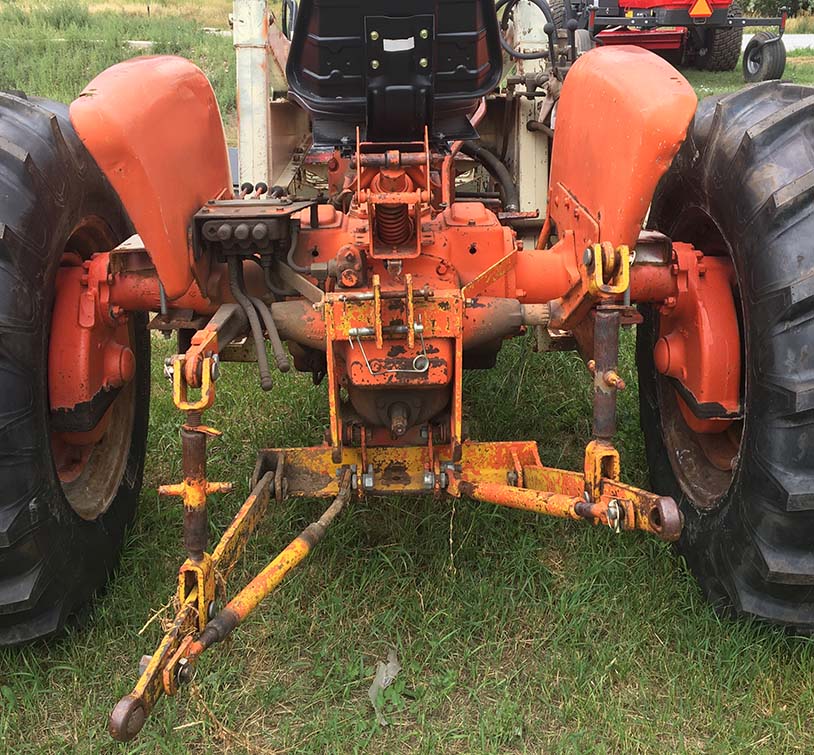

I am looking at buying an early D 17, I notice when looking at it that one lift arm was what looks to be all the way up, however the other lift arm was all the way down.  How are these constructed so that in operation both come up equally ?
I saw in another post that the lift arm shaft is not connected on the inside.  Are there two cylinders inside to lift the arms individually with the pressure line T’d to both?

The lift arms are splined each to their own (left and right) lift shaft.  Each lift shaft fit into the lift cylinder crank, which is inside the lift arm housing. All the splines are in "time". There is only one lift cylinder. The lift shafts fit into the lift cylinder crank and have a hole drilled in them for a roll pin to retain them and they are in "time". Either you have a twisted lift shaft, or someone has one of the external lift arms placed out of time on its lift shaft. No way to get them out of time on the inside and still install the retaining roll pin.

what the Doc says
However, I don't quite get how one could be all the way up and the other all the way down.
How could there be much rotational travel available?
Someone may have purposely changed the orientation from side-to-side, but why?

Thank you for that explanation.  I think I can visualize that pretty easily.  I also read somewhere, that getting the lift arms off on the older models is not really possible without the whole housing coming off and presses.
Deepens the mystery.
How do I post pictures?
The lift arms are attached to a third party three point setup and those links make it look even more lopsided.

I don’t know either unless something is broke inside.  I have heard the arms are difficult to remove, and reinstall without a press.  So reindexing doesn’t sound likely.
I have not seen the tractor in operation yet.  Don’t want to buy something that takes heavy lifting repair right out of the chute.

Getting an old one off isn't bad if you simply use a cutting disc and make a couple of cuts to release the shrink fit and then maybe some torch heat and a big hammer. A salvage yard should be able to sell you one already removed or one still attached to a lift shaft and then you place it in a press and use lots of pressure and some heat (not red !!!) to get it to release.  Reheat to install on your tractors lift shaft in chassis.

Were they all shrink fit, Doc?
I seem to recall some that just barely slid off with a little help and of course removing the paint.
Once the large snap-ring is removed, you could try using a BFH to persuade the arm to move out and off.
Doug, did you ask the seller why the arms are not aligned?  If he doesn't know, it would be anyone's guess as to which one is correct if you don't have another D17 to check the angle in the up position.

Probably not a shrink fit when new. A light press fit I'd imagine, BUT after 60 or 70 years of rust...………..

I have saw shaft twist off on WD, but never on D17. Looks like someone got one off some how and put back on out of time.                    MACK

If the lift arms are now in the UP position, the one on the left isn't in full-down position yet, but will get there long before the right one, which appears to be about full up.
Maybe the PO for some reason wanted the lift arm kept at a greater distance (than necessary) so as not chance hitting the valve stack.
IDK; weird setup
Hard to tell without a real close look just how many spline count they differ.
I wouldn't worry too much about that.
You can use that as a bargaining chip, as in "what the heck am I supposed to mount on that ??"
Then remedy the situation if you buy it.

Left needs to go down 3 to 4 inches more for fully down. Right needs to go up 4 to 6 inches more for full up.

Left has no paint- sign of being torched off and re-installed?

That hydraulic valve stack is AC factory option, so the left lift arm, when fully raised will come close to it, but not hit it.

If it was my tractor, I, personally, would look for a used housing with rockshaft and lift arms and just change it out. I can't imagine there is much demand for them and that they would be very expensive.

This is off topic, but that tractor has added on hydraulic valves on the left of the seat. That's cool and likely pretty rare. I'd like to have that valve!

The burnt look on the left lift arm is more than likely oil from the hyd. valve.
That's factory or dealer installed optional valve. The operators manual for the Series III show it.

Disclaimer: I don't know much about D-17s, and the hoses are somewhat in the way. Is that left side lift arm on upside down or am I just seeing things?

My Series III manual shows it too, but this is the first time I've seen an actual picture of one.

Right side is out too far. I think some one had it apart, put one side back in one spline off without role pin.               MACK
