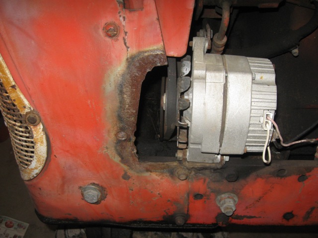

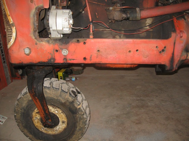

This was my series III when I bought it. All it took was a cutting torch, a welder, an alternator, what I think was a bracket for a fog light, some wire and electrical tape and not caring what it looked like when you're done.
Now it has been patched up and a generator is back on it.

Good you hear you put it back to original Dave!  I don't see the need for an alternator.  Generators have served these tractors very well for the past 50 years!

Dave, is that a forklift tire on the front of your D17?
I don't know, it was on it when I got it. But it sure looks like it.

Post Options Post Options   Thanks (0) Thanks(0)   Quote KY poorboy Quote  Post ReplyReply Direct Link To This Post Posted: 15 Mar 2016 at 11:51pm
Yes it does. If it is, I bet it's a tough dude. LOL.
