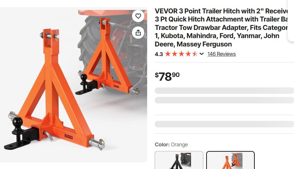

Post Options Post Options   Thanks (0) Thanks(0)   Quote steve(ill) Quote  Post ReplyReply Direct Link To This Post Posted: 16 hours 42 minutes ago at 9:53am
Points: 23649
Post Options Post Options   Thanks (0) Thanks(0)   Quote DrAllis Quote  Post ReplyReply Direct Link To This Post Posted: 15 hours 52 minutes ago at 10:43am
One thing to keep in mind when hooking to a 2-wheel trailer is this:  any of those 3-point hitches only support down pressure on the ball. If you load your 2-wheel trailer heavy to the rear, causing upward movement of the tongue, the hitch will probably go up as well !!  This might cause a safety issue and it may not. I think the little "N"-series Fords had a couple of flat iron straps to secure the hitch so it could not raise up on its own in a situation like that.,

Post Options Post Options   Thanks (0) Thanks(0)   Quote Gary Burnett Quote  Post ReplyReply Direct Link To This Post Posted: 14 hours 42 minutes ago at 11:53am
One thing to keep in mind when hooking to a 2-wheel trailer is this:  any of those 3-point hitches only support down pressure on the ball. If you load your 2-wheel trailer heavy to the rear, causing upward movement of the tongue, the hitch will probably go up as well !!  This might cause a safety issue and it may not. I think the little "N"-series Fords had a coupler of flat iron straps to secure the hitch so it could not raise up on its own in a situation like that.,
All very true and also can happen with anything hooked to the hitch while going down a hill.Poster just needs to find an original drawbar
