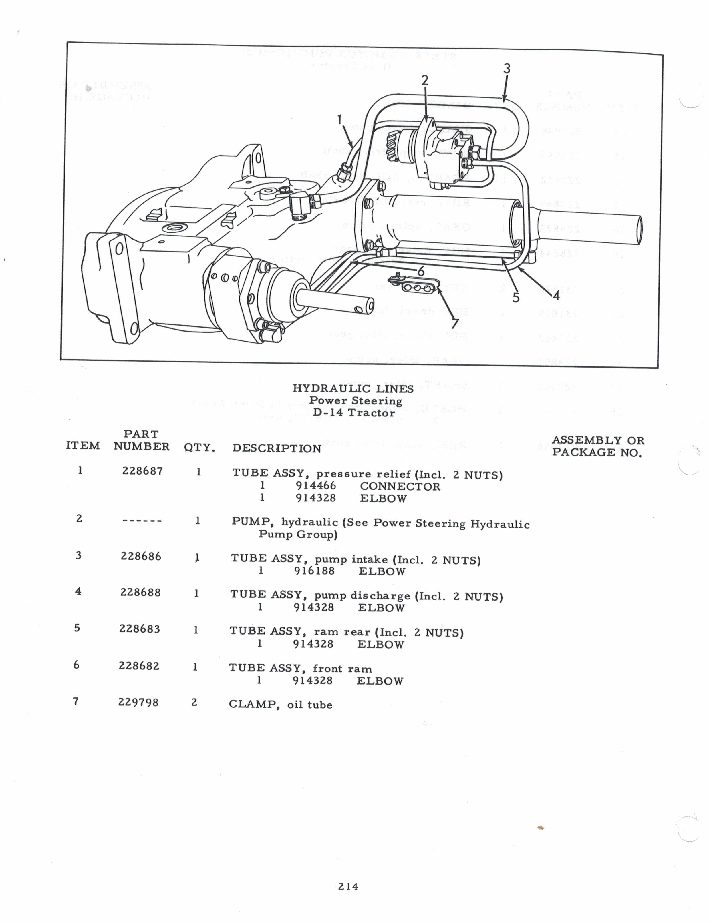

 I am in the process of getting ready to doing some testing on the power steering system suggested by Dr. Allis to figure out what the issue might be with the ON again/ Off again status of the  power steering. I have removed the tubing line from discharge off the pump going to the Ram (cylinder?) to test the pump discharge pressure first
 I sorely need a copy of drawing for this system as I have (temporarily) misplaced the D14 book that I had once  upon a time,,,,, Chit,,I've spent more time this morning looking for that DANG book and I NEED SOME HELP,,,,!!!
  Anybody got a copy,,,??? Many Thank You's in advance,,,,,

Post Options Post Options   Thanks (0) Thanks(0)   Quote jaybmiller Quote  Post ReplyReply Direct Link To This Post Posted: 27 Feb 2022 at 3:59pm
Points: 22860
Post Options Post Options   Thanks (0) Thanks(0)   Quote DrAllis Quote  Post ReplyReply Direct Link To This Post Posted: 27 Feb 2022 at 4:49pm
Line #4 is the pressure/feed line.

Post Options Post Options   Thanks (0) Thanks(0)   Quote jaybmiller Quote  Post ReplyReply Direct Link To This Post Posted: 27 Feb 2022 at 7:07pm
I can also post the 'parts inside pages if need be...
 Dr. Allis,,I finally had to remove the whole pressure/feed line as I could not move it over enough to screw in my test line with the 2000 pressure gauge,,,talk about close confines and with my big old hands,,,, made it even a tighter fit,,,,
 I didn't have much luck in The Alien Town today finding the inverted flair fittings I need to make a line that will screw into the pump, with a short length of tubing and a connection to go to the 1/8" NPT on the back of the pressure gauge. I may wind up using the factory pressure line as I can turn it around and then locate a fitting the will adapt from the 3/8" male flair fitting to the 1/8" NPT gauge,,,,clear as mud,,,,,?? Chit, I ain't sure my own self,,,,,LOL

 Hey Jay,,Many Thanks  for your help,,,,That print is exactly what I needed,,,I dislike not knowing what the different parts are called and The routing of the oil kinda tells you what may be happening inside all them different pieces. I DO remember having a heck of a time setting the clearances on the Dang Ram Rack,,,,I had to do it over and over many times til it was according to the specs,,,, ain't looking forward to that chit again,,,,Wink

 I fired the tractor up and the gauge shot to 600# and would ease up to 650# and back to 600# Shut engine off, and let set a few then started up again,,,still just 600#. I checked the reservoir level and it had gone down about 1" from yesterday PM,,,!!!! What the heck is going on??? where did all the oil in PS reservoir go,,,?? I re-fill reservoir, and recheck pump pressure and still just 600#,,, Just for kicks,,I check oil level in engine and,,,,and,,,I find a whole lot of hydraulic oil in engine all the way up on dipstick,,,!!!! I use a 5 gallon pail and drain oil from oil pan and there is a little OVER 4 GALLONS in engine,,!!  Question now is how is it getting into the engine oil pan,,,?? Only'ist way I can figure is thru the power steering pump, thru governor area and then into the front cover and into oil pan,,,????
 When I was rebuilding the tractor,,,all those years ago,,,seems like I remember installing a new "seal" on the PS shaft that was very expensive,,,How else would the PS oil be getting into the engine oil pan,,,?????
 I think I'm now gonna be needing to look at the internals of the PS pump,,?
 I did look into DSeries4 suggestion on removing the side frame rail for better access and with the Front loader,,,,that right there is gonna be a BFJ in itself,,,,,
 JEEEEZE,,,,!!!!!Anyone got a magic wand,,,,,

Joe, i would not think the steering system held 4 gallons of oil ?  Seems like there must be more to the story ?  So if you have 600 psi, then does it steer ?  Where did the pressure go when it dont steer ?
Points: 22860
Post Options Post Options   Thanks (0) Thanks(0)   Quote DrAllis Quote  Post ReplyReply Direct Link To This Post Posted: 28 Feb 2022 at 8:09pm
Only 600 lbs with a dead-headed gauge ?? Pump has internal problems and is blowing oil thru the shaft seal into the engine. A good pump at half-throttle or more should make 1600 psi.

  Well,,, I thought I posted on another thread that this "NO POWER Steering issue had been OFF and ON  for some time and the loss of oil in the PS reservior,,,I blamed it on a slow leak as I had noticed a small fluid leak for some time,,,,
 I did drive the tractor after I got it all back together and did have "some" PS but was some hard to steer . There may also be an issue with the relief valve opening back to the reservoir as I did notice the reservoir  overflowed while I was driving it this PM,,,,?

 Hey Dr Allis,,,,. That was kinda  what I was  thinking,,but was SURE hoping it was something else,,,,, That would explain the high fluid level in engine,,huh,,?
