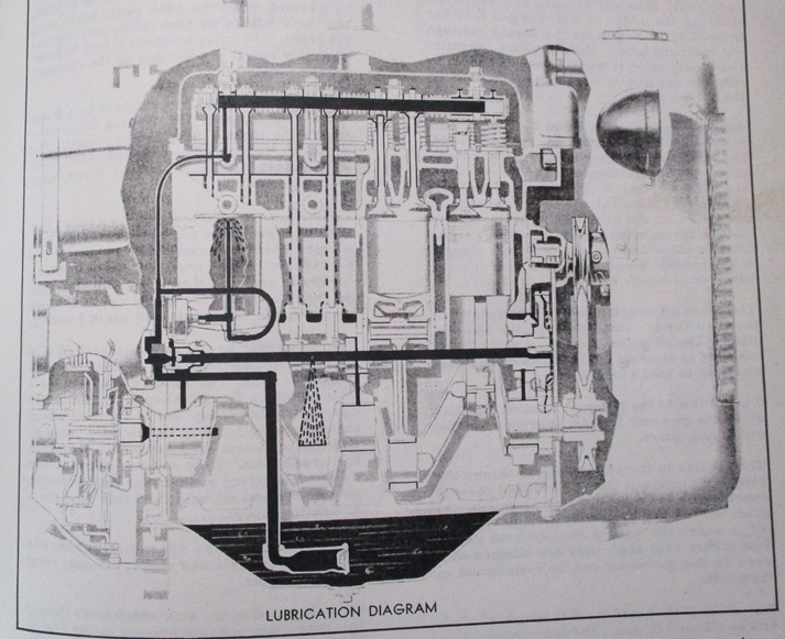

I couldn't find any info on the D14 but I found a manual for the H3 which I believe is the same engine.
Hope this helps

Post Options Post Options   Thanks (0) Thanks(0)   Quote Wes(Va) Quote  Post ReplyReply Direct Link To This Post Posted: 4 hours 3 minutes ago at 11:14am
No ball in this block.  Thanks Les for the diagram.  Thanks everybody else for your help and those that called.  I don't feel lucky, I now feel informed!

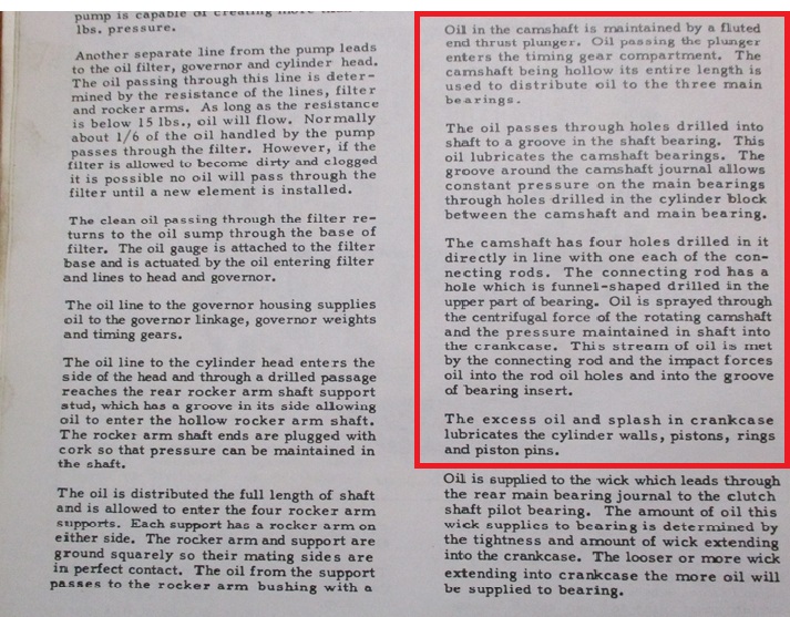

Post Options Post Options   Thanks (0) Thanks(0)   Quote steve(ill) Quote  Post ReplyReply Direct Link To This Post Posted: 2 hours 25 minutes ago at 12:52pm
Just to add a little info.. this is from the Original Allis B-C manual
The BYPASS system still has a pressure feed crank shaft main bearings.. The Crank is NOT DRILLED to feed the connecting rods..The hollow cam shaft is full of oil and there are holes in it pointed at the connecting rods that SPRAY oil on to the connecting rod bearings on the crank and wrist pin..
Points: 89985
Post Options Post Options   Thanks (0) Thanks(0)   Quote steve(ill) Quote  Post ReplyReply Direct Link To This Post Posted: 2 hours 22 minutes ago at 12:55pm
so.......... the CAM on a BYPASS system should have SPRAY HOLES... and the CRANK on a PRESSURE system should have drilled holes to the conecting rods  ?????????
