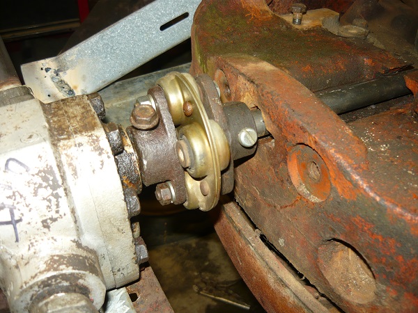

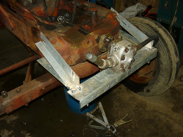

you can buy a hub and shaft and mount a pump on the front to run off the crankshaft pulley, then you would only need the other pump when using your 3pt.  that's what I did when I had my d14.  I simply made a bracket to mount the pump on with some angle I had laying around.
