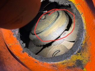

I pulled the inspection cover and looks like the TO bearing is shot. Lots of slop in it and what appears to be fine metal shavings around the bearing. The adjustment is fully extended. It looks like a 1/4” (or more) between TO bearing and fingers on pressure plate. I’ll try to post a couple pictures.
Thanks again.

So, the whole story is.......it didn't used to be like this and the clutch pedal positioning has CHANGED. Normal clutch wear and tear always keep moving the clutch pedal to the rear. NOT the way yours was.

Throwout bearing is likely shot because there wasn't any freeplay in the clutch pedal linkage, causing it to spin all the time. Or maybe it hasn't been greased in 30 years ?  Clutch disc is likely worn thin which moves the fingertips closer (too close) to the throwout bearing.
