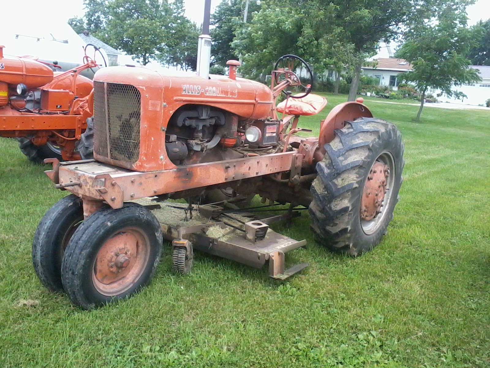

Have had this one for about ten years, power steering makes this work great. New belt right after i got it. Guess i am lucky with the belt! Cant imagine it would use that more gas than a ca. Got the belt from Motion Ind. Didnt right down the number, half price as from Woods, and just as good. I mow roads sides and around sheds on the farm.
