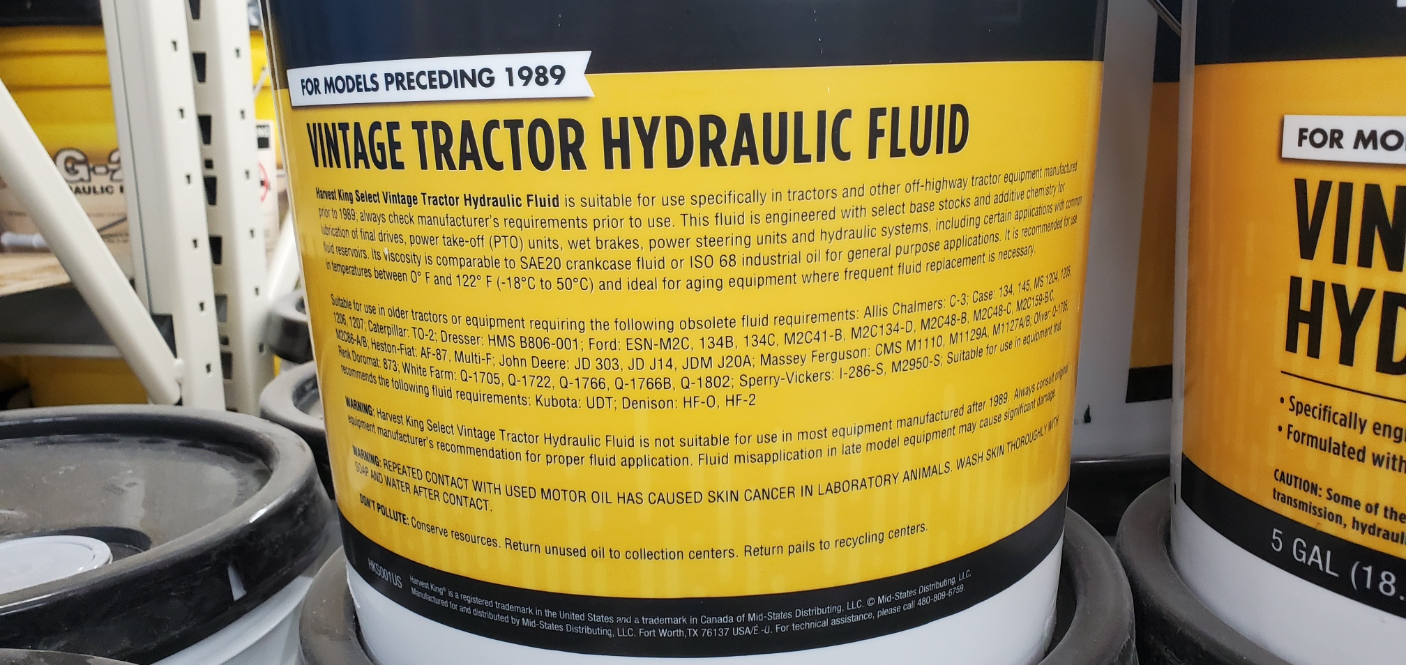

Seen this stuff at local Farm and Home store today . 49.99 for 5 gallons. The "modern" stuff that is for tractors manufactured after 1989 is 39.99 for 5 gallons
