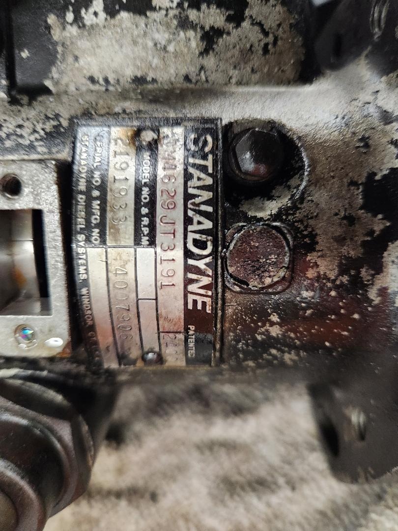

o   NOTE: THE PUMP I AM USING IS FROM THE ORIGINAL 7020 ENGINE WHILE THE INJECTORS ARE FROM THE M2 ENGINE.
o   Here is the note from the diesel shop from their teardown:     We checked the injectors, they were between 3500-3700 PSI and sticky, We dismantled and cleaned them, all but 2 worked good when we adjusted them.  We had to order 2 new nozzle valves from Denver. The injection pump was
sticky inside as well, the fuel setting was turned up excessively ,we
adjusted it back down closer to spec. but have not got to the point of
calibrating it yet.

·         I’ve attached a picture of the injection pump below.
