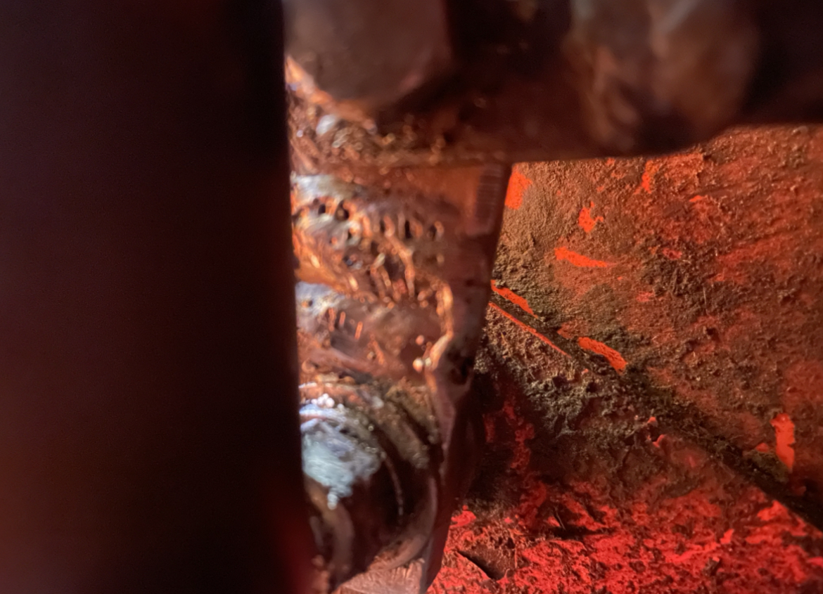

Post Options Post Options   Thanks (0) Thanks(0)   Quote 55allis Quote  Post ReplyReply Direct Link To This Post Posted: 23 Mar 2024 at 10:24pm
Well I may have fixed the reverse problem…
I extended the arm on the hydro lever so it will have more movement…
Pictures aren’t very good but you can kinda see what I did..
