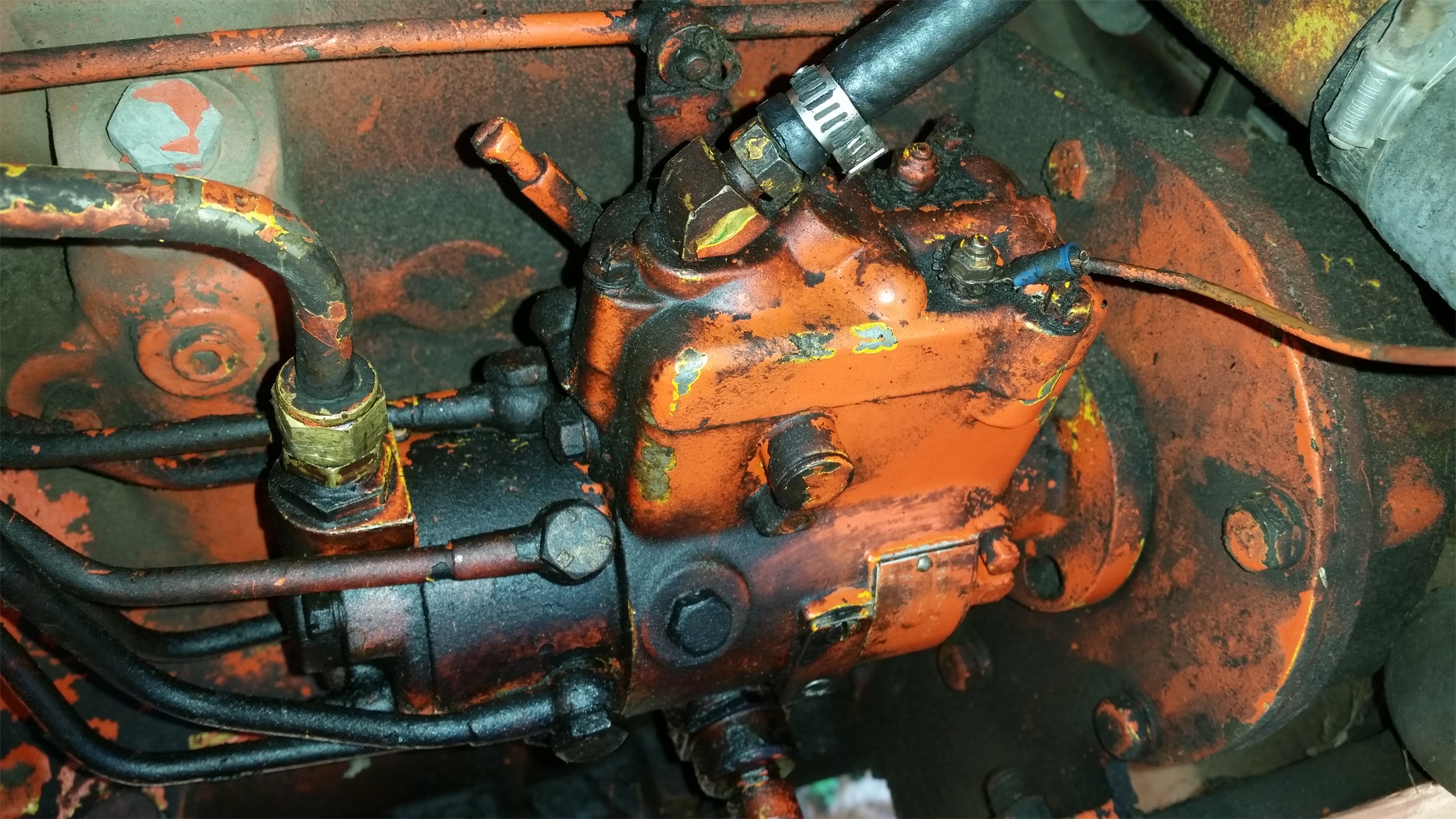

Post Options Post Options   Thanks (0) Thanks(0)   Quote McGatha185 Quote  Post ReplyReply Direct Link To This Post Posted: 11 Nov 2016 at 12:25pm
This is the wire I'm talking about. I don't see any solenoid that it'd be kicking in. Is this right? The moisture is from degreaser I just sprayed on it.

Post Options Post Options   Thanks (0) Thanks(0)   Quote Leon B MO Quote  Post ReplyReply Direct Link To This Post Posted: 11 Nov 2016 at 1:11pm
Do as Mack said above. Take that wire off, and run a temporary hot wire to that post. You'll here a click inside the pump, if so try to start the motor. You will have to disconnect the wire to kill it, might use an alligator clip on the battery end of the temporary wire. Could be mice got to some wiring behind the dash, might check that too.

Post Options Post Options   Thanks (0) Thanks(0)   Quote Lynn Marshall Quote  Post ReplyReply Direct Link To This Post Posted: 11 Nov 2016 at 1:12pm
You need 12 volt power to that wire to make it start. There's a small solenoid under the pump cover to make it work.

Post Options Post Options   Thanks (0) Thanks(0)   Quote injpumpEd Quote  Post ReplyReply Direct Link To This Post Posted: 11 Nov 2016 at 1:44pm
Those two nuts sticking out the top of pump are the solenoid terminals. One side is the switched 12v, the other should be ground, most just have a small strap that goes right to the front cover attaching screw. Some safety switches use the ground side to kill the engine, so check the ground and hot sides of the solenoid terminals. Like said above, you should hear it "click" inside the top cover of the pump.

Post Options Post Options   Thanks (0) Thanks(0)   Quote McGatha185 Quote  Post ReplyReply Direct Link To This Post Posted: 11 Nov 2016 at 4:10pm
Sorry, that wasn't it. When I checked it last night, I grounded my meter on the painted loader. My meter didn't like the paint. I took the wire loose and set up wire with alligator clips from the battery to the post. It clicked, but when I tried to check the voltage, I got zero again. I grounded on the bare hydraulic cylinder and it showed the volts. I rechecked my wire and it showed me volts now too. So the wire is good. Sorry about that. I did hear the solenoid click too with the tractor's wire. Should I have a ground wire off this pump?
