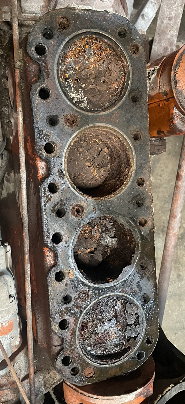

Well the engine is shot…
I pulled the head and found 1 broken sleeve and 4 out of 4 broke up pistons…

Lars(wi) View Drop Down
Location: Permian Basin
Points: 8300
Post Options Post Options   Thanks (0) Thanks(0)   Quote Lars(wi) Quote  Post ReplyReply Direct Link To This Post Posted: 15 Jun 2024 at 5:10pm
Nah, couple cans of WD40, charge up the battery, and your good to go!!

At least it's not some oddball manufacturer's engine. You should still be able to get all the parts you need since it's the B/C engine in power unit form.

New sleeve and piston set and a couple of gaskets and you're well on your way!
