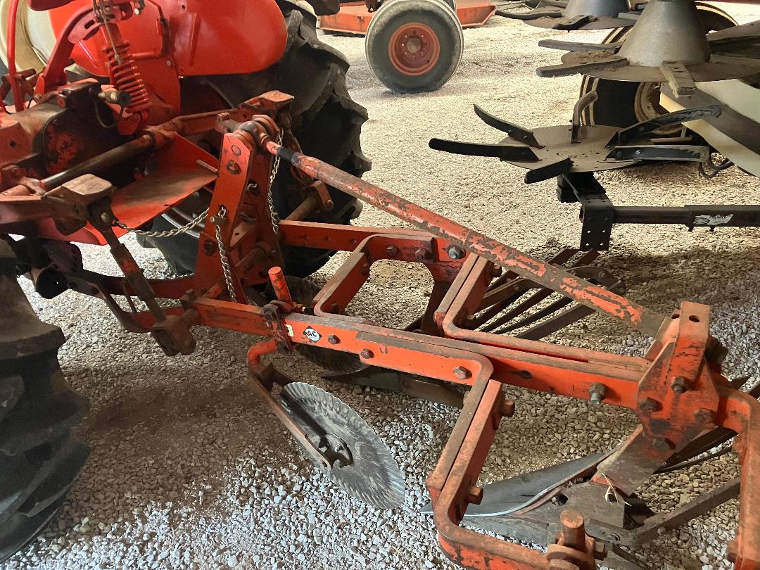

The cylinders on the plow are not the same. I have 2 actualy Allis impliment cylinders and they are different. I'm not sure if you still use the 45 lift cylinder though. Depends if the stroke is long enough and the pins are the right size. I have the 3 bottom version of that plow. It doesn't lift high, so you want all the stroke you can get.

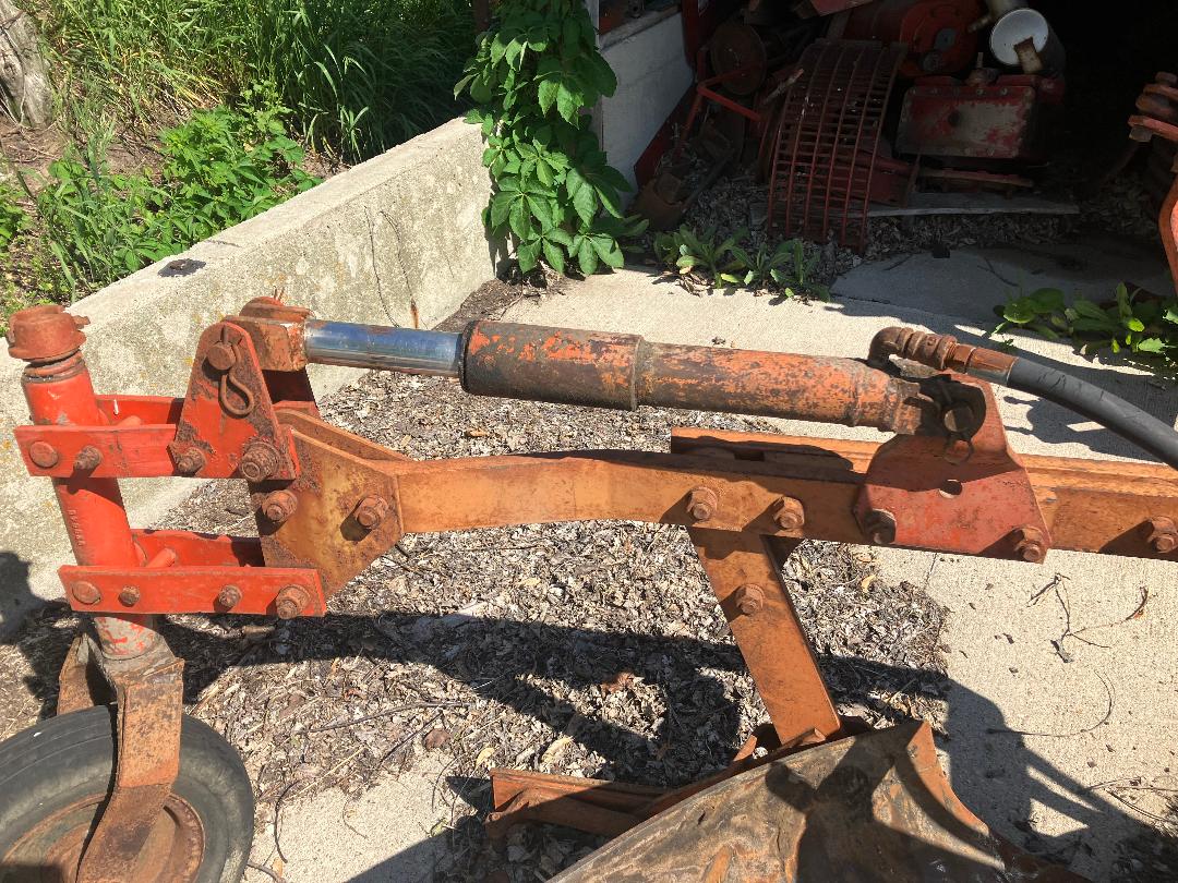

Looking at those pictures the cylinder on the tail wheel does appear to be larger diameter than the lift arm cylinders. I be interested in dimensions of the correct cylinder if someone has one that they can measure. These tools are a bit rough, but better than the ones I didn't have. The plow has an 8 foot tall shrub growing through it if that tells you how long it's been sitting. Nice looking shrub, I kinda would like to take it with me.

The plow in the picture is a 60-series because it has angled beams going down to each plow bottom.  50-series has straight down beams. To use a plow like that you have to have a Transport Valve accessory on the tractor, which sees to it the front of the plow always comes up first.

The picture shown is a 60-series, which has an angled beam to the bottoms. A 70/80-series also has the same style angled beam BUT the frame is adjustable in width, say 14 inch cut or 16 inch cut. The picture shown is NOT a 70/80-series frame. It is a fixed width frame.

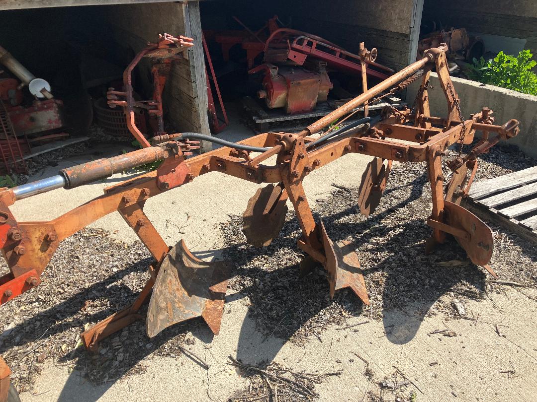

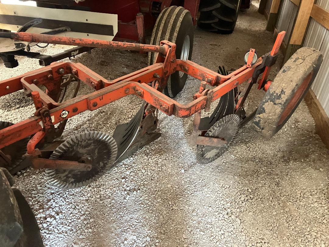

Attached is a picture of the actual plow. Not a great photo but it's all I have.

  Allis Dave,  I have a 60 series semi mounted plow and it has plenty of ground clearance when raised.
Points: 56018
Post Options Post Options   Thanks (0) Thanks(0)   Quote DiyDave Quote  Post ReplyReply Direct Link To This Post Posted: 26 May 2023 at 6:15pm
I'd say a 64, but it does have the square frame above the regular frame...  It is also missing the gauge wheel that goes in the slot forward of the tail wheel.  Post a picture side view from the coulter side, and it will help the ID process...Wink
Points: 5439
Post Options Post Options   Thanks (0) Thanks(0)   Quote PaulB Quote  Post ReplyReply Direct Link To This Post Posted: 26 May 2023 at 6:23pm
That looks to be an 80 series plow frame, as I can see the spring trips for the beams.

 I just looked through some E$ay listings for manuals. I believe that it's a 74. It has the same square tube on top of the frame with what appears to be the holes for adjustment that Doc spoke a bit about. Also, the 64 manual didn't show a gauge wheel. That's what I think anyway. It will probably be a week give or take before I actually get it home to get a better look at it.

From the photo, it appears to have the gauge wheel bracket but not the gauge wheel.
My dad had to add a gauge wheel to our model 74 plow. It did not have a gauge wheel on it when he purchased it new.

I think Paul is correct with 84. Best I can tell they are trip bottoms.    Tracy

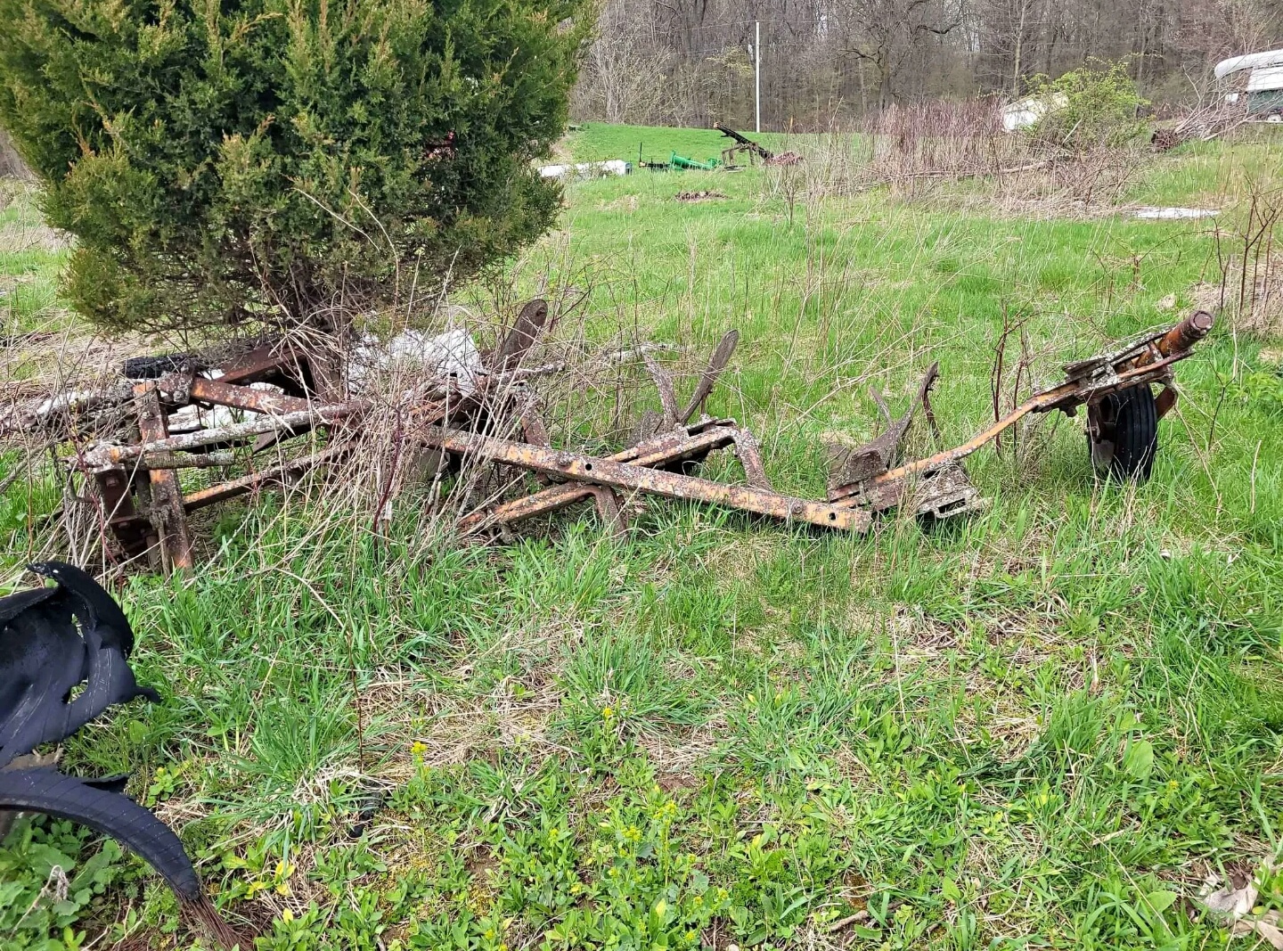

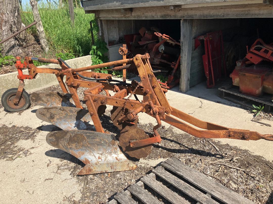

Got a few pictures yesterday, maybe get a few more today. Couple of the 73 to show the adjustable frame and a couple of the semi-mount and one of the lift cylinder.

I might be thinking of my 73 mounted that has little clearance. If I'm not careful coming out of the shed, it'll drag on the door footers.  the mounted 70/80 frames don't lift as high as the old frames. I never used the old semi-mount thogh so I"m not sure how it is.
Points: 23493
Post Options Post Options   Thanks (0) Thanks(0)   Quote DrAllis Quote  Post ReplyReply Direct Link To This Post Posted: 30 May 2023 at 8:36am
A 73 series on a WD45 usually doesn't lift very high due to two things. #1. it is plenty of plow for a WD45 and if you get the depth set so you can pull it well, you are kind of on the shallow side. This is the first thing that lessens total lift when raised. The second thing was that plow was really designed for the D-17, which would pull it deeper than a WD45, which then makes it raise higher when out of the ground. Also, the D-17 as a general rule always had 16.9 rear rubber which were taller than 14.9's, again raising the plow higher when lifted out of the ground. Been there and Dun that 55 yrs ago when Dad bought a new 73 series slat bottom 16 inch cut.
