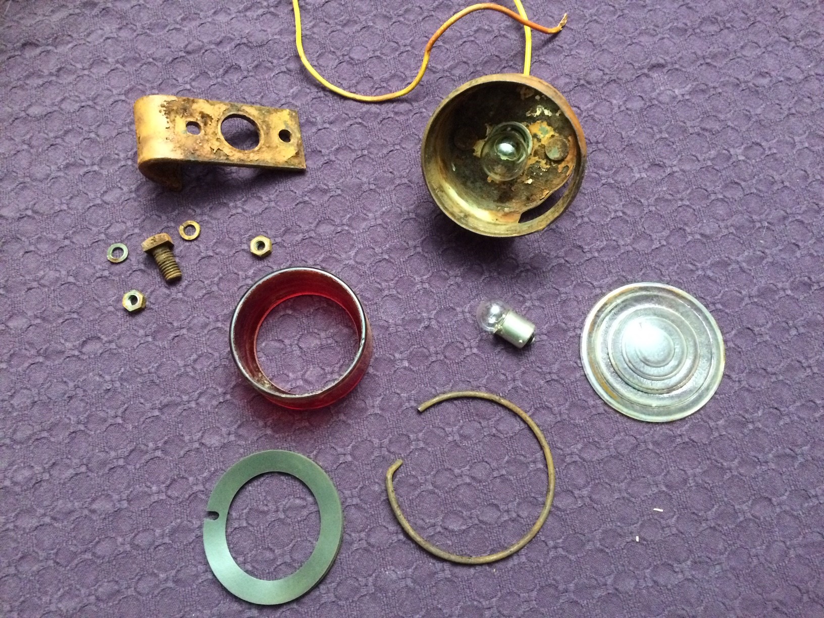

I don't know the number but this is a complete one that I had at one time.  I was looking to do 6v to 12 v so don't recall if it was the larger or smaller bulb that was in it.  If it helps...…

I'm trying to get these made with a 3D printer but iI'm not sure of what I'm seeing here.
Is that red cylinder have a lip on one end? Looks like the back has a smaller opening.
What proveded the seal ( if there was one) I see a gasket for one end ( between the cylinder and the disk?)  but waster would get in between the red lens and the can
Does anyone have one to measure?

Looks like you have a 6v bulb. Compare it size wise with an 1156. that would be a single filament 12 V bulb.
