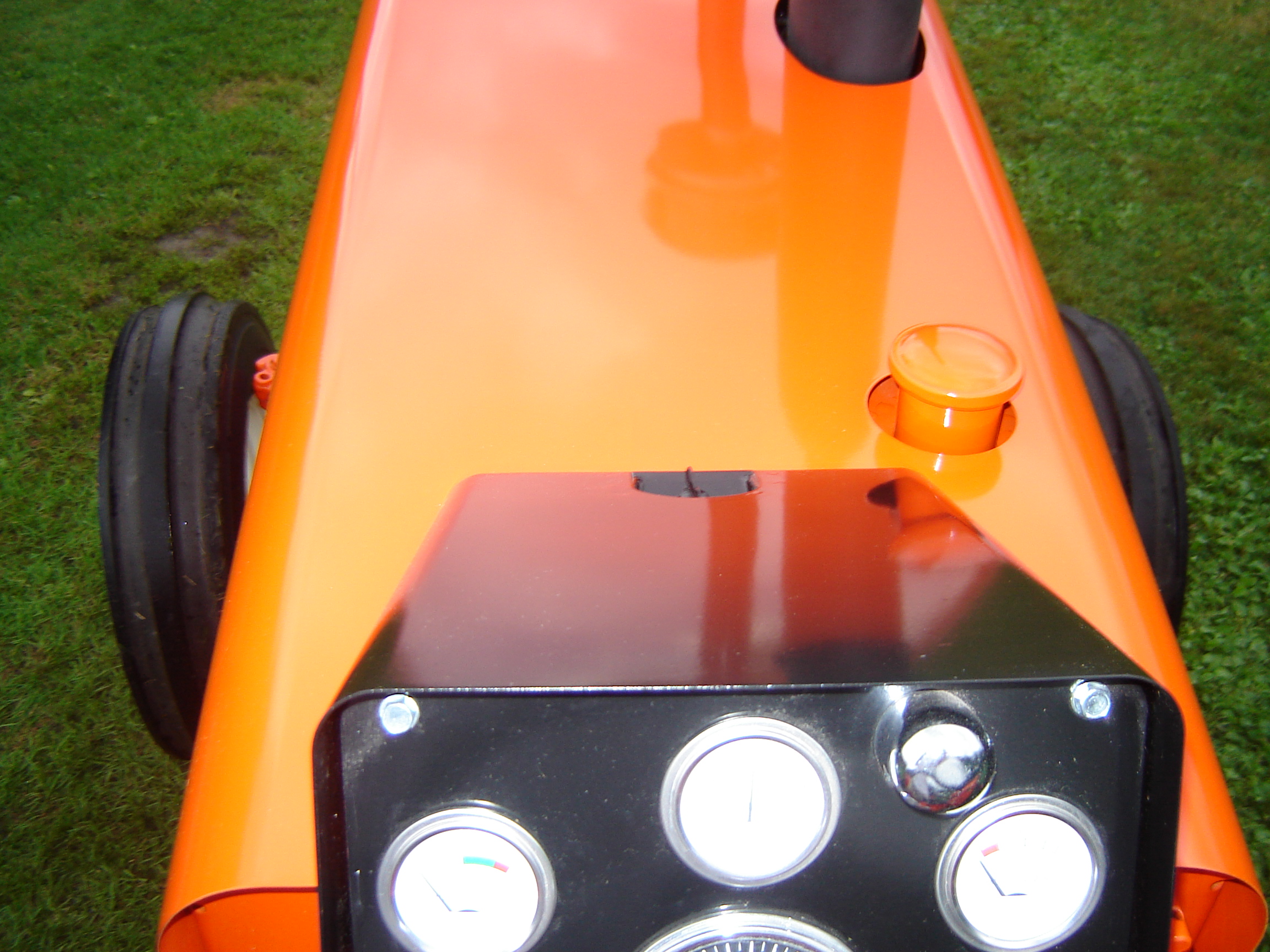

My grandfather bought this 175 in 1978 when it was a year old.  I grew up on the tractor, and that latch never closed properly.  Over the years, the hood and cowl had been removed numerous times - no difference.
When I restored the tractor in 2015, surprise surprise, the latch actually closes now!  I can't explain it and I don't know what I did.

7060: only the 170 and 175 use this cowl. All the other models are bolted in place - my 185 and 190 are secured with a number of bolts.
If it isn't latched, it will not go anywhere but will vibrate against the hood, with a slight rattle coming from the wing nut latch. To answer your question, yes, the "twist toggle" is the only thing that secures the cowl to the hood. It sits on pins on either side, but the "springiness" of the cowl keeps things snug along the sides.

Look at my picture above.  It's the black panel that sits on top of the hood.

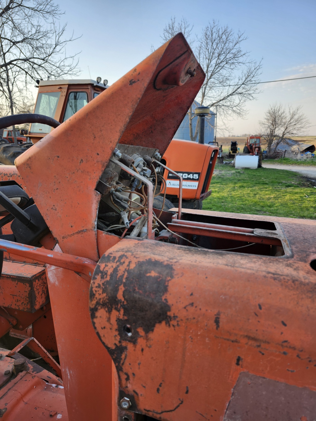

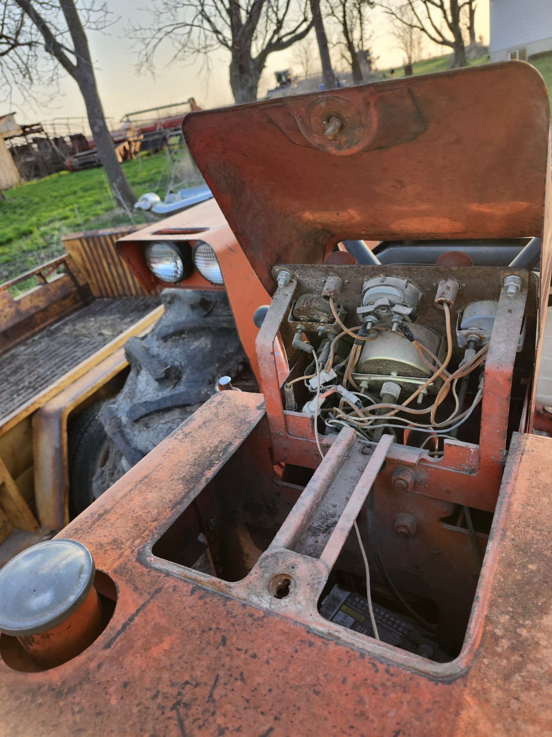

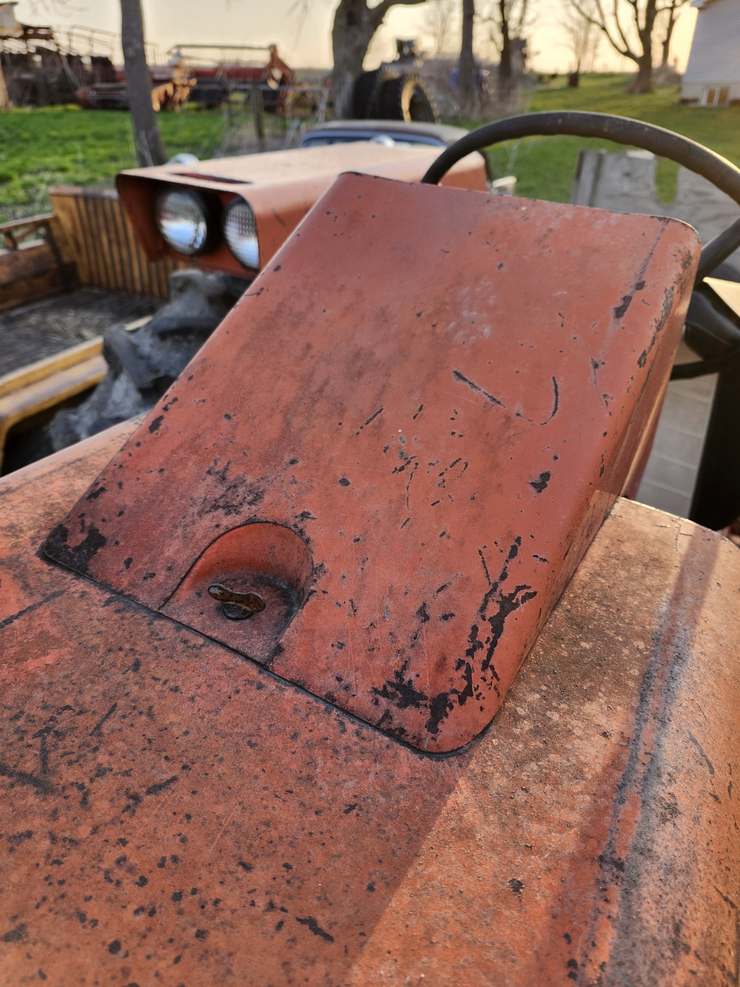

Maybe this will clarify?
Looks like I need to retract my earlier statement about it not working right. It acts as it should now but there was a time when the wing bolt would not engage the slot properly

Plummerscarin,  Your missing the thin rubber washer under the cover at the fastener.
 All three fasteners on my One-Seventy's and 170 still work great.

Didn't know about the rubber washer. I'll have to see about getting one.
As noted before, I couldn't get the thing to engage properly yet there in the photos it is fastened down. I don't remember the moment it worked. I have sprayed some chain lube in it. Surely that should help.

I like the flip cove; makes it easy to access the wiring behind the instruments, fuses as well as the battery cables. I switched the hex bolts on the side cover for a couple of 5/16 adjustment screws from an office chair (not sure what the real name for them is) so that I can unscrew them without tools to access the battery and slide it out the side. I do wish they had sectioned the hood so that you could access the engine a little more easily.
