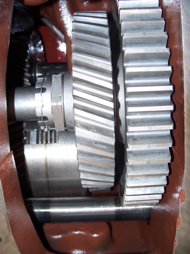

Post Options Post Options   Thanks (0) Thanks(0)   Quote LB0442 Quote  Post ReplyReply Direct Link To This Post Posted: 13 Jun 2020 at 8:36pm
If it has just the 1000 PTO then you can get the seal from the back.  If it has 540/1000 you have to drain rear end oil, drop that rear cover/plate and you will see both gears and a large nut.  Remove the wire and pin, back off nut then you can remove shaft to replace seal.  Mark where the old nut was as there is a slight preload on the bearings in there.

Post Options Post Options   Thanks (0) Thanks(0)   Quote MACK Quote  Post ReplyReply Direct Link To This Post Posted: 13 Jun 2020 at 9:31pm
After you remove nut, use slide hammer to remove inner shaft. Then remove bolts behind outer flange. Then pry shaft assembly out, catching the two gears and thrust bearings.        MACK
