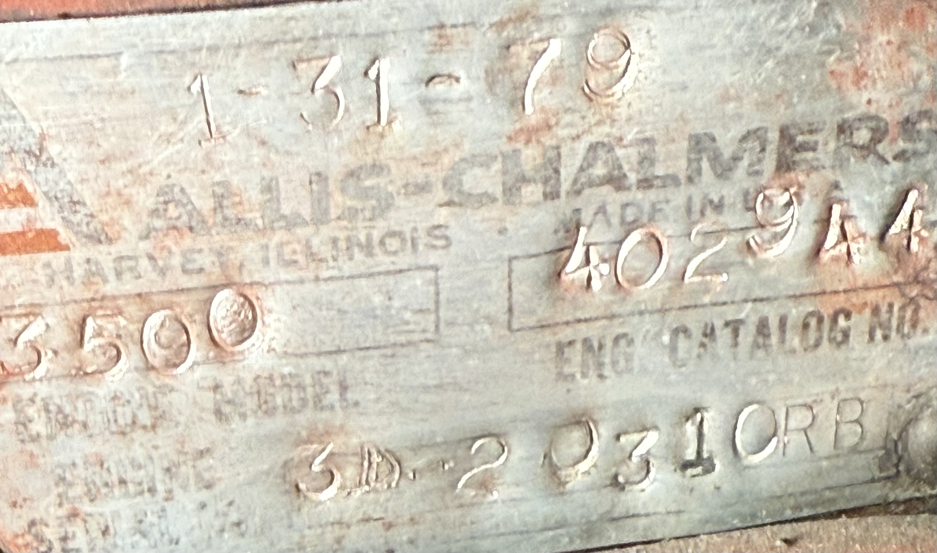

7030 - unable to get it to start. Rebuilt injection pump, rebuilt engine, new starter, new batteries. The engine doesn’t appear to be the original. I attached a picture of the tag off the engine. We tried timing at 24 degrees, but all it does is smoke. The engine says 1-31-1979, so guessing this isn’t the original. Wondering what we need to do to get it fire. Thank you!

I do appreciate the responses, but some of your previous notes didn’t come across to me as confidence building. I’m sorry. We haven’t much luck getting anything to work like it should lately. This tractor is just another thing in a long line of problems. The engine is dated 1-31-79, the tractor serial is 70301993, which means the tractor was built in 1973. All we really want to is if that engine should really be for a 7030, or if it’s for some other model. If we know that if it’s for like a 7040, the timing has to be different. We replaced the crankshaft pulley, so it shouldn’t have shifted.

It runs tonight. Appears to be a 7040 engine in a 7030 unit. Set it to 16 degrees & it took right off.
