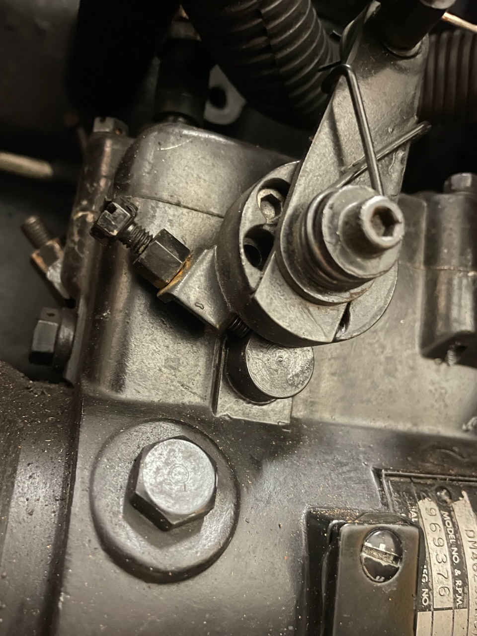

Don't dismiss the plugged fuel filter base (if it is the square clip-on filter) or the fuel shut-off lever position. You don't need a boost gauge to check those two things.

I will try and blow out filter housing to pump and see if that makes a difference then will try wiring back the shut off cable to see if cable actually not set properly.
Is there any type of screen in the roosa master pump that could be clogged with debris from previous owner rebuilding pump but running that bad fuel through it? The pump is the only thing I have not touched in the whole fuel system.

Your filter housing for a spin-on filter I have never seen plug, so I doubt that's the problem. The Roosa pump indeed has an internal screen inside the inlet part of the pump. If the pump was truly gone thru by a pump shop, I would expect it to have no paint on it OR be repainted, which would stand out against the paint on the engine.

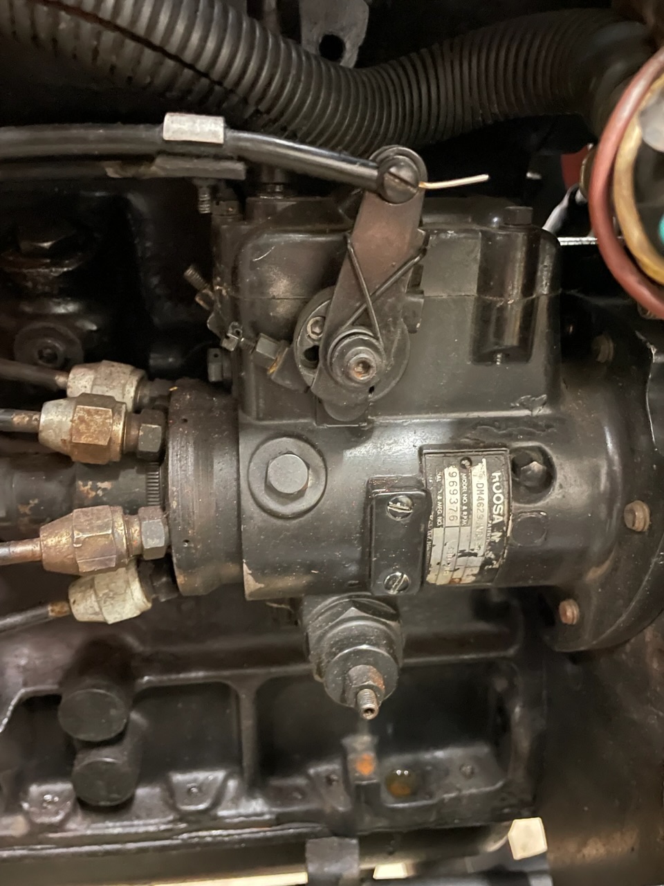

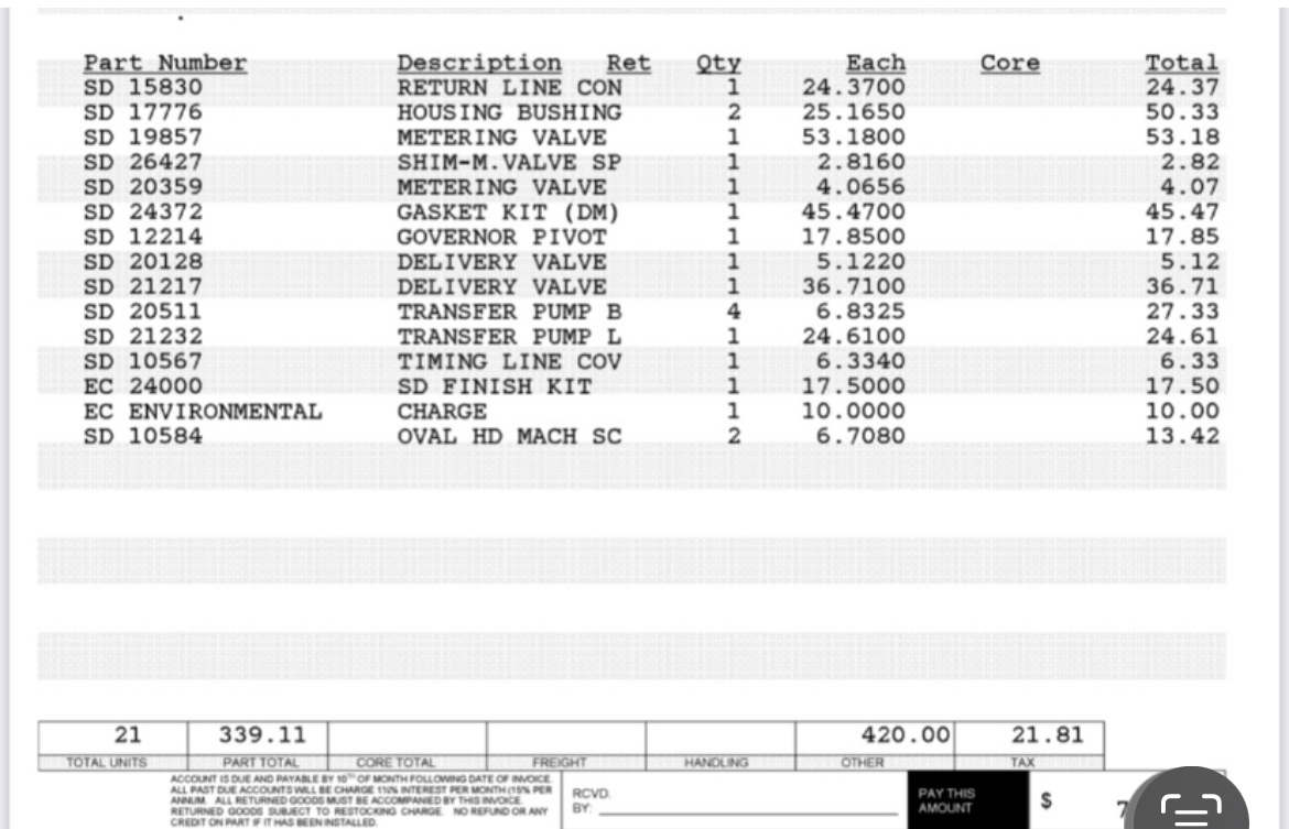

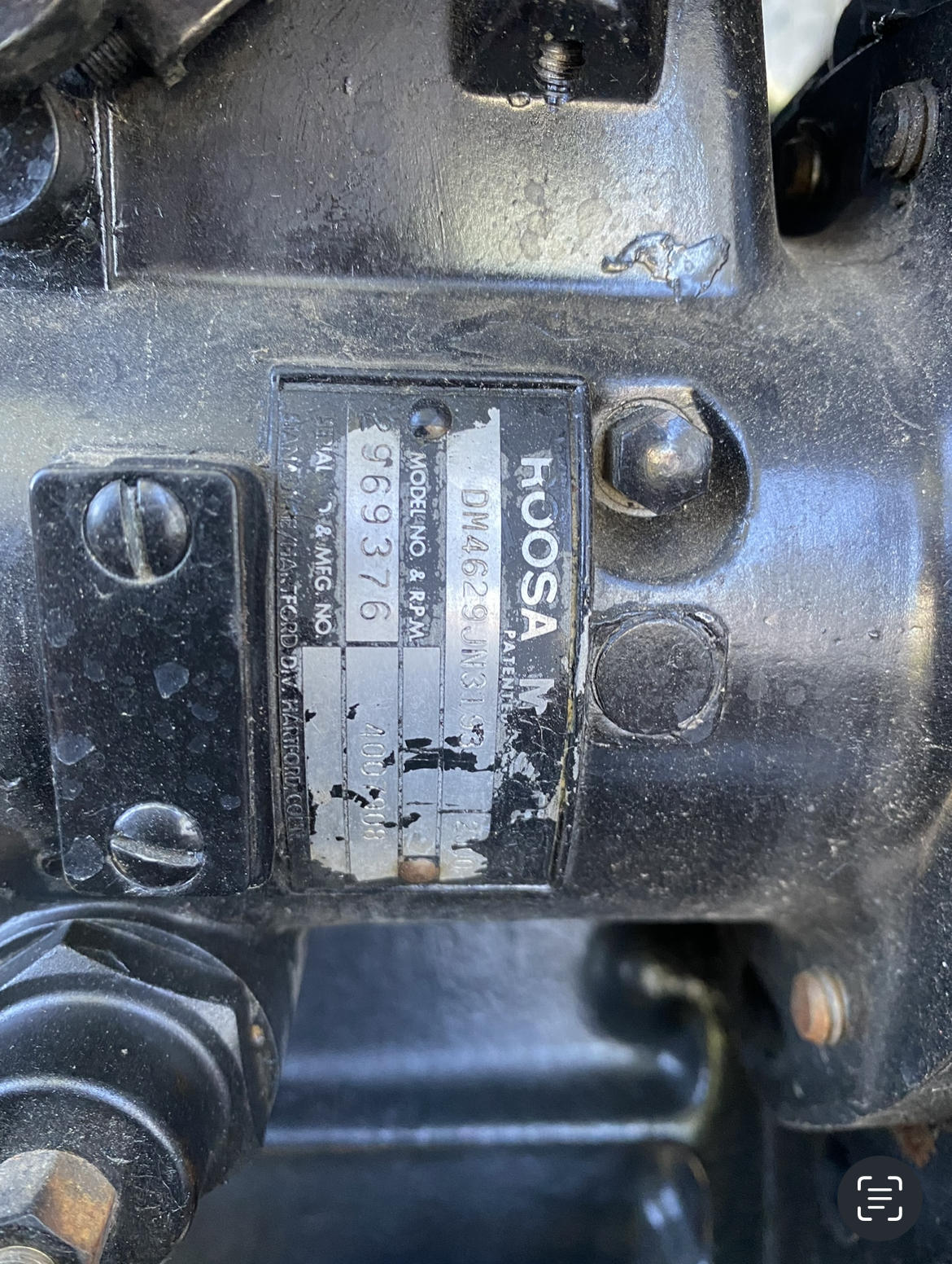

It doesn’t look much different honestly. Supposedly was done 10 hours ago. Here is receipt he gave me for pump along with picture of pump. Can I check/clean screen in pump without hurting anything?

I am thinking more and more might be pump since everything else was gone through that or turbo maybe.

Those prices are what I have from 2016. It could be all gummed up inside. I've seen pumps get gummed up with crummy modern diesel in a year or less. You already said it had algae, so I'd bet money it's nasty inside the pump and not working properly.

It very well could have been 10 hours ago, but 10 years ago that was rebuilt and sat the whole time. The tank had weird smell to it and the stuff at bottom was like goo and the fuel lines had same stuff in them.
What are my options if pump has been rebuilt, but gummed up? Can it be cleaned up with minimal cost? It is a nice tractor in great shape just sick of it nickel and diming me here lately.

I rebuild them all the time here, it would run about $1000 to go through it. Usually the biggest issue is cleaning it up and replacing damaged parts. If it starts ok, hot or cold, then the pump head should be usable. I've seen them coming in lately even worse than ever before, not sure what is going on.

It fires right up hot and cold. Revs out fine in neutral and lower gears. If pump was rebuilt and everything looks good, it would still cost $1,000 to just clean it up?

That's just a typical rebuild price range. If things are reusuable, I reuse them. If damaged or worn out, I replace them. No way of knowing what kind of condition it's in until it's opened up. Many times the moisture pits the rollers and cam ring, along with other key components.

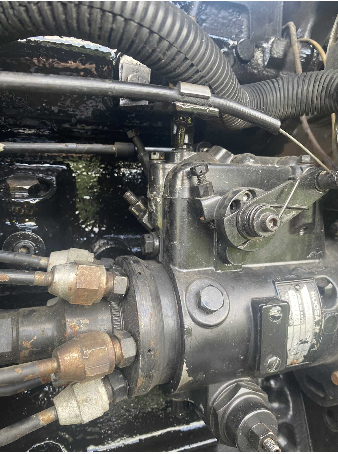

Made out in the shop for a little bit tonight. Unhooked cable and pinned back shut off. Did not make a difference when getting out and driving down the road. See picture attached. Can I screw out the stop screw all the way without hurting the pump so that fuel shut off is “more” open and then try again? I imagine it shouldn’t hurt anything, but wanted to ask before just doing it.
Points: 23569
Post Options Post Options   Thanks (0) Thanks(0)   Quote DrAllis Quote  Post ReplyReply Direct Link To This Post Posted: 29 Sep 2023 at 11:09pm
You may, but it should NOT change anything. Loosen the screw and do not change the lock nut. Just back out the screw 1/4" and try it. Return back to where it was when it doesn't do any good.

Pinning back the fuel shutoff did not seem to help. I’m at a loss still. I’m really thinking it may be the pump. Any other ideas?
Points: 23569
Post Options Post Options   Thanks (0) Thanks(0)   Quote DrAllis Quote  Post ReplyReply Direct Link To This Post Posted: 11 Nov 2023 at 9:15pm
No boost gauge test numbers ?? No dyno test ?? Did you loosen the shut-off stop screw 1/4" and try it more open ??  Can't help you.  Sounds like the injection pump to me.

I did loosen the shut off stop screw and tried it more open and no change. I am going to try and get boost number here soon.
