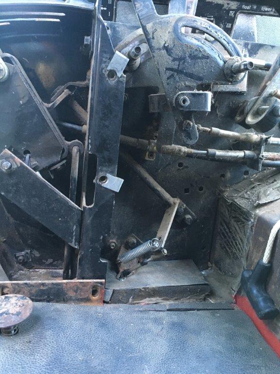

Post Options Post Options   Thanks (0) Thanks(0)   Quote Roscoe62 Quote  Post ReplyReply Direct Link To This Post Posted: 14 May 2017 at 7:07am
Couldn't wait, so I did it this morning.  Unbelievable.  Works first time, every time.
I just used a heavy spring in the spare parts bin.   Photos below:
Thanks, thanks!

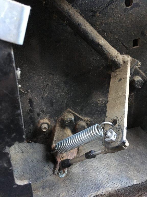

Post Options Post Options   Thanks (0) Thanks(0)   Quote Roscoe62 Quote  Post ReplyReply Direct Link To This Post Posted: 14 May 2017 at 7:12am
Close up:

Post Options Post Options   Thanks (0) Thanks(0)   Quote DougG Quote  Post ReplyReply Direct Link To This Post Posted: 14 May 2017 at 7:16am
Perfect!
