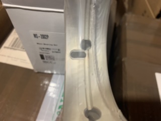

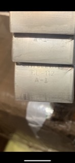

Post Options Post Options   Thanks (0) Thanks(0)   Quote cms Quote  Post ReplyReply Direct Link To This Post Posted: 01 Jun 2023 at 6:56pm
I have pictures can’t get to load.

Post Options Post Options   Thanks (0) Thanks(0)   Quote cms Quote  Post ReplyReply Direct Link To This Post Posted: 01 Jun 2023 at 6:58pm

Post Options Post Options   Thanks (0) Thanks(0)   Quote cms Quote  Post ReplyReply Direct Link To This Post Posted: 01 Jun 2023 at 7:00pm
