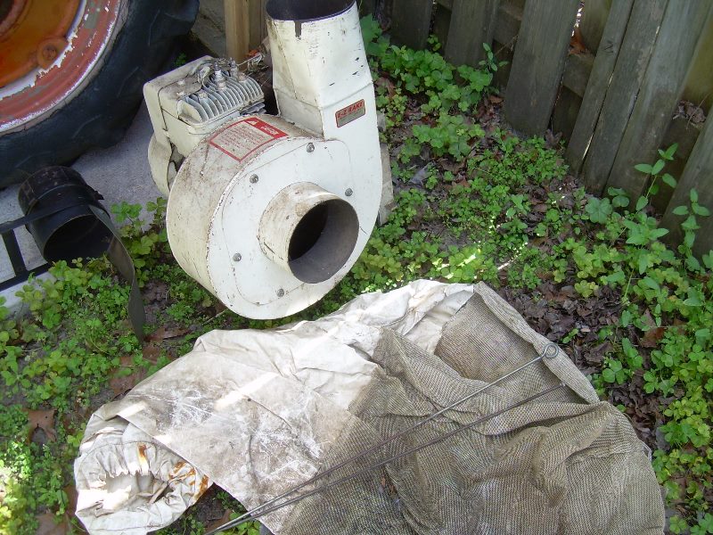

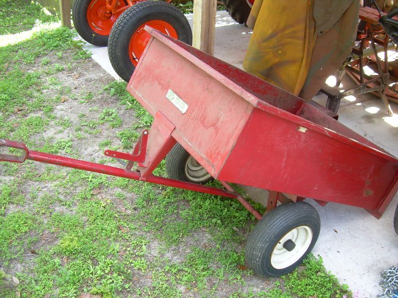

Well, I finally bought a garden tractor.  I bought a 314H that hasn't run in 20 years.  I got the tractor and a complete EZ Vac system for it for $550.  I know it's a risk buying it without hearing it run and the HST is a concern, but I thought, what the heck.  It appears well maintained and it was all kept inside all this time.  My first problem is that I can't get it to roll.  Doesn't matter where I put the selector.  I hope this isn't a bad sign.  I will be asking for help in the near future.  I'm new to these beasts!

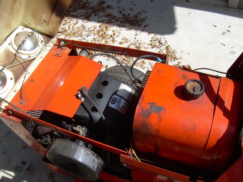

Worked on the 314.  The intake valve was stuck open.  I hit it with Kroil and worked it gently.  It finally freed up after about 3 hours.  Carb was a mess, cleaned it and got it adjusted.  The fuel pump was clogged.  After all that, I was able to get her fired up.  I think the fuel is still not reaching the cylinders because I have to goose it with ether to start it.  It drives great and mows great too.  Lift works, lights work, cigarette lighter is missing (drat!).  I really like this thing.  I plan on cleaning her up this weekend and getting things sorted.

Got it running well, but it's puking oil out of the valve cover.  I guess I've got major blow by.  Dang.  I was hoping I got a gem, but it's a turd.  Need an engine rebuild.
