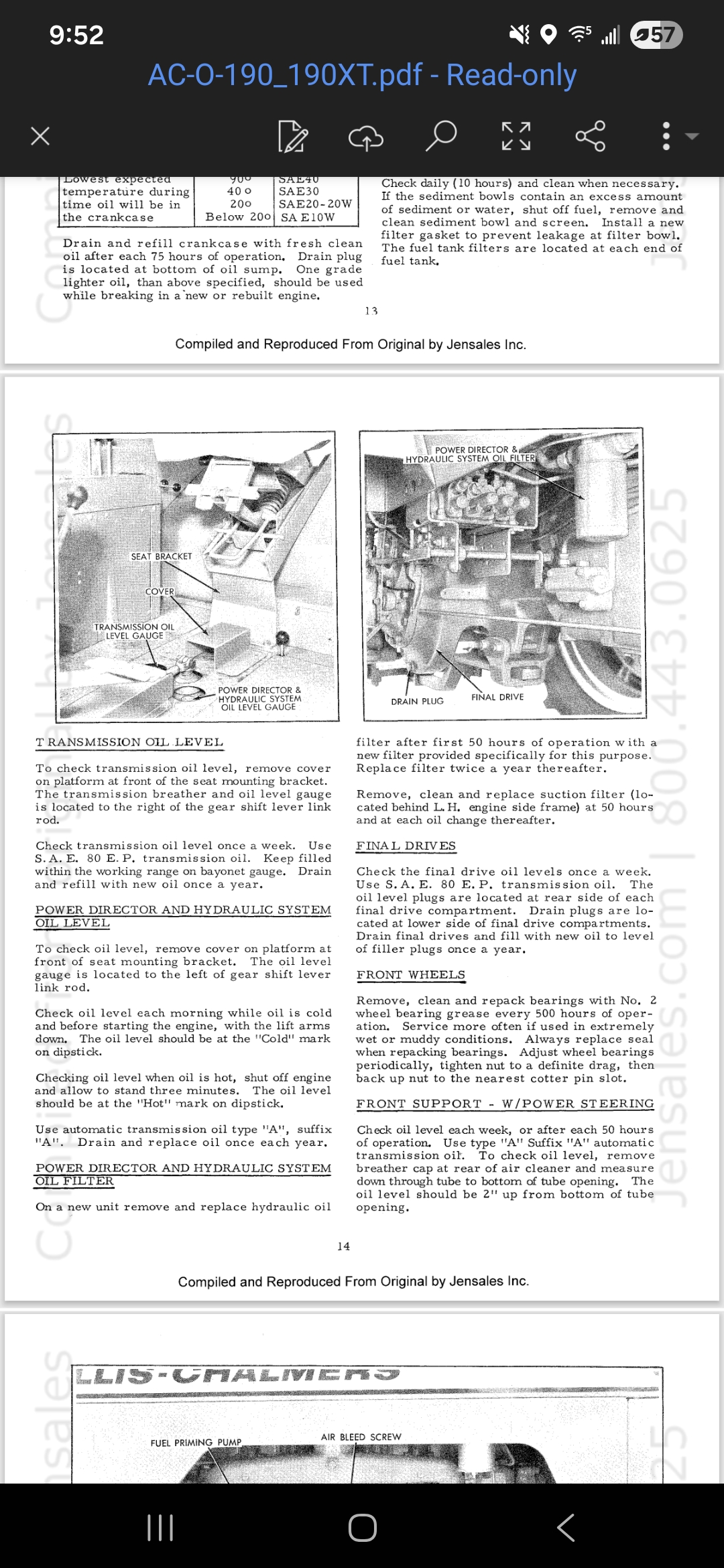

I went the recommended route and used the harvest King vintage tractor Hy-trans in both. There's two fill spots, and I only saw two drain plugs. Did I actually drain both?

Transmission drain plug is behind the battery box. Differential drain plug to the left of the PTO on the rear of the tractor. Both take 1 1/8" wrench. Gallons depend on which dipstick is used but 8 to 10 gal is the range. One compartment. One fill hole. Two drain plugs. An owners manual would clear this up and provide pictures.

Owners manual didn't say at all where any of the actual drain plugs were and are the actual source of the confusion, also no pictures. At least the one from jensales. It says two different types of fluid and two different quantities which implies two different compartments to go with the two different dipsticks and two different drain plugs and two different service intervals.
It only shows where the final drive drain plugs is, which takes a different fluid and has a different service interval and different level checking method, is it the same compartment as the transmission and hydraulic too?

An Allis-Chalmers owners manual does indeed show all these check points and drain plugs. There are two final drives...left and right. Drain plugs are obvious. Fill plugs are on the side of the rear end housing under the lift arm cylinder rod. Takes 2 gallons of 80/90 weight in each side.

The Jensales 190 190XT operators manual 100% does not show drain plug locations for the transmission or hydraulics, it mentions there being one for each but there is no picture. It shows where the final drive drain plugs are, that's it. It shows and states two separate check/fill locations for transmission and hydraulic in the cab, does these fill the same compartment despite the manual saying they should be filled with different fluids?
