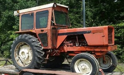

I have a 185 Diesel that the PTO stopped working on.  I can engage the lever in the cab and see all the linkage on the exterior of the tractor move. Is there anyway to look at any of the linkage in side the tractor to what the issue is? Or maybe there is a different place i should be looking at. I can freely spin the PTO shaft by hand when i try to turn it by hand.  Any help yall can give me will be greatly appreciated.
