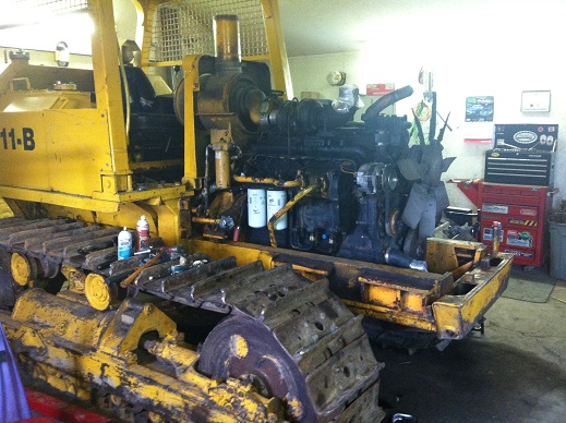

Thinking of re-powering an 11-B with the 426 engine, just because parts are available for that size.  I'm thinking the bell housing and flywheel will fit from the 11000, but not sure- does anybody know?

Be a little under powered won't it? Doubt anything is common to those two engins

MAYBE AC FOLKS DO NOT LIKE THIS BUT I AM REPLACING ENGINE IN HD11F WITH 471 DETROIT . PARTS  FOR DETROIT EASY TO GET AND LESS MONEY.

Seems the Detroit power is the way to go - seen a 17 with a 8V-71 out in western MN - now that was a nice rig - they had street pads on it - rubber booties - and guy said his dad used it in a couple local parades - yes it had Chrome twin straight stacks on it .
 A 6V-53 would also be a good power source : 6V n40 inj-172 hp @ 2800 rpm. With an N50 it is 210 HP. 53 T engine with 5C50 is rated at 230 ho @2800 rpm while 5C60 is rated at 280 @2500 rpm. Marine ratings are a little better: N engine w/ 40 inj is 148 @2400 rpm T engine with N75 is 320 @ 2800 rpm.
Another section gives this: 6VN weigh's 1485 lbs with range of hp 160 to 210. 53T weigh's 1695 and is rated at 210 to 300. All these #'s are factory settings and a 'dry weight'.

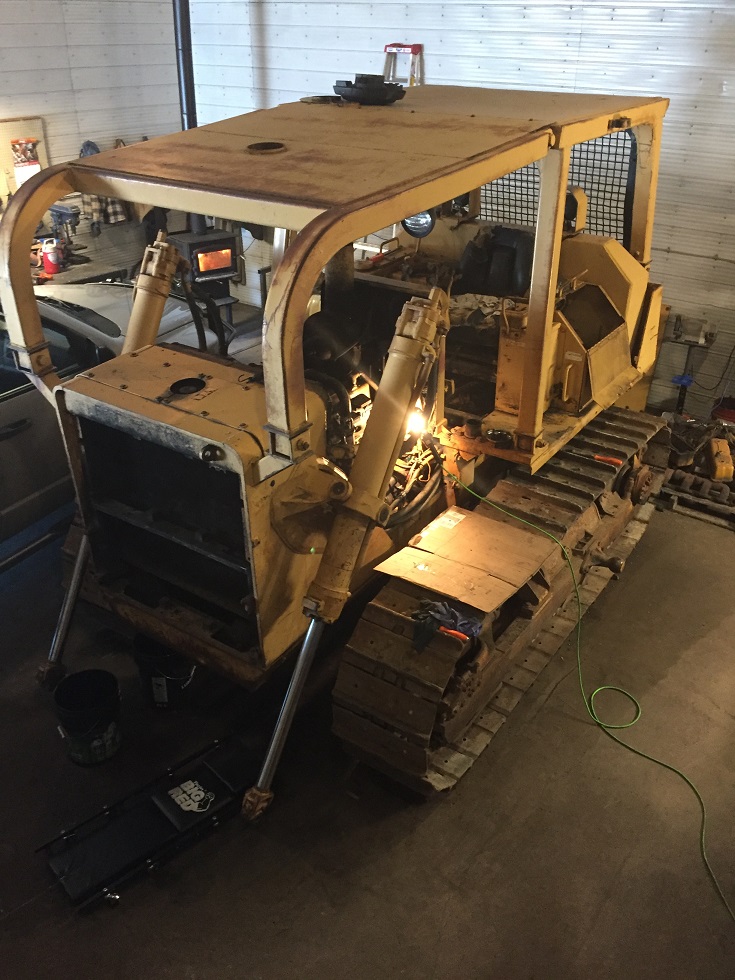

Yeah, Steve, looks like the one.  I wonder if that is one of the units mentioned in the book- looks like it had a winch/ crane setup on the back, just like he wrote about?  Would be from the right time period- 1970- looks good.  I was thinking about re- powering my latest 11B with one of those, as the engine is seized, but I'm not sure if the rest of the tractor is worth the work now, might be better used as a donor.Ouch

Yes  I think you are right ,on the pic with the sprocket there is green paint underneath the yellow and the left hand engine pic is green paint on the radiator brace ?
Mate I love the workshop pic Looks tidy and warm in there ! Its a hard call wether to fix or not sometimes she looks alright in the pic    I think the 11000 engines are finished no more engine kits ect

Yeah, the time for rebuilding those 11000s with new parts has come and gone, seems like.  I put a combine engine in one, but they are no better for parts, actually worse in some ways, as there weren't that many made.  There's lots of good parts on this one yet, I really like the "western style" canopy with the bull horn mounts- you can pull the radiator without messing with the sweeps.  I want to use that canopy for sure, trying to decide whether to fix this one, thought of getting one of those standard shift ag crawlers and swapping over the hardnose and hydraulics... would make a real good tractor for a breaking disk.

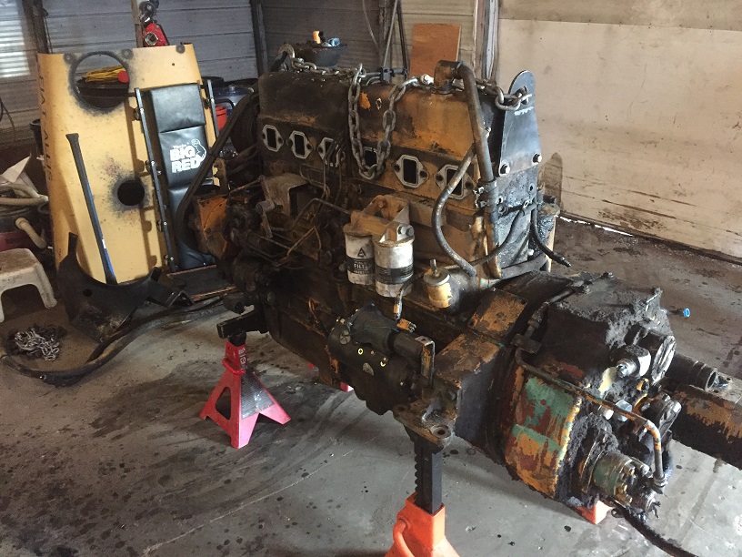

Yeah Tad, I've looked at those 8.3s, thought they would be perfect.  I was working on a TD15E last summer, which has the Dresser 8.3 (Cummins), and you're right- they're pretty quiet.  Problem is that I get too cheap to make one of those a reality.  Number 6 rod bearing turned in the engine on this one.

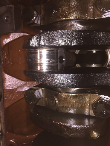

Time to find a crank, a rod and rebuild!

That is bad but not as bad as spinning a main, it is repairable, I have  welded journals that were too far under to clean up, One in an HD 6 an AC7000 wheel tractor and a John Deere  20 series I don't remember the correct model number but a four cylinder, and several Wisconsins  and took them to the local grinder and had them ground, no problem with any of them but they were all rod journals. I have welded the thrust main on a small block chevy, turned it in the lathe to get it close and then had it ground as well. Why did it spin is the question. The motor has to come out but AC built these tractors so they are easy to work on, that is why I  switched to AC. You will probably have more in a rebuild than a repower. Like I said 8.3 or even a DT466 they are very similar engines or an L10 Cummins a bit large but could be de-rated or if you want to go totally bonkers do this.     Tad

I have an extra crank, still standard size, and I found a set of bearings on Ebay a while back, but the rest of the rebuild parts are scarce.  The rod spun because the owner lent the machine to a neighbour, who dumped the machine face down into a ditch.  The engine seized up, but later came free, at which point they dumped an extra pail of oil into the engine and started it again, with hopes of using the winch to free the tractor.  Then she seized up again, this time for good.
I don't want a Detroit, but I have looked at a couple of 745C loaders with JD engines.  A couple of local gravel outfits had them.  The 945s were re-powered with 855 Cummins (and a 21C dozer as well), the 745s with 466 John Deere engines.  I also saw an HD11 advertised with a JD engine some time ago.  I'll probably go the rebuilt route, just because of the economy of using parts I already have.

Time to do a full inspection and decide what to do...
