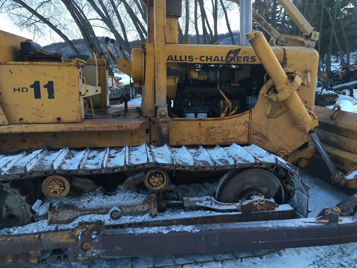

Story of my donor engine:
Injection pump quit, (Roosa Master, I think the shaft broke) so owner had it repaired at considerable cost, then mechanic installed it one tooth off (injection pump turns as you install it due to diagonal gears).  Owner knew something wasn't right, but was anxious to use it, so it ran for a few hours like that until it burned a hole through #4 piston.  This is the machine that got the N7 engine.

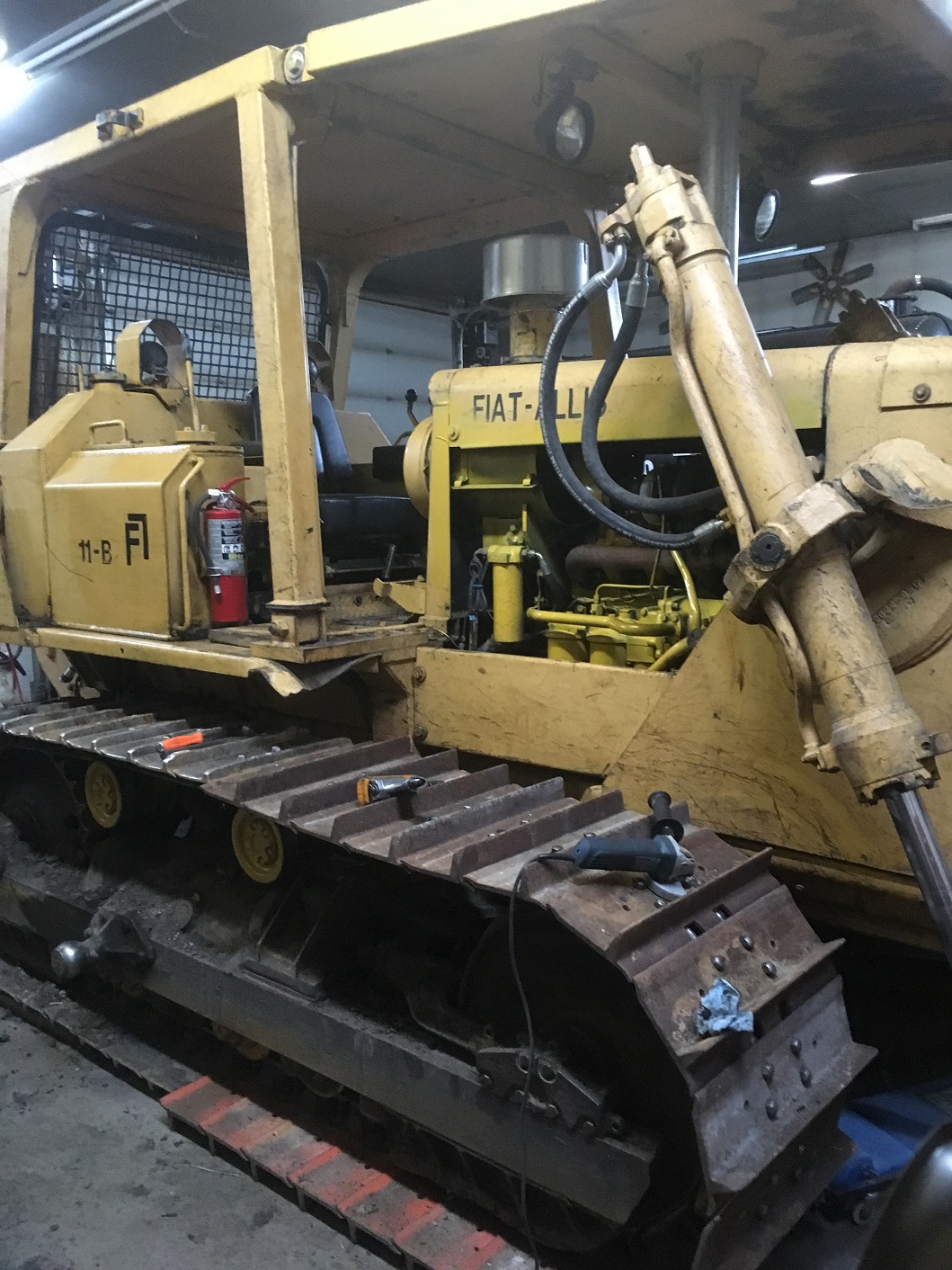

Posted By: Lazyts
Date Posted: 03 Jan 2018 at 12:53pm
Time to do a full inspection and decide what to do...

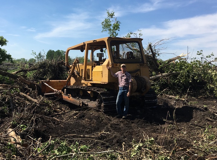

Posted By: Lazyts
Date Posted: 09 Mar 2019 at 1:32pm
So I ended up putting the engine together, new rings and honed the old liners.  I found liners after I had already put the engine together!  It ran for 20 hours, then broke another piston..  I just opened it up, put another used piston in the hole with new rings- that hole (#5) is pretty scored.  Ran for 100 hours, and injection pump quit, now got another 200 plus with no more problems, slowly working the "bugs" out.  Time for "new" shoes this winter...
Posted By: Lazyts
Date Posted: 09 Mar 2019 at 1:35pm
Also time to change dozers and add new cutting edge..
Posted By: Mactractor
Date Posted: 09 Mar 2019 at 1:51pm
Excellent work Trev. May she run smoothly from now on.

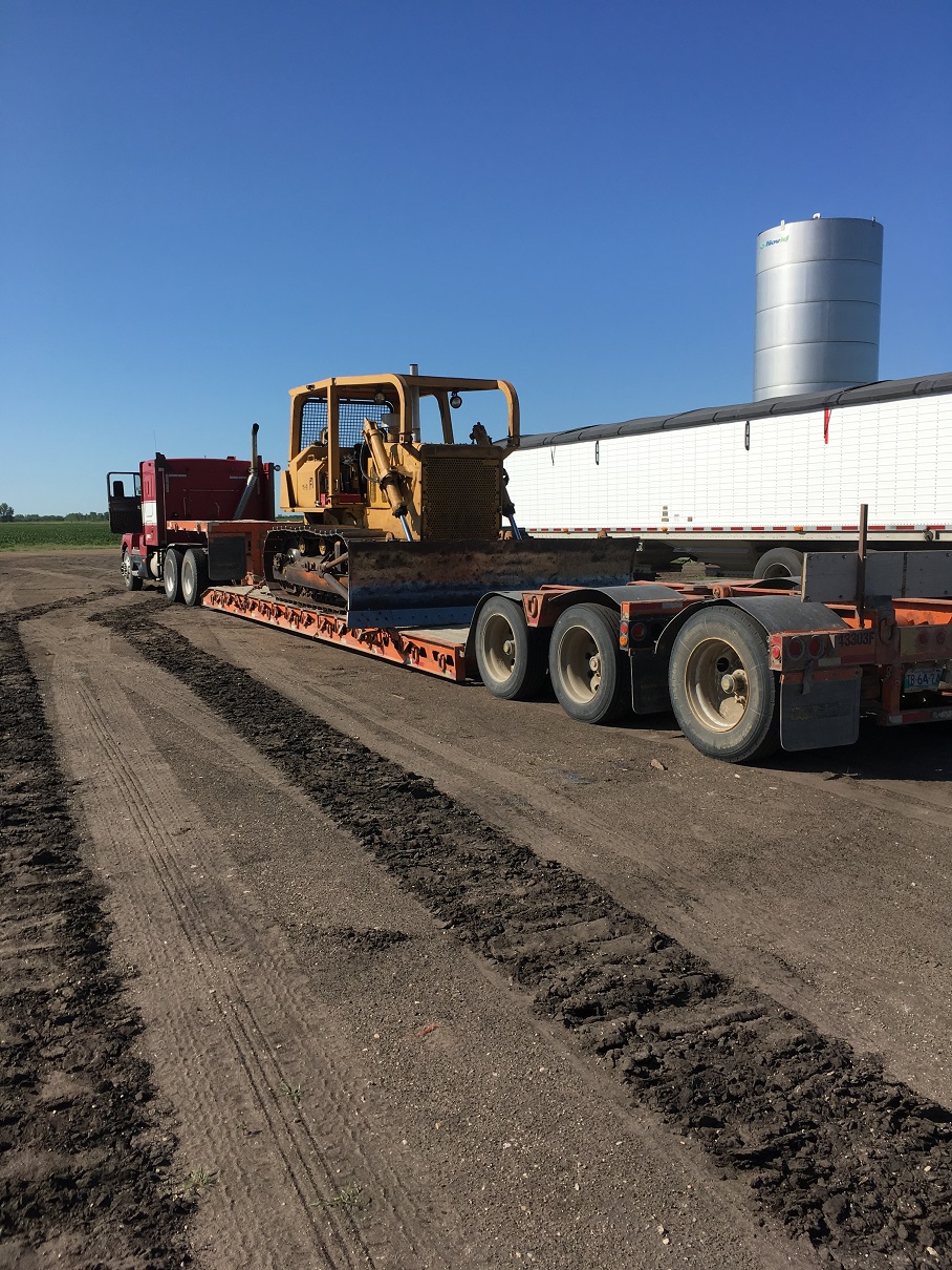

Posted By: Lazyts
Date Posted: 12 Sep 2019 at 11:04am
Date Posted: 12 Sep 2019 at 5:51pm
She's all good Trev. Well done.

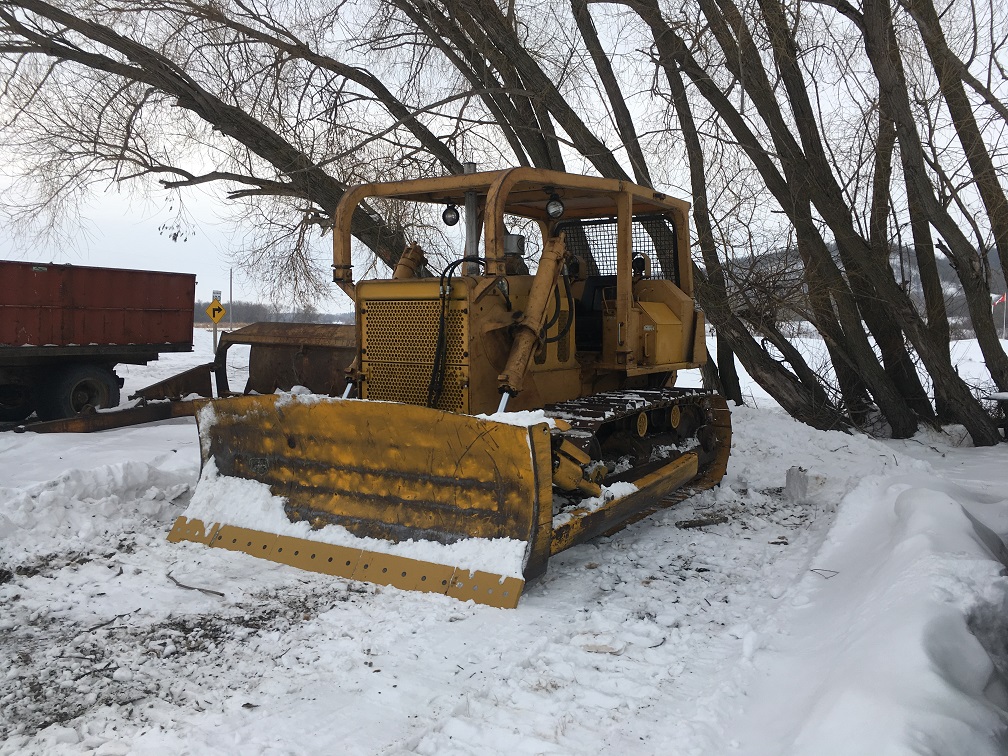

Posted By: Lazyts
Date Posted: 21 Feb 2020 at 9:00pm
Here is another HD11 I repowered with the 685 combine engine this winter.
Posted By: HD6 Merv
Date Posted: 22 Feb 2020 at 12:21pm
Both your 11 s look great; cheers for sharing Trev
tits tyres and tracks
they all cost you money
Posted By: Lazyts
Date Posted: 25 Feb 2020 at 8:55pm
The EP is not mine, but I did own it at one time.  They have their way of coming back to me for "doctorin'" ...
