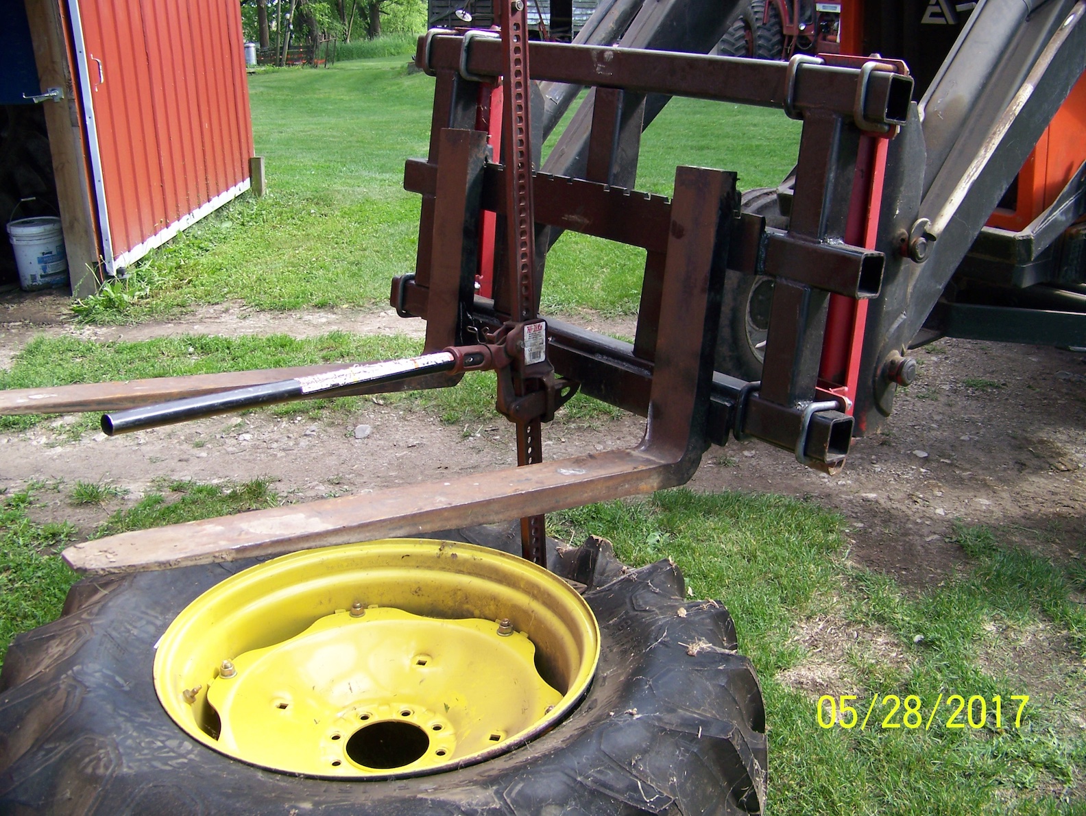

Not updated this and meant to. I broke the tire down and patched both the tube, and booted the interior of the tire. The rim is extremely rough and pitted and I know it won't take a blasting without blowing through in several places so going to replace with new in the first 1/4 of the new year. Have settled on the BKT tires and the original Firestones are six ply so will probably stay with that rating as only mow with the tractor and don't really carry much on the three point. It will be ballasted again however as the stability afforded cannot be compromised.
The used rims I found weren't good enough for new tires in my opinion. They had calcium in them are were pretty corroded on the interior also. One was actually a modification to a wedge clamp type rim and had the loops welded in by a novice. They held so cannot fault that, but didn't look the best.
So for now I'm on the hunt for new 16.9-28 tires and 15X28 rims in six loop style. Don't need the expense this 1/4 but the new year is right around the corner.
