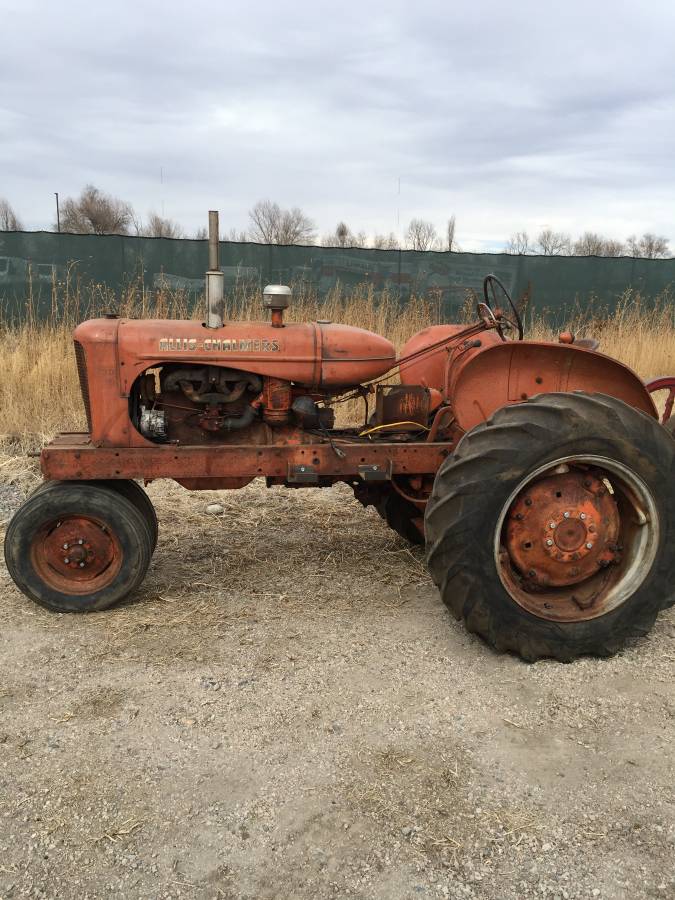

There is this WD45 about three hours away. The guy says it runs well, and it has been in his family since new but knows nothing else about it.
He hasn't given me a price yet.
What is it worth? Seems a restored one is not very expensive, so it might be worth going that route considering an engine and tranny rebuild could be a few thousand, right?

Reading your posts, I would personally look for an early WD (52 or earlier to get in your local 39-52 class). Look for an inexpensive tractor that you plan to rebuild the engine.
After you get the engine, look for a WD-45, 4.5" stroke crankshaft (a D-17, 170 or 175 crank will need a different gear for the oil pump). If you are lucky enough to find a set of 8.25/1 compression pistons from a 175, buy them ($$$). If not, get a set of 4.125 (bore) 7.25 pistons and a governor spring from a D-17. Have a cam ground as close to 175 specs as possible. If your very handy, a little head porting and carb work and you have an engine that will run all day on pump gas and will be very competitive in the "stock" class.
On the tractor, drop the hydraulic cylinders, rock shaft and rear platform. It will give you a great place for weight racks. Remove the belt pulley and replace it with a plug If you are planning to try to get into the 3500 lb. class, a narrow front end from a WC is a little lighter than the WD front end.
Good luck!!! (... and it isn't as inexpensive as you might think!!!)
