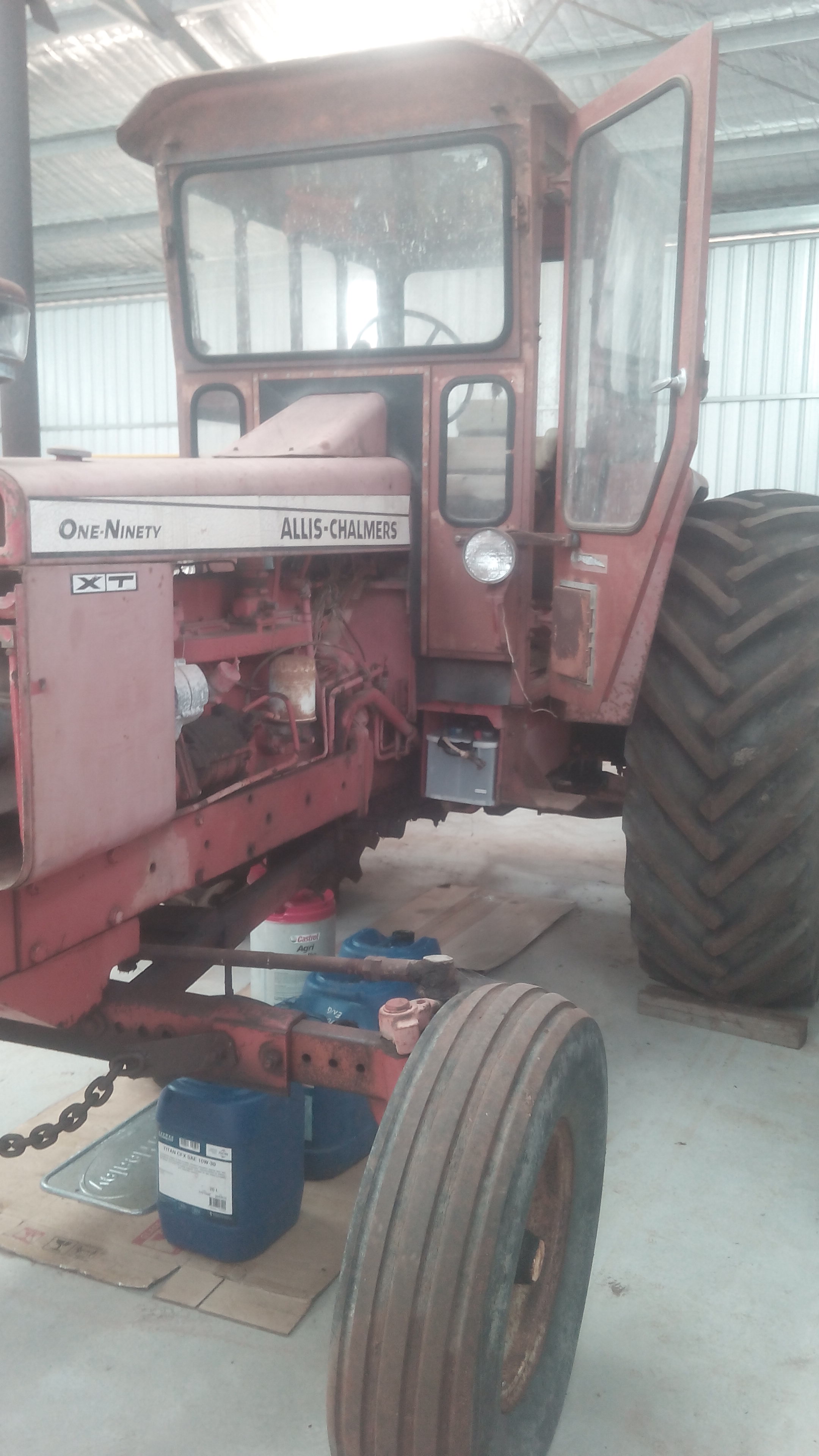

About to getting stuck into changing all the fluids & filters on this XT190 I bought earlier in the year. Has not been running for 20 odd years. Has been shedded so that is a start.
Does anyone know of any obscurities to look out for after they have been sitting this long I need to check before we start or drive it?

If it has not been touched in 20 years, I would drain the entire fuel system including the pump, flush out the tank and refill with fresh fuel.  Also prime the pump and lines.
Make sure the engine is not stuck, check the oil, see if there is coolant in the radiator.
Once all those check out, then I would try cranking it.  If it starts, let it run for a few minutes, then shut it down and drain the engine oil.  If it doesn't start or doesn't run well, the injector pump might be due for a rebuild.
Nice looking tractor.  Even has the traction booster drawbar!

I recently picked up one that sat for a long time (appx 15 yrs) also.  I did all the above, started with ease (and a shot of starting fluid)(and 2 new batteries...LOL).  One thing I found when I pulled out the air filter was a mouse had made a huge nest in it.  Sure glad I changed it before starting it up... could have been bad sucking all that stuff up.  I also changed out all fluids and new filters.  She also had a rough idle, found 2 of the injectors loose as well as some of the exhaust manifold bolts loose.  Those tightened, she ran surprisingly smooth.  I've run it some now, finding lots of leaks that need addressed, changed out some hyd. hoses yesterday.  On my first run with her she blew the front seals out of the water pump, that was fun miles from no-where.... good thing there was a lake nearby.  I need to pull out the pressure washer for a good cleaning so I can pinpoint some leaks under her.  Always something to do with these old gals, sure glad I enjoy working on them.  Wiring is a mess, might get to it before freeze-up.
Good luck with yours, enjoy!

also... check the bellhousing/clutch ares for a HUGE 'mouse house' !! My 1st D-14 had a 'mouse apartment' inthere....100% jammed FULL of 25 years worth of seeds,wtigs,leaves, etc.... took me 4 hrs to get rid of it AFTER I'd split the tractor....
ah, teh good old days...
hmm, any snakes live in bellhousings ??? or spiders ??? I hear you got LOTS of them 'down under'.

Id really be concerned about the Powerdirector seals and pto seals after setting that long, but only way is to try it ,
