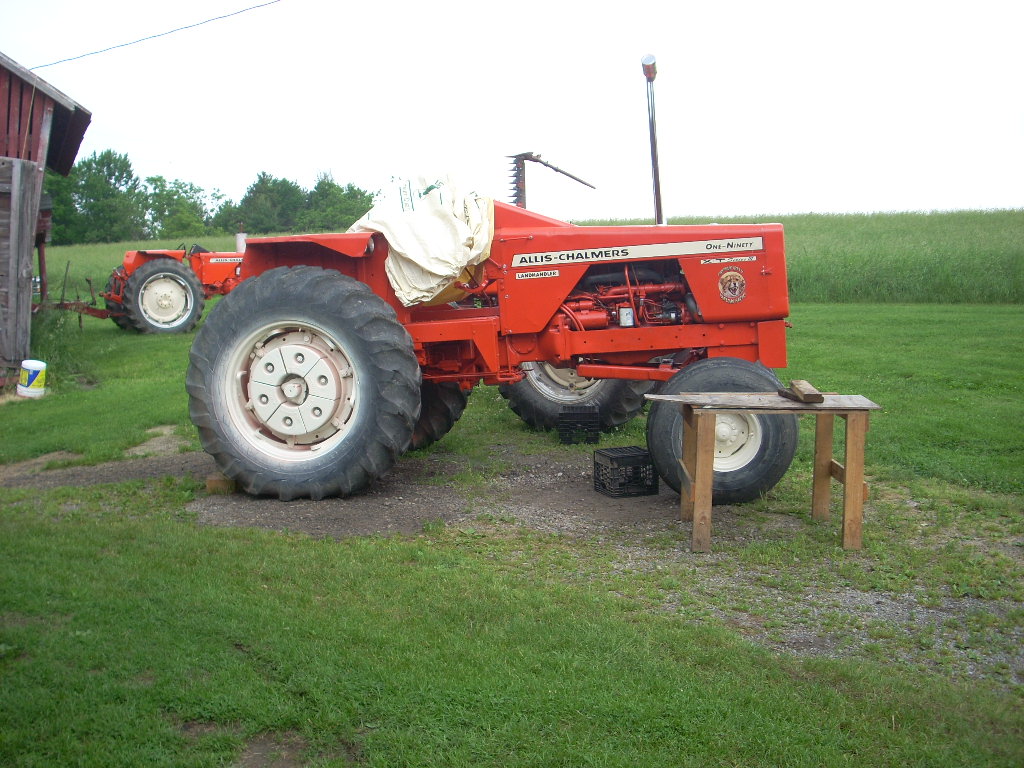

Post Options Post Options   Thanks (0) Thanks(0)   Quote Orange Blood Quote  Post ReplyReply Direct Link To This Post Posted: 30 May 2012 at 6:50pm
I think it is a great looking ride, except your next project might be rear tires of the larger variety, it kinda looks like it's butt is dragging!  :-)
Still in use:

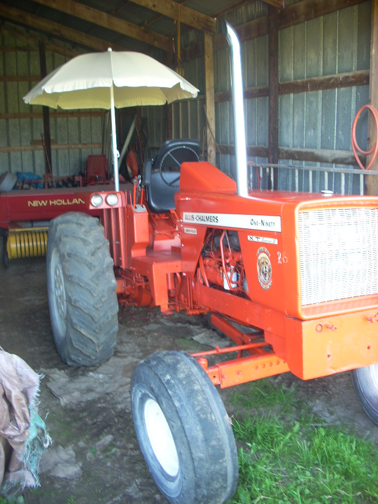

captaindana View Drop Down
Location: Fort Plain, NY
Points: 2609
Post Options Post Options   Thanks (0) Thanks(0)   Quote captaindana Quote  Post ReplyReply Direct Link To This Post Posted: 30 May 2012 at 7:04pm
Wow guys I drove her again and keep reminding myself I have to break her in working on the baler and not puttn' round on joyrides! When I can afford new tires she'll get new 18.4 x 38's and new 1100's for the front to a tune of 4 grand. But for now she'll be squattin' for a spell on the originals. Wow does this thing run awesome! A heartfull of thanks to everyone for their help and patience!

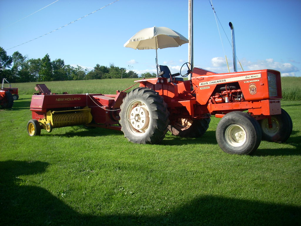

Post Options Post Options   Thanks (0) Thanks(0)   Quote captaindana Quote  Post ReplyReply Direct Link To This Post Posted: 31 May 2012 at 7:50pm
Got Kitty hooked to the baler for the season. Now I need to get another one eventually for an eventually new discbine. I can pretty much guarantee you all I will never buy another non running 27 year dormant Allis that ran good when parked lol!
Points: 2609
Post Options Post Options   Thanks (0) Thanks(0)   Quote captaindana Quote  Post ReplyReply Direct Link To This Post Posted: 31 May 2012 at 8:04pm
Sun protection and new hydraulic couplers added today. New oil press gauge reads 40 to 50 lbs.

Post Options Post Options   Thanks (0) Thanks(0)   Quote captaindana Quote  Post ReplyReply Direct Link To This Post Posted: 31 May 2012 at 8:14pm
Dnoym I think I have around 5 in it. With my labor about triple that lol. I doubt it will ever be for sale while I'm alive. I would really like to just work with her and enjoy the ride for the next 20 years. When I looked back from the D19 the baler looked huge. Now when I look back from the XT the baler looks more like a matchbox toy!
