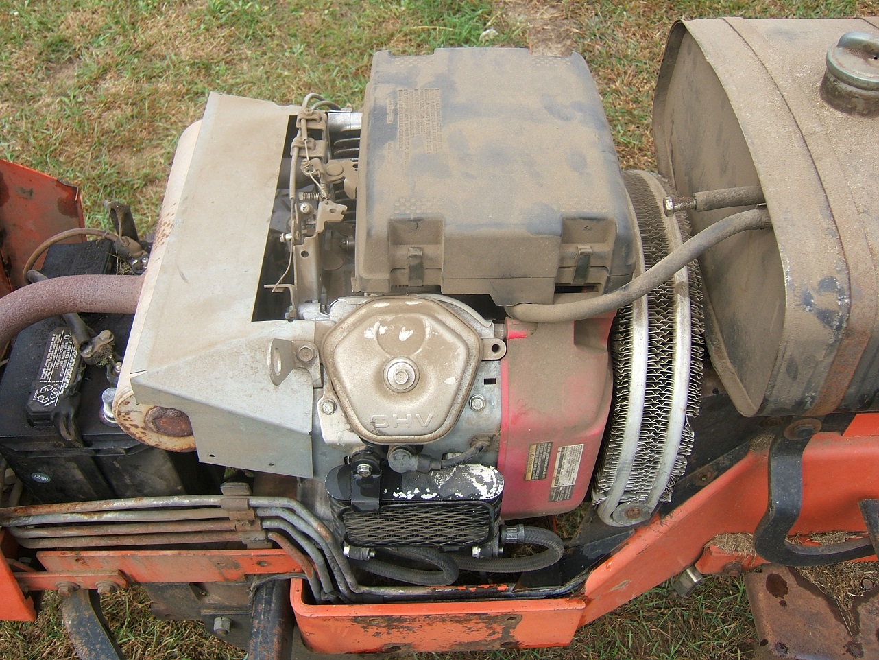

Complete repower 24 hp Honda kit. In tractor now. I am going bigger yet. The engine has new coils, 10 degree timing key, Carb gone through, Valves redone. Runs great. 1000.00 o.b.o. Thanks P.M. with replies

Not sure on the hrs. Cylinders looked great when the heads were off to do the valves. I will get pics later today. Valves were carboned up not burnt. Thanks

Post Options Post Options   Thanks (0) Thanks(0)   Quote fasstman Quote  Post ReplyReply Direct Link To This Post Posted: 17 Sep 2015 at 12:03pm
fasstman View Drop Down
Joined: 07 Aug 2014
Location: Whitehall,WI
Points: 150
Post Options Post Options   Thanks (0) Thanks(0)   Quote fasstman Quote  Post ReplyReply Direct Link To This Post Posted: 17 Sep 2015 at 12:05pm
Joined: 07 Aug 2014
Points: 150
Post Options Post Options   Thanks (0) Thanks(0)   Quote fasstman Quote  Post ReplyReply Direct Link To This Post Posted: 17 Sep 2015 at 12:06pm
It's all dirty from dragging the fresh yard.

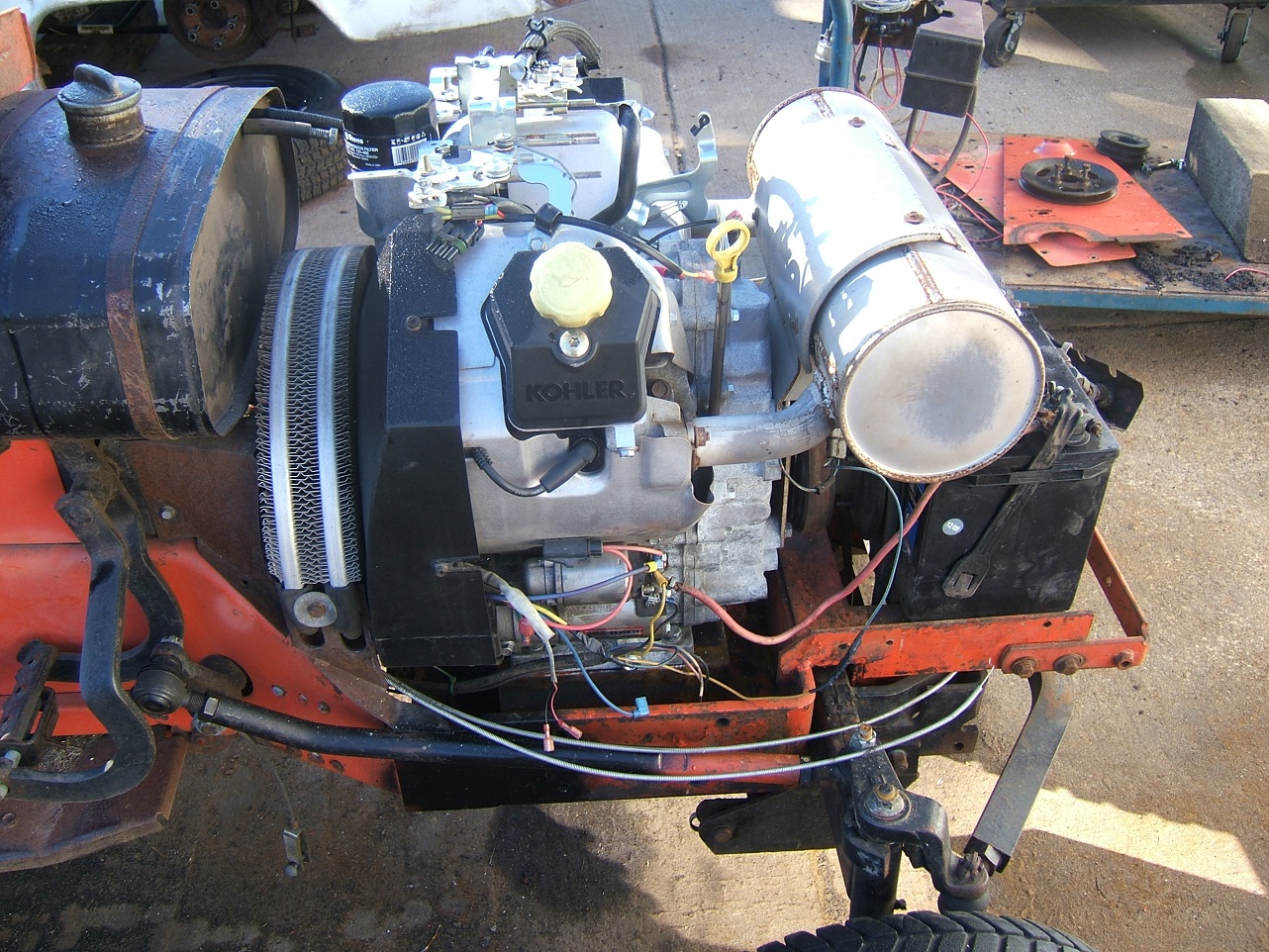

I am between Eau Claire and La Crosse. I put in a Kohler Command Pro 37 HP.

any pictures/details on the kohler install?

Post Options Post Options   Thanks (0) Thanks(0)   Quote fasstman Quote  Post ReplyReply Direct Link To This Post Posted: 30 Sep 2015 at 5:14pm

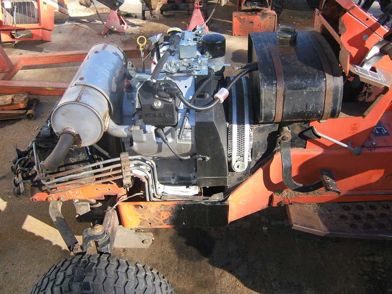

Joined: 07 Aug 2014
Points: 150
Post Options Post Options   Thanks (0) Thanks(0)   Quote fasstman Quote  Post ReplyReply Direct Link To This Post Posted: 30 Sep 2015 at 5:19pm
Still have front clutch and rear pto. Lengthened 3 1/16" and a 1 5/8" spacer between flywheel and pulley. Working on relocating air cleaner. I need another hood if someone has a spare.

I once worked my stock 620 hard enough to have the transmission oil temp light come on. How is it going to handle 17 more horsepower. What is driving the quest for more power? With a handle like Fasstman, is
it the more speed, more power philosophy?
The air cleaner looks like a tight fit. Is that why you need a new hood, will it have to be reworked? We had some pictures posted here showing extended 720 (3cyl diesels). They must of had to make new hoods. Perhaps contact that poster for hood info, maybe they have a sheet metal wizard contact.
How is the vibration and smoothness and sound of these v-twins compared to the opposed Onan? Looks like you can get to the started with out pulling the engine, yeah.

Post Options Post Options   Thanks (0) Thanks(0)   Quote fasstman Quote  Post ReplyReply Direct Link To This Post Posted: 30 Sep 2015 at 6:42pm
I just like power and because I can do it. The engine is smoother and more quiet than the onan. I am relocating the air cleaner for space.
Joined: 07 Aug 2014
Points: 150
Post Options Post Options   Thanks (0) Thanks(0)   Quote fasstman Quote  Post ReplyReply Direct Link To This Post Posted: 30 Sep 2015 at 6:44pm
My hood got hot but never blistered the paint. I want to run a lower profile battery and put another heat shield by it to keep more heat off of it.

Post Options Post Options   Thanks (0) Thanks(0)   Quote BrianC Quote  Post ReplyReply Direct Link To This Post Posted: 30 Sep 2015 at 7:13pm
Mine has a vertical muffler, not under the hood. I think that helps the
heat issue. The exhaust pipes are not wrapped with insulation.
But now I have to watch for tree branches.

OH YEAH!  Now yer' talkin' !  Looks great Trev!  Tight but fits. How's it go?
Joined: 07 Aug 2014
Points: 150
Post Options Post Options   Thanks (0) Thanks(0)   Quote fasstman Quote  Post ReplyReply Direct Link To This Post Posted: 01 Oct 2015 at 7:27pm
Goes fine. You can just idle up hill with hydro in full forward in third gear and engine hardly even knows it. Just about have the mower deck mods done. Have the air cleaner relocated. Still looking for a hood.

thats a good price for your honda ,   how much did you have to strech the frame , will you have to widen the hood to fit the valve covers
Joined: 07 Aug 2014
Points: 150
Post Options Post Options   Thanks (0) Thanks(0)   Quote fasstman Quote  Post ReplyReply Direct Link To This Post Posted: 02 Oct 2015 at 1:20pm
3 1/16" stretch and I will have to lengthen and widen the hood. I am tring to get stuff low enough so I don't raise the hood.

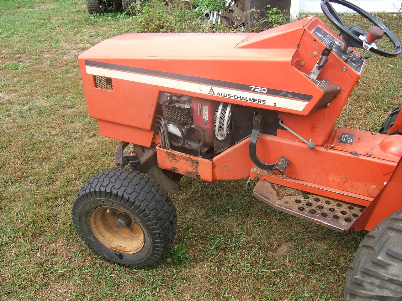

I just painted my hood, and man, let me tell ya, those hoods are looong!  LOL!  Adding another 3+ inches is gonna make it look like a Funny Car body.  LOL!

Can someone explain how you go about extending and widening the hood?
Points: 12070
Post Options Post Options   Thanks (0) Thanks(0)   Quote Steve in NJ Quote  Post ReplyReply Direct Link To This Post Posted: 05 Oct 2015 at 8:33am
Hang tight Brian, I got a feelin' Trev is gonna show ya with a couple pics. LOL!
Joined: 07 Aug 2014
Points: 150
Post Options Post Options   Thanks (0) Thanks(0)   Quote fasstman Quote  Post ReplyReply Direct Link To This Post Posted: 05 Oct 2015 at 12:38pm
I am not there yet. Still looking for a extra hood. I might have found one. I am still tring to shave the height down so I don't have to raise the hood. The hydraulic lines should be done today. Then it will be the hood. I mowed with it a couple days ago.
