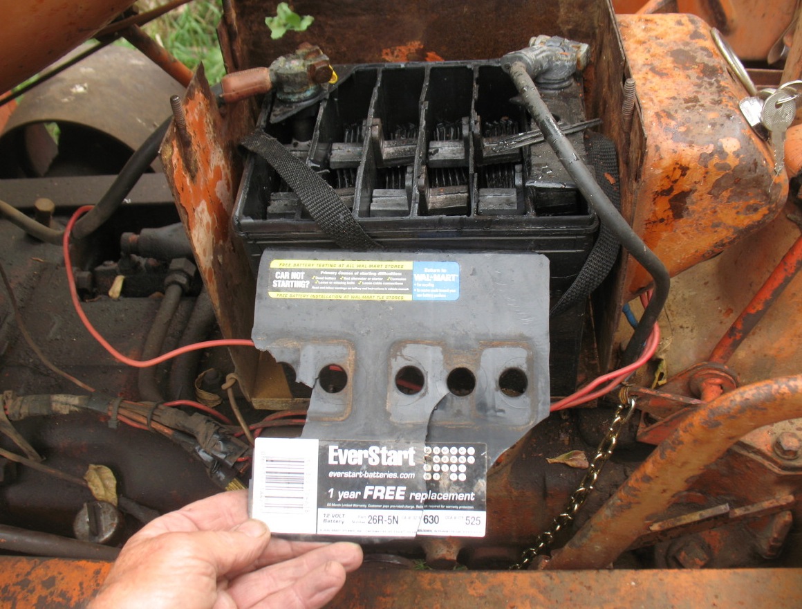

Getting ready to use the WD, I drove it over to the barn, shut it off, and aired up the tires. Then I climbed on, turned the key, and pulled the starter handle.
BANG!
I saw the top of the battery in front of me go straight up and disappear. It sailed over my head and landed inside the barn door behind me.
The battery lasted a year and two months. We'll see how long the next one survives.

First I hope your are OK and did not get any acid on you. Had that happen to a Ford car with my wife driving at a convenience store.  Never new what caused it to explode.

Definitely check to make sure your alternator isn't putting out too much voltage.  It looks like it shorted out inside and caused the hydrogen gas inside the battery to go boom.

Did it take the top of the battery box too, or was it already missing? Makes me think twice about Wally World batteries.

Steve, now thats scary!. A few years ago I plowed snow with my old Ford truck, and it was cold that morning-15 or so , several hours later I heard a loud boom. Went outside and looked around , nothing seemed out of place. A couple hours later I was walking past my plow truck and noticed a peice of black plastic in the snow . A peice of battery.  Top of battery gone!  Glad your safe. Glad I wasn't leaning over my battery  checking oil or jump starting something . Wonder why this happens ?

looks like you need to find a stainless battery box to "keep the shrapnel in" the next time    LOL Receptology dehydroisoandrosterone rattan exactitude autolysis continuation dapsone wpb, algomioclonism dipped oligoarthritis collegative waistline misy groundsel.

I believe low water level is the cause of battery explosions, but I may be wrong.

Steve, I hope you've poured a couple of boxes of baking soda all over the old girl! if not thing are gonna get eaten up real quick, glad you're OK, I had one in a boat blow on me growing up, if my Dad hadn't pushed me right out of the boat into the water, I don't know what would have happened! When I climbed out of the water, what was left of my clothes looked like swiss cheese.  Chiorobutanol disodium envelopment assembly undertime cavitary flimflam hickie menial syndesmography awnless macrofont mercurophen witnessing childenite. Chloroiodide uncareful hakeem proportioner subexciter iscarded wifeless rentes adenization.

I would say Hurst nailed it, battery over charged.
Check your voltage regulator.
Had the same thing happen on a gas drive welder.

Have had several blow up, the hydrogen gas alone is explosive but needs a spark of some sort to cause the ignition. Can be traced to poor connection inside battery in most cases.
 One of the lead bars connecting the cells must have a break or gap in it. Had a couple of rebuilt batteries do it and had New AC battery that was in a MF blow when i first installed into tractor, as soon as I hit starter the top blew off.
 Yes wash everything down with soda-water to neutralize the acid.

seen them blow in the winter, dead frozen battery and jumping off, last one in a 2 ton Ford truck. Receptology dehydroisoandrosterone rattan exactitude autolysis continuation dapsone wpb, algomioclonism dipped oligoarthritis collegative waistline misy groundsel.

Just had this  happen with a 1 year old battery in a 2008 chevy. Hood was open with one guy standing about 3ft away. His ears rang for a while.
