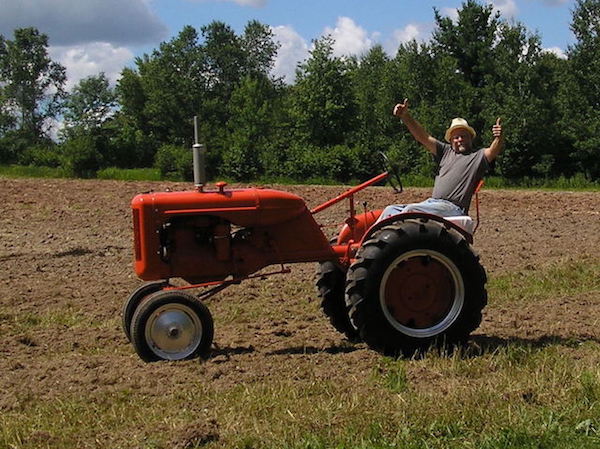

Awhile back I post about an FFA B Tractor that was abandoned when one director retired and another took over. I called it the Mystery B because no one could or would tell me much about it. It was a non runner but had new tires and rims and a suspect paint job. I had to rebuild the head(Thanks Lon(MN) for most of the parts) and the carb. Every time I took something off there was either no gasket or parts missing. Some trouble with the mag. But after replacing the muffler, air cleaner, and the drawbar I could not get it to start by hand cranking. Thought it was not pulling gas into cylinders because of maybe low compression. Any way short story I took it to the cabin out of frustration and hooked it behind the C. Pulled it 5ft and it started. No smoke, no timing adjustment or carb adjustment. I have oil in the filter but no pressure reading at the gauge. Not sure if the gauge is good. I will pull the valve cover to make sure I have oil coming. Bad part is the radiator leaks. Oh well. I really don't care it I have to pull start it right now as it runs. One happy old guy!
