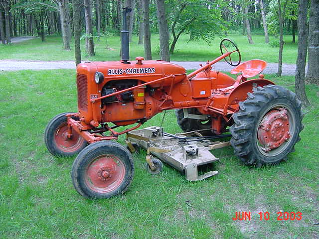

Don't have an RM59, but have run a L59 under the belly of my CA for years.  It does a smooth job.  End up buying a belt every year.  Mow about 5 acres of lawn(?) and right-of-way with it.

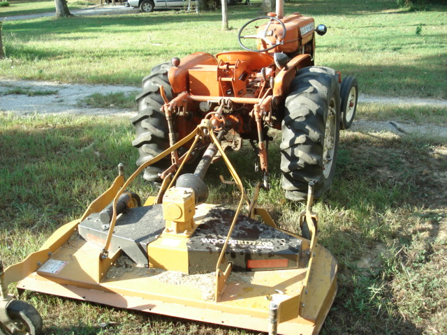

Murph, I have not had any PTO issues being to high and have not needed to shorten any Pto shafts to make them fit. I made my own version of a 3pt lift for my CA and use it for rototilling & finish mower which are both Maschio brand.

DeWayne, please post some pictures of your made up hitch on your CA with either the tiller or mower.

DeWayne That is one VERY SHARP CA !!!!

Dewayne, very nice! but you might want to add some weight to that tractor. LOL. How does it steer?
Tom, your wide front looks really sharp with that L59.

Dale, I have a photo of my 1st 3 point version, but having trouble coming up with the 2nd version photo! I made the 2nd version by using a snap coupler from a plow and had swival ends welded on for the lower section.
Ca Ron, It steers good if you are rolling along, but you need a strong arm or 2 if you are not moving!
DeWayne

Thanks for all the info guys, and great photos DeWayne.  On a related note, what size tires are most common on CAs?  Mine are 12.4 x 24.
