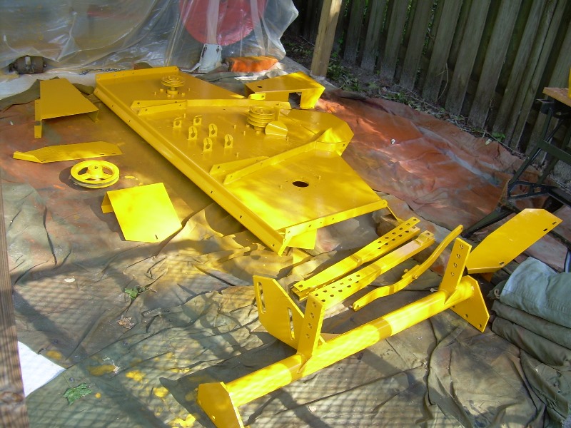

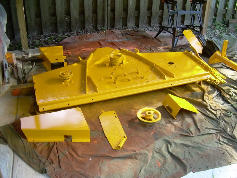

I recently got a nice L306 for my single front wheel C.  The deck was in pretty good shape.  I had all the parts sandblasted and primed.  I painted it today with the correct Woods center line yellow.  The pics show more yellow than orange, so they are not quite accurate on the computer.  One of the spindles was toast, so I bought a replacement.  I also got new toe guards, blades, decals and skids. I really like these mowers.

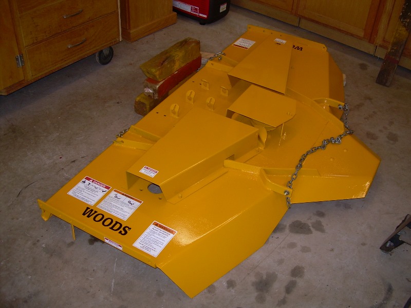

Still waiting on a few parts, but got the decals on today.  I couldn't find "L306."  The decal set only came with "Woods."

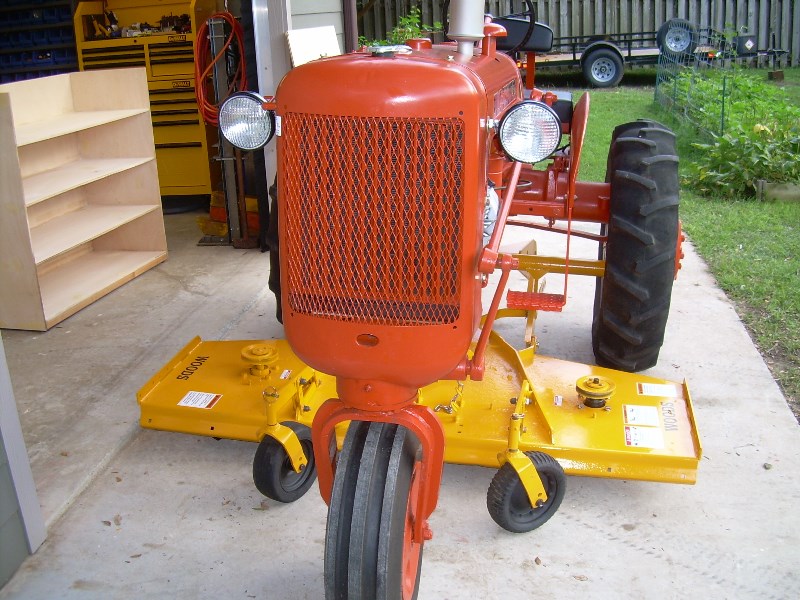

I see the left side plate appears to be missing. Is this a part that your waiting on? They work Well as a rear discharge mower. Nice looking job. Make sure you keep the main drive belt very tight to prevent premature wear and breakage. They are not cheap as you probably already know. The correct twist and setup will drive you crazy, but after that they mow very well. Dad has had his for 12 years under his CA. I can take a picture of the L306 decal and measurements if you want to have them duplicated.

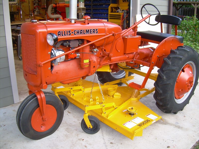

Got the holes repaired on the final drives.  That was not easy.  I hate doing that kind of repair.  I got the mower mounted and I think it looks good.  Tomorrow I'll get the belt on and the guards, etc.  I'm still waiting for one more part from Messick's to install one of the blades.
