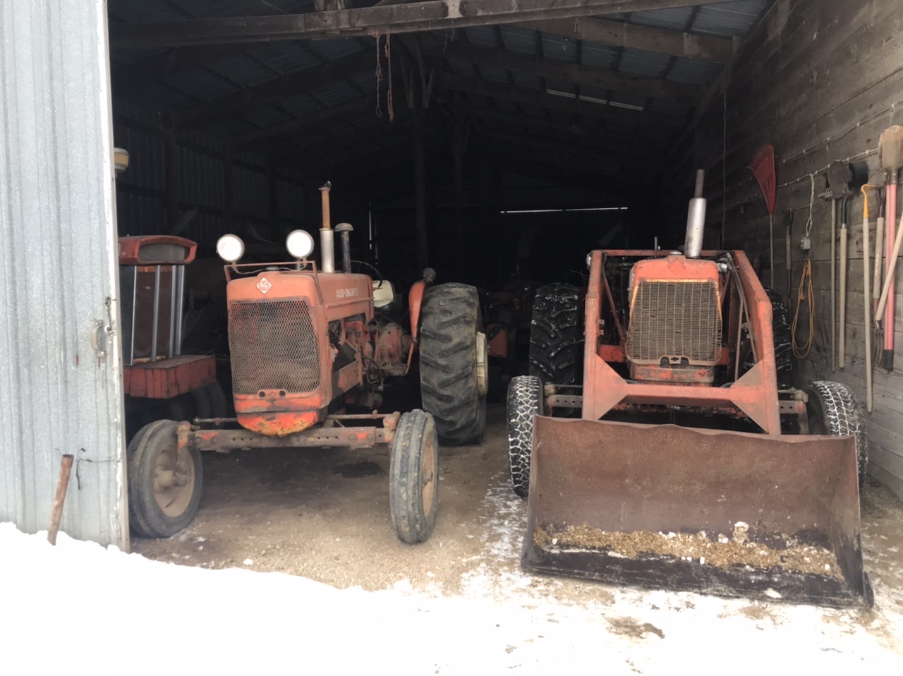

It can be 20 below out and the D-17 (gas) will fire up. I got a 200 that needs either to start at 70!

Post Options Post Options   Thanks (0) Thanks(0)   Quote CTuckerNWIL Quote  Post ReplyReply Direct Link To This Post Posted: 01 Feb 2022 at 5:12pm
Originally posted by DougG DougG wrote:
Post said 200 needed either - not D21
 There is a D21 with it's nose just showing in the picture.
