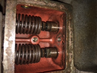

I have a Wisconsin AEN 101962 engine. It was running a few years ago. I went to start it last week and it will not turn more than a 1/4 turn. It seems to be binding or hitting something.  The shroud is not dented at all.  I took the head off. The valves do move with the help of a screw driver. I also took the breather off and I can see the valve springs move.  The rods actually turn when I turn the engine a little, don't know if they actually go up or down.  If I apply a lot of pressure on the rope pulley, I can get the engine to turn completely but it takes a lot of muscle to get it to turn. What else could it be?

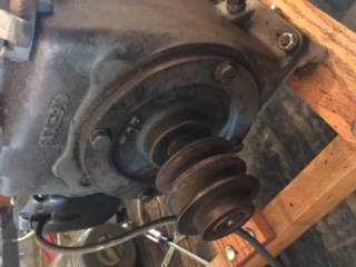

If I drain the oil and take the four bolts holding the plate behind the double drive pulleys (1st photo below), would I be able to see what might be holding it up? Or would it be better to take the 12 bolts from the bottom and remove bottom?  Could it be a bearing? Could the mag be binding something in the front of the engine behind the shroud.

you may need to lube everything up good an even the cyl's. work it some tell it frees up some. if the valves are free' got gas an spark should run?

Mouse nest in the blower housing? I have a fairly large collection of Wisconsin engines and usually when they won't turn a full turn it's a stuck exhaust valve. Sounds like you had them moving with the help of a screwdriver though. I can't believe the mag is preventing it from turning since the gears are fully enclosed. Those starter sheaves can be a challenge to get loose.
