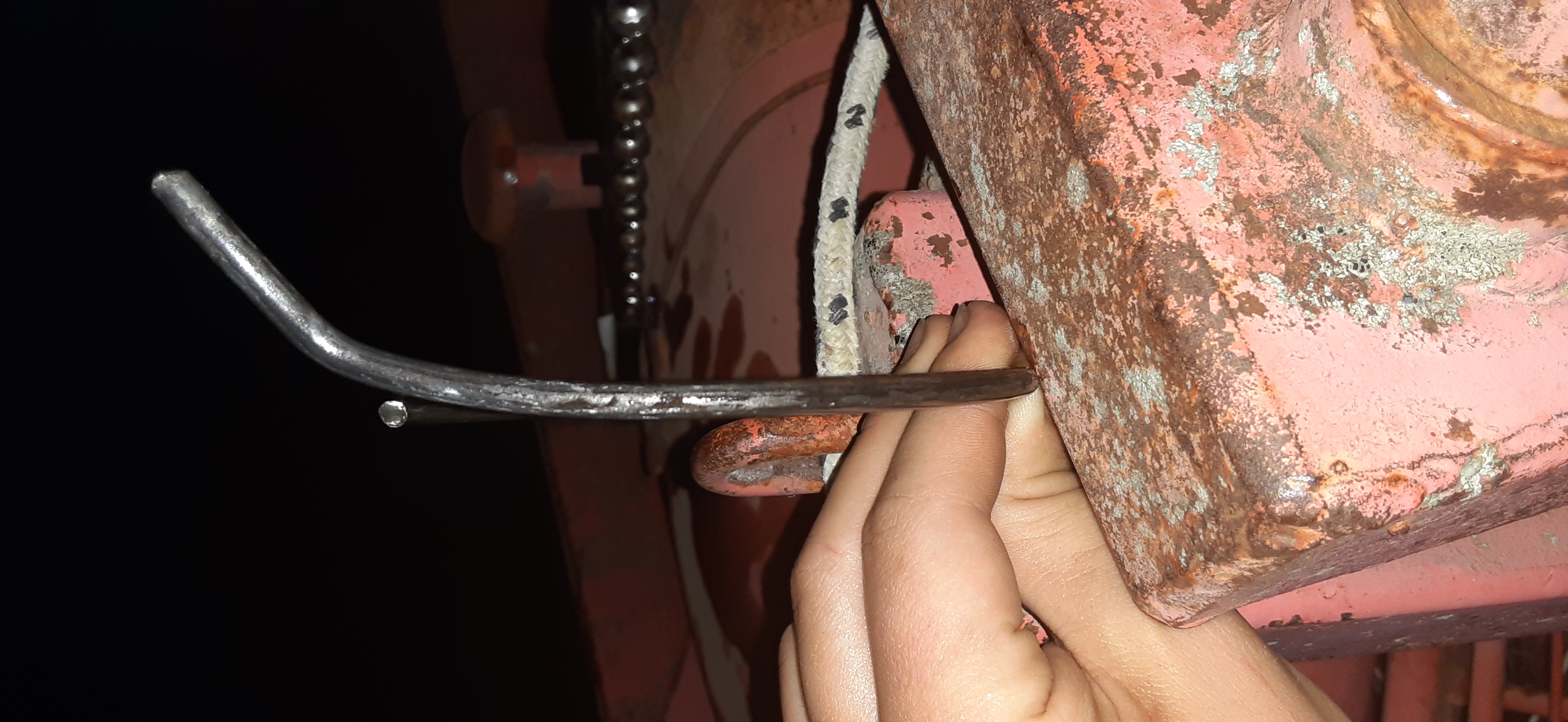

We tried the things you said to and tried to pull it and 3 rd gear popped and now I have no 3rd gear I found this under the battery
Anyone know what this is will this be hard to fix

Good to see you are still working on it, too bad new things show up.  It sounds like you have at least seen a bit of life from it.
Which oil looks like chocolate milk?  Engine, hydraulic, transmission/differential?  Has it been setting undercover or outside all the time?  Exhaust stack covered?
Did you ever get #1 cylinder up on compression and see exactly where the rotor is pointing?
You may need to remove the valve rocker cover and see if you have a stuck valve after setting for 14 years.  You can check and adjust the valves while it is off and confirm when #1 is TDC compression to check static timing.
I don't remember.  Do you have Operator's and service manuals for your tractor?   If you don't you can find some WD manuals you can download at this site: https://archive.org/details/collection_01_allis_chalmers_manuals
You can scroll down the list of manuals and pick the ones you want.  The service manual there is I&T not AC, but better than none if you don't have the manuals.
