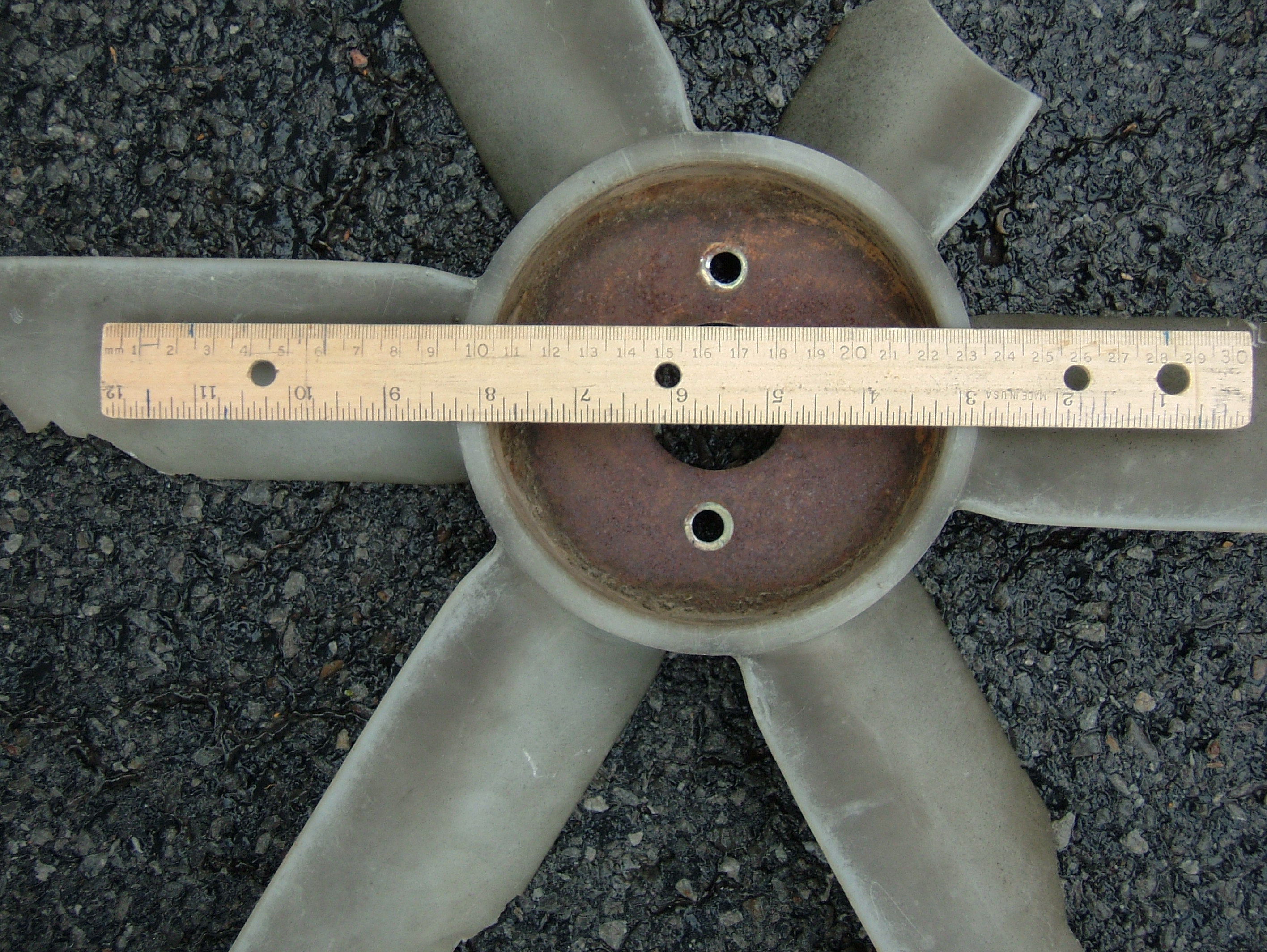

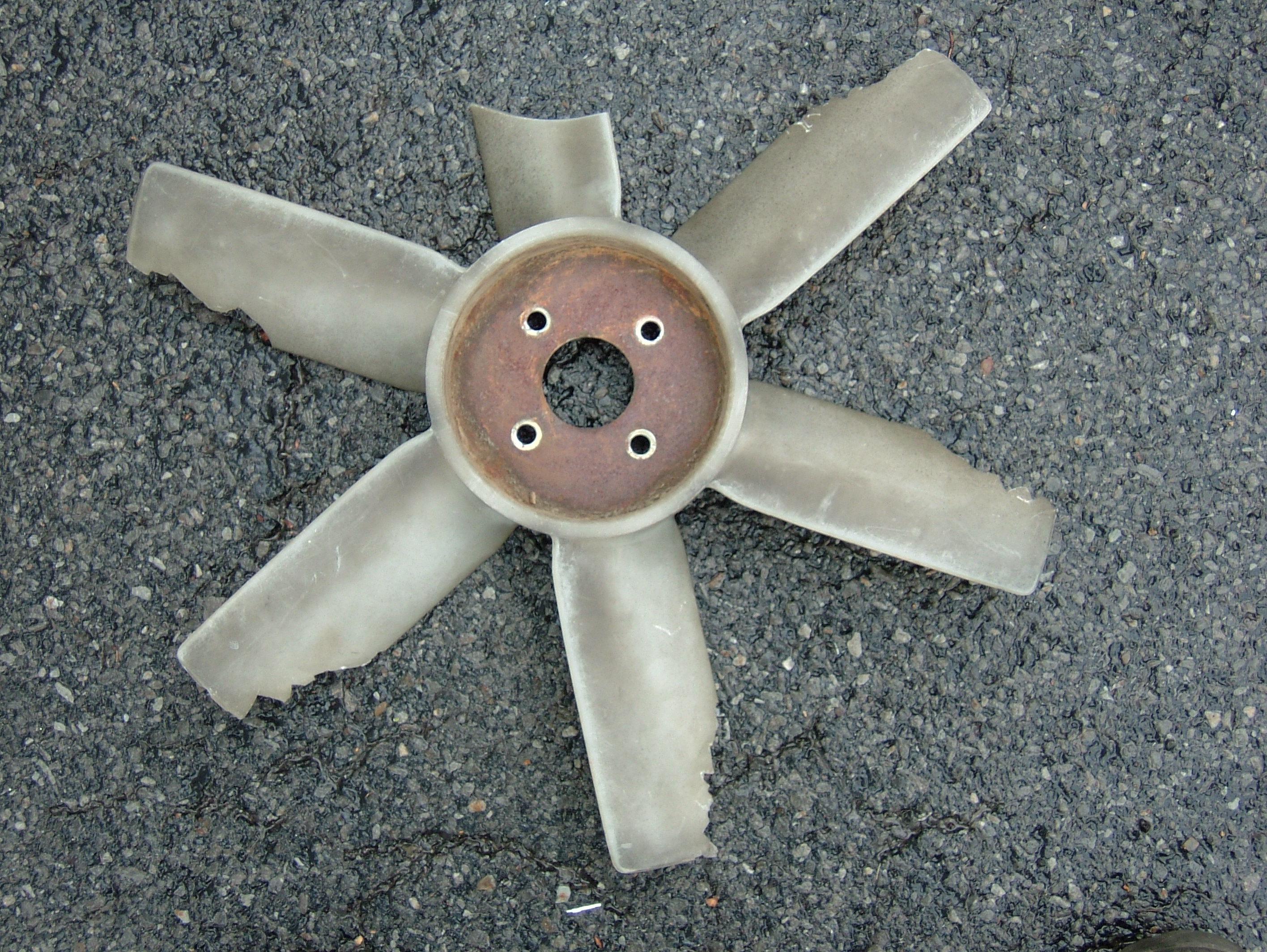

Well, the search for a replacement cooling fan for my 6140 has been a nightmare and I'm ready to call it quits. No used ones. NO aftermarket ones. Definitely no NEW ones. Trying to match it with other fans from sellers online (one particular eBay seller is horrible) has been even worse; some measure bolt hole spacing diagonally, others measure to the adjacent (@90*) hole... I need a pusher blade, no more than 17" diameter, 4 mounting holes 5/16" diameter (8mm to accept an M6 bolt), bolt spacing 2" to adjacent mounting hole.
I have to go to the local U-Pull to see if a fan from a Ford Ranger with the 2.3L engine will work - I've been told that the bolt spacing may be tight but it's worth a shot.
Otherwise, it's been suggested that I go with an electric fan, but I'm not sure how best to wire it. I am thinking of going with a switch, but I'd appreciate all suggestions. AND if you have any leads on what fan blade will match this tractor!
Here's a pic or two:
Thanks in advance.

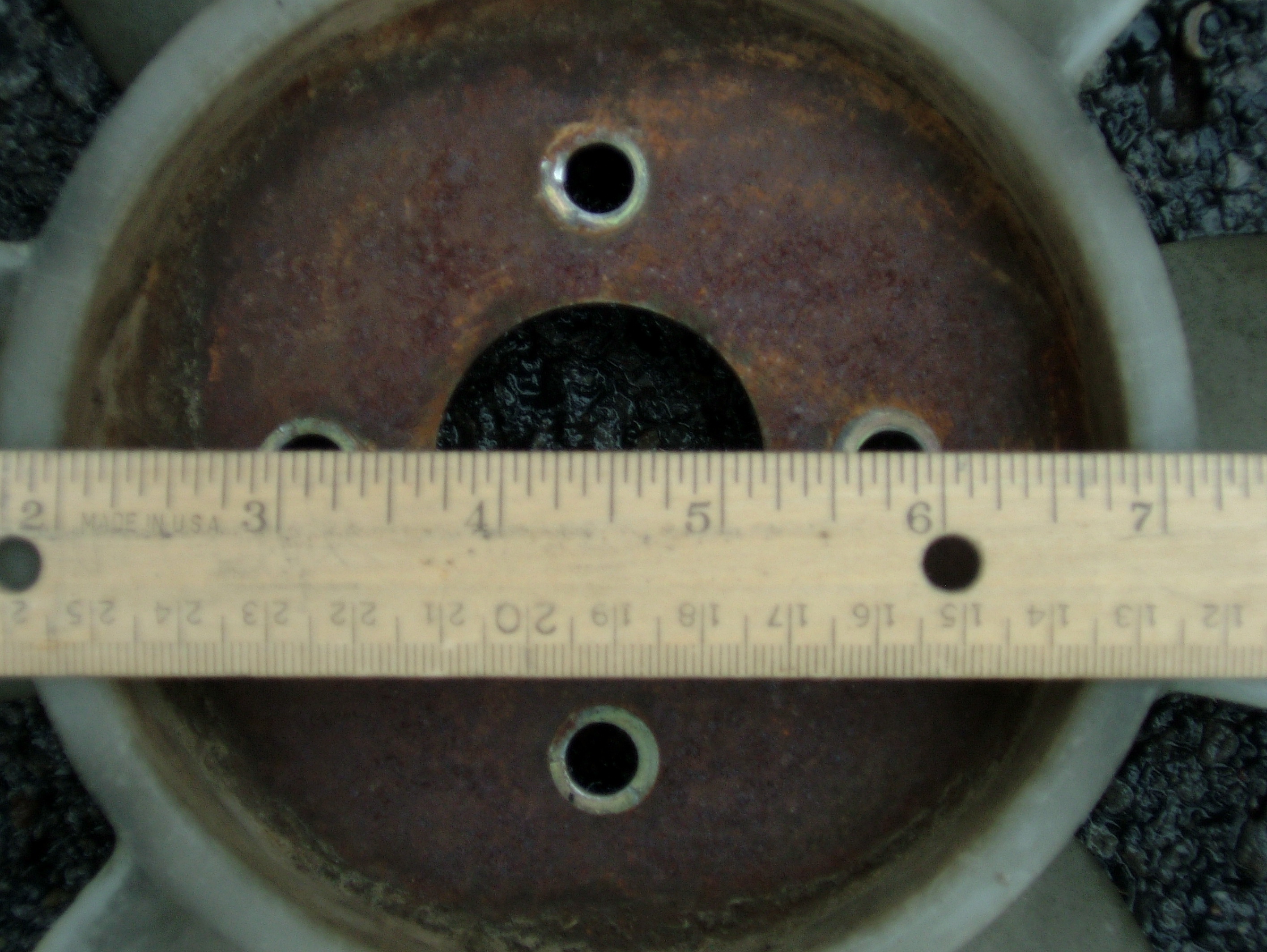

Fan centers like this are generally spec'd by pilot diameter, bolt hole circle diameter (diagonal in your case with only 4 bolts), and bolt hole diameter.  Looks like an old Kysair fan.  They went Tango Uniform a while ago, but American Cooling Systems was formed by I think some of the old employees, making a similar fan.
From your pictures, it looks like your bolt circle diameter is about 2 5/8" and the pilot diameter is 1 1/2".  I dug up an ACS drawing of a model 482XXX fan and it looks like they have a version that is close but not quite the same as yours - 1.614" pilot and 2.5" bolt circle, 0.343" bolt holes - this may be the same as what you have, I can't tell for sure from the pics.  Gerald is correct, the center pilot centers the fan, the bolts just hold it on.
You would also need to have the projected width (front to back of the blades looking from the side), blade width, and blade angle to make sure you are getting a similar performance fan.  In your area, Cummins Northeast, Penn Detroit Diesel, D&W Diesel are all ACS dealers.

I've been looking all over. The used 6140's at tractorhouse have no fans. The actual diagonal/bolt circle is 2-27/32" (~72mm), the pilot hole is 1-9/16" (~40mm) and does nothing; the face of the spacer it bolts to is perfectly flat. The rear is recessed 18mm or ~ 11/16". The ruler shown is on the face, which is proud of the mounting disc by about 3/4" so it's not a good way to interpolate the measurement of the bolt pattern or the pilot hole. The overall blade diameter is 16-15/16" or call it 17".
