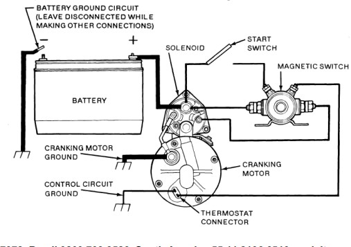

Points: 90804
Post Options Post Options   Thanks (0) Thanks(0)   Quote steve(ill) Quote  Post ReplyReply Direct Link To This Post Posted: 20 Dec 2024 at 8:49pm
you might be able to trace a couple wires... should look somethink like this.. you may not have the thermostat connector
https://www.delcoremy.com/documents/starter-instruction-sheets/over-crank-protection-installation-42mt.aspx

Johnwilson_osf View Drop Down
Joined: 29 Jul 2012
Location: Mount Bethel PA
Points: 944
Post Options Post Options   Thanks (0) Thanks(0)   Quote Johnwilson_osf Quote  Post ReplyReply Direct Link To This Post Posted: 20 Dec 2024 at 9:58pm
Jay,
Yes, that is what the starter looks like.  Steve, yes, similar diagram.
When I took the starter out, it had 3 wires on each post.  The + at the solenoid had the Battery Pos cable, plus two smaller wires, and the ground post on the starter had a battery negative, and two smaller wires.
The ignition wire was on the small post on the solenoid, and then the other small post of the solenoid had a wire going to the large ground post on the starter body.

Points: 90804
Post Options Post Options   Thanks (0) Thanks(0)   Quote steve(ill) Quote  Post ReplyReply Direct Link To This Post Posted: 20 Dec 2024 at 10:08pm
looking at the wire diagram... and your description... It sounds like everything is connected correctly... and you might have an EXTRA ground wire ... which is OK.

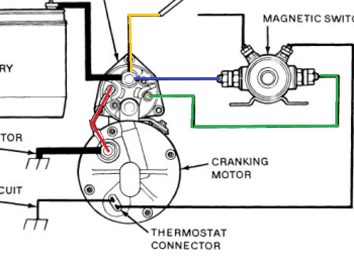

Points: 90804
Post Options Post Options   Thanks (0) Thanks(0)   Quote steve(ill) Quote  Post ReplyReply Direct Link To This Post Posted: 20 Dec 2024 at 10:19pm
When I took the starter out, it had 3 wires on each post.  The + at the solenoid had the Battery Pos cable, plus two smaller wires,( yes, the yellow and purple with battery cable) and the ground post on the starter had a battery negative, and two smaller wires.  ( yes, the GROUND cable and the red plus an extra --- if you dont have the thermostat switch, then the bLACK wire from the magnetic switch MIGHT be connected to the BIG GROUND terminal on the starter.)
The ignition wire was on the small post on the solenoid,( the green)  and then the other small post of the solenoid had a wire going to the large ground post on the starter body. ( yes, the red)
Edited by steve(ill) - 20 Dec 2024 at 10:21pm

Post Options Post Options   Thanks (0) Thanks(0)   Quote jaybmiller Quote  Post ReplyReply Direct Link To This Post Posted: 21 Dec 2024 at 6:49am
Love Steve's diagram ! The magnetic switches 'ground' stud goes to that 'themostat' in the starter then to ground. That way when the starter overheats,it opens the path and you HAVE to wait until the starter cools down before trying again.
The extra 2 wires on both +ve and -ve posts sound like someone at sometime added 'stuff' and this was an easy place to get 24/7 battery power.
Joined: 29 Jul 2012
Points: 944
Post Options Post Options   Thanks (0) Thanks(0)   Quote Johnwilson_osf Quote  Post ReplyReply Direct Link To This Post Posted: 25 Dec 2024 at 3:54pm
Steve's Diagram did the trick.  Once I saw that, I was able to pair the two hot wires to the two ground wires, so I know what belongs to what circuit now.  I was just not used to any of my tractors having the extra ground stud on the starter.
